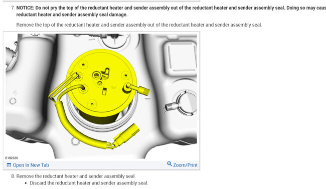

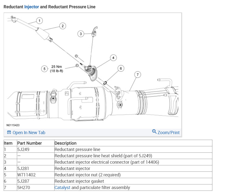

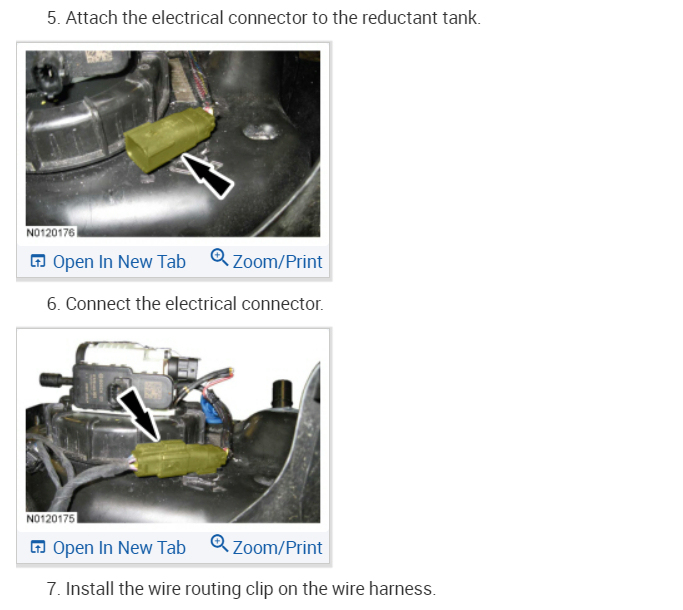

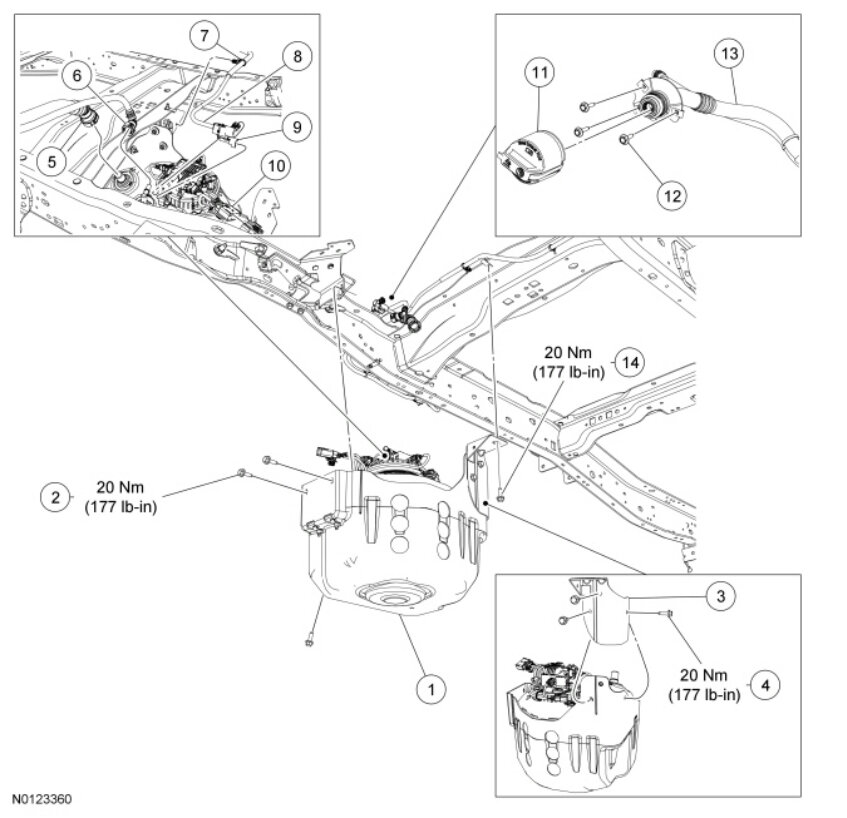

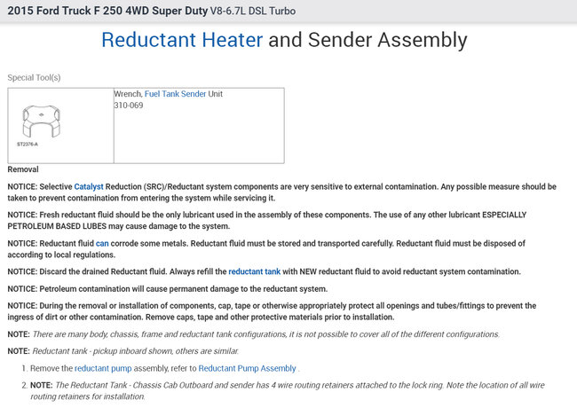

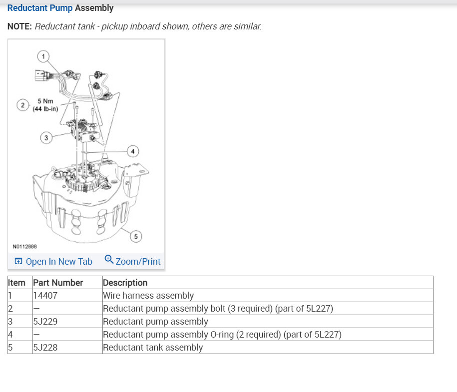

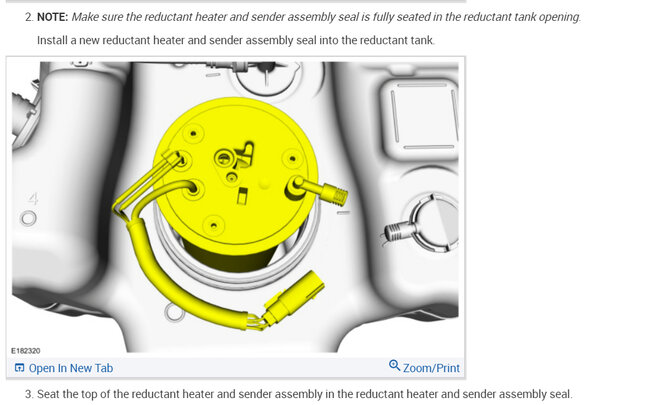

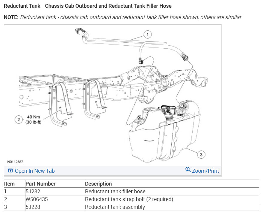

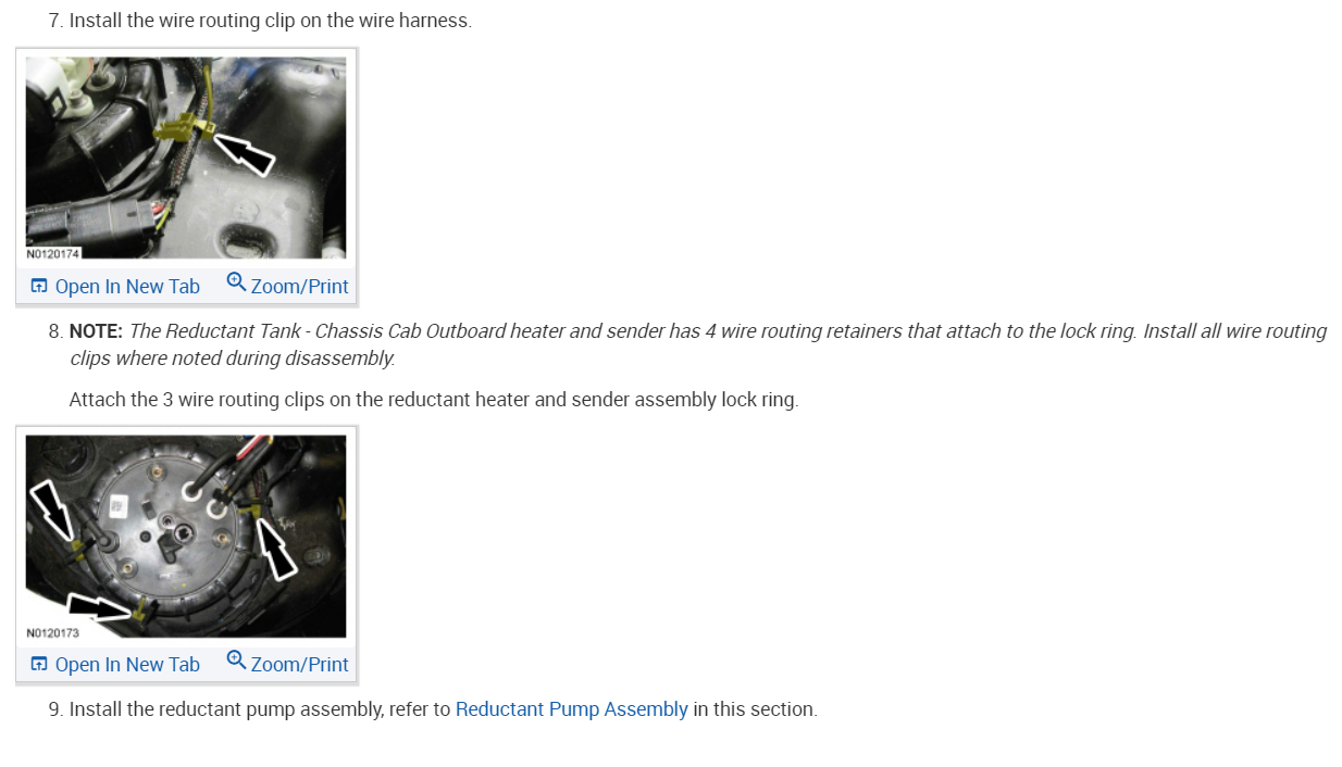

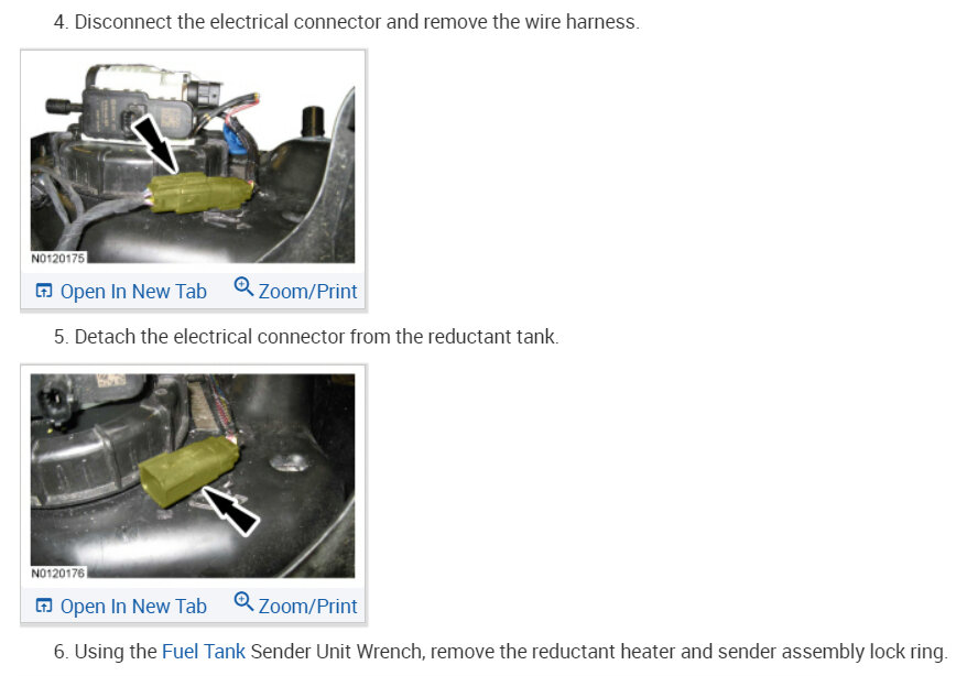

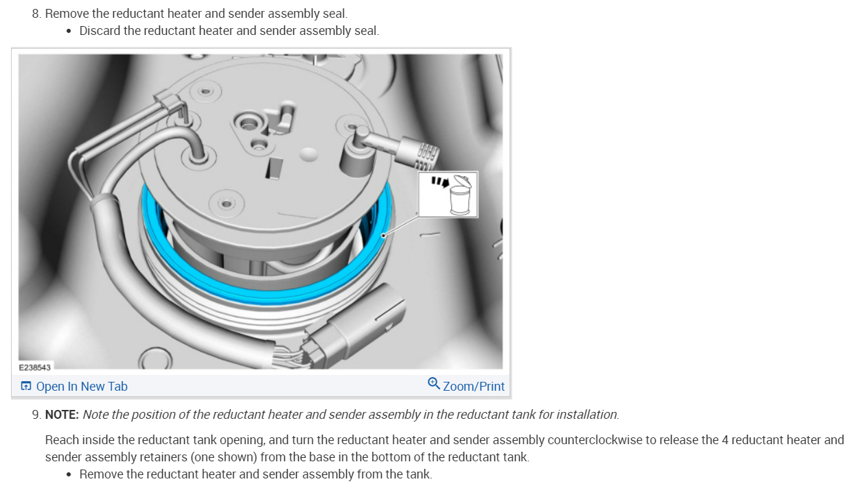

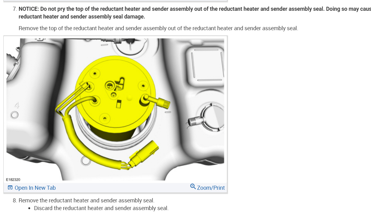

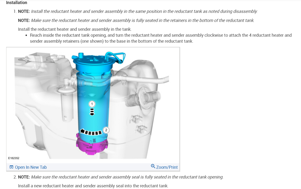

Diesel Exhaust Fluid heater and module replaced and filled up with new Diesel Exhaust Fluid. No codes showing but miles to empty display will not go away or reset.
Jul 24, 2023 at 4:48 AM
  • 55,423 POSTS

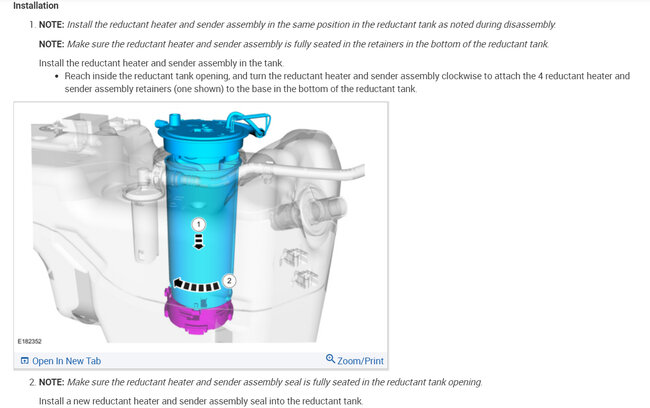

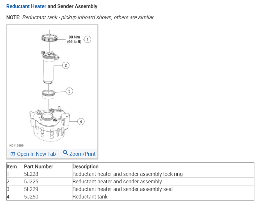

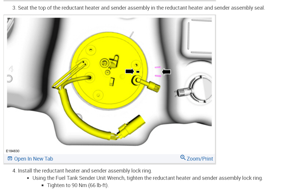

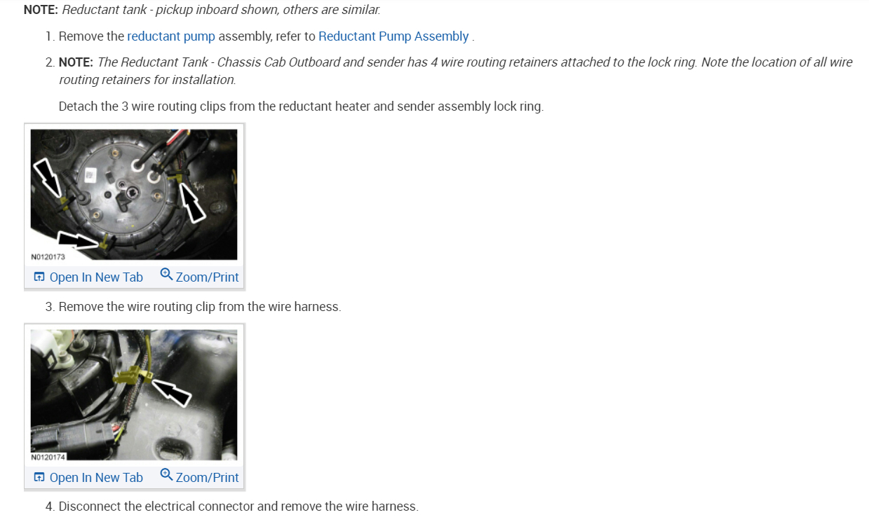

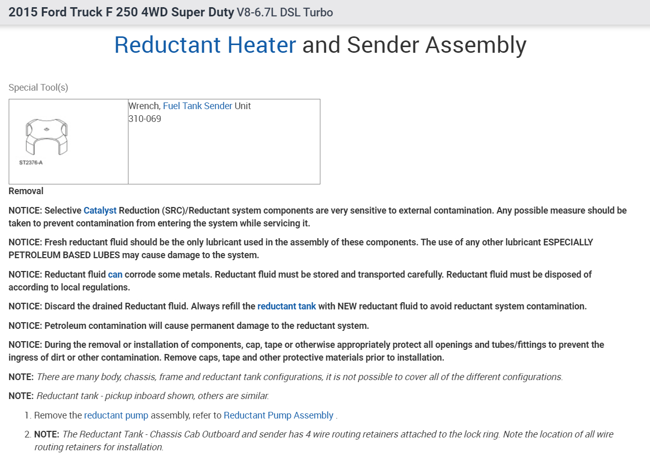

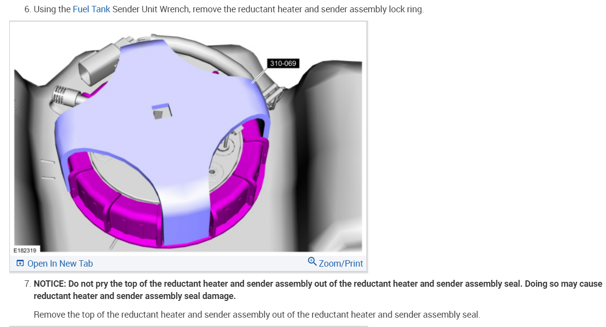

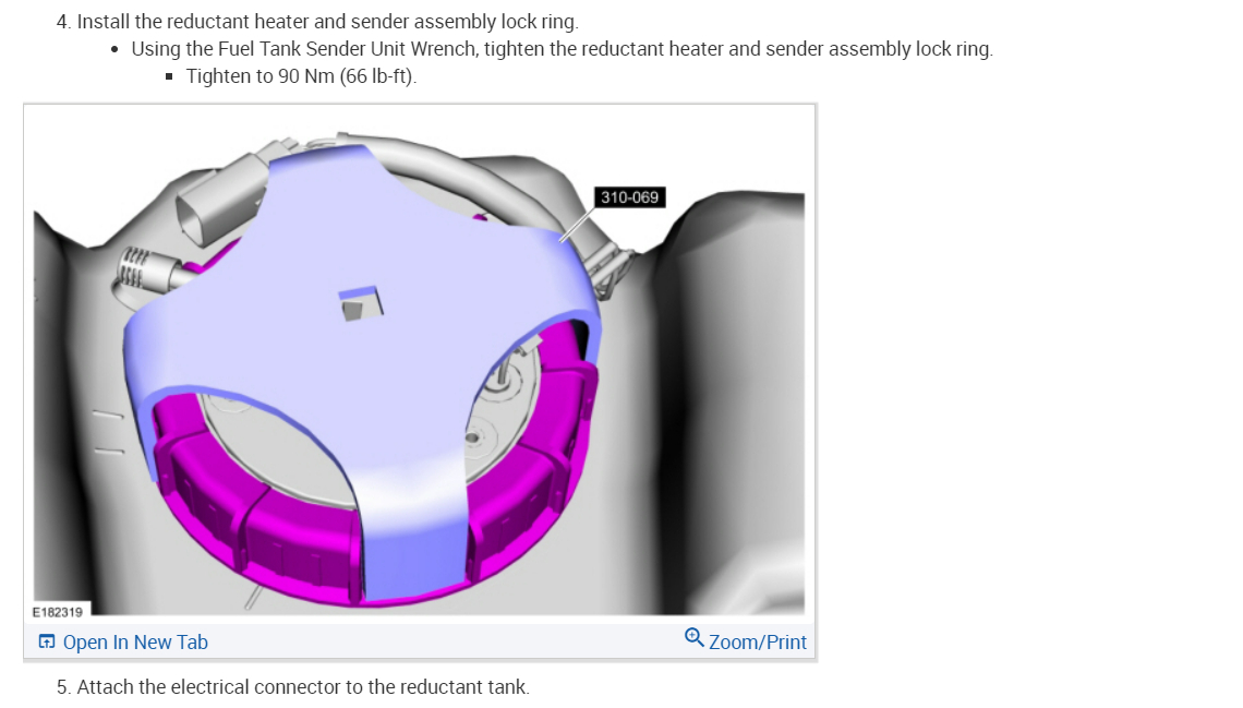

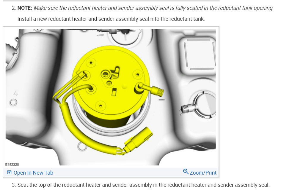

It sounds like you have a defective sensor in the tank. Did you clear the codes once the repair was complete? Here is information on the DEF system. Here is how to change the DEF fluid level sensor. Check out the images (below). Please let us know what you find.
