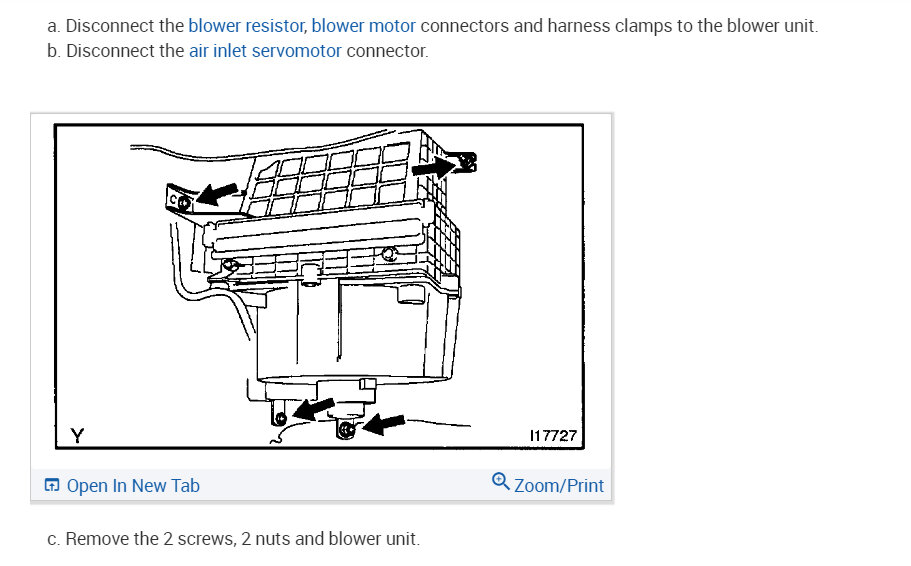

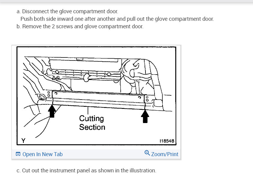

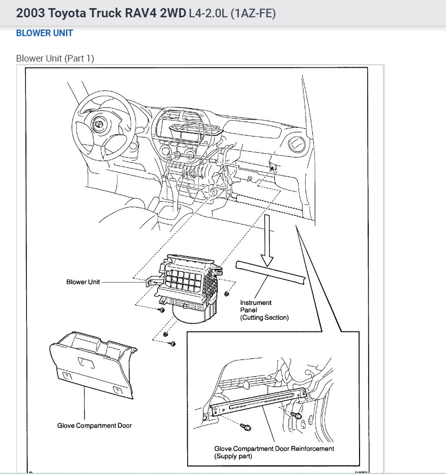

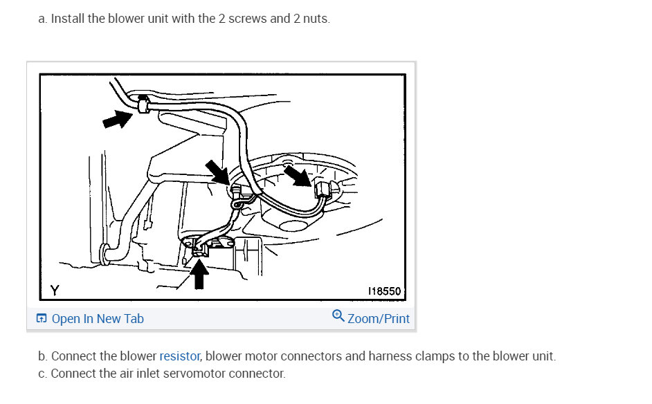

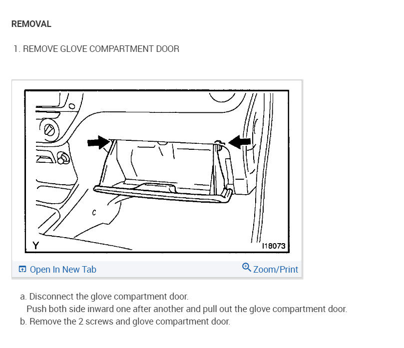

My vehicle has a deep RPM stumble as if trying to stall when I turn on the heater blower. However, after a few seconds the idle stabilizes on its own. Haven't noticed this happen when I turn on headlights or wipers. Any suggestion what might cause this?
Thank you,
Peter L.
Feb 1, 2023 at 11:23 AM
  • 55,732 POSTS

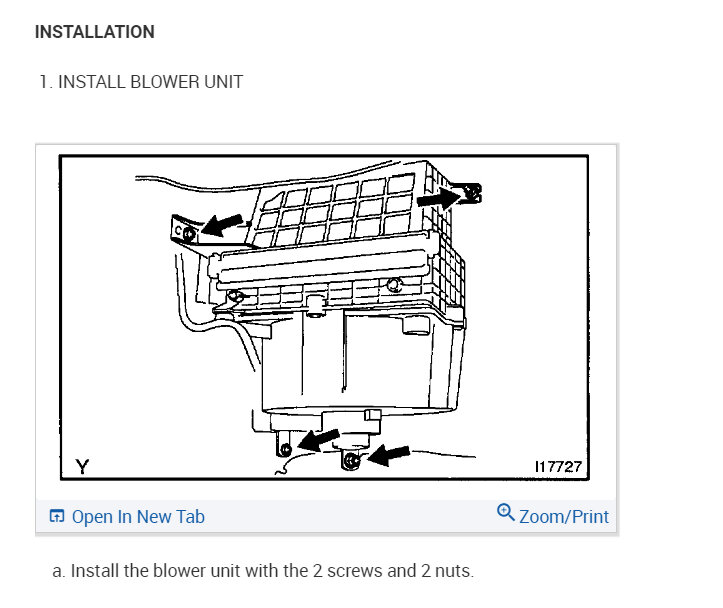

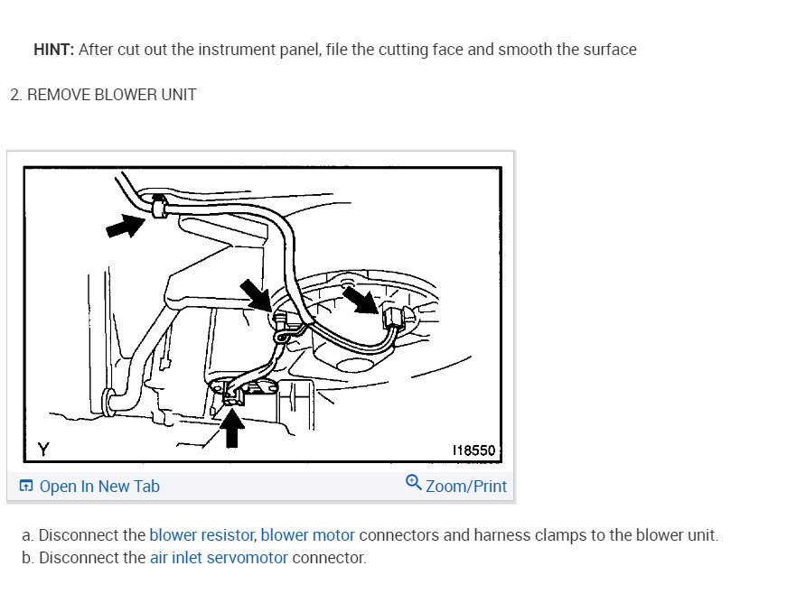

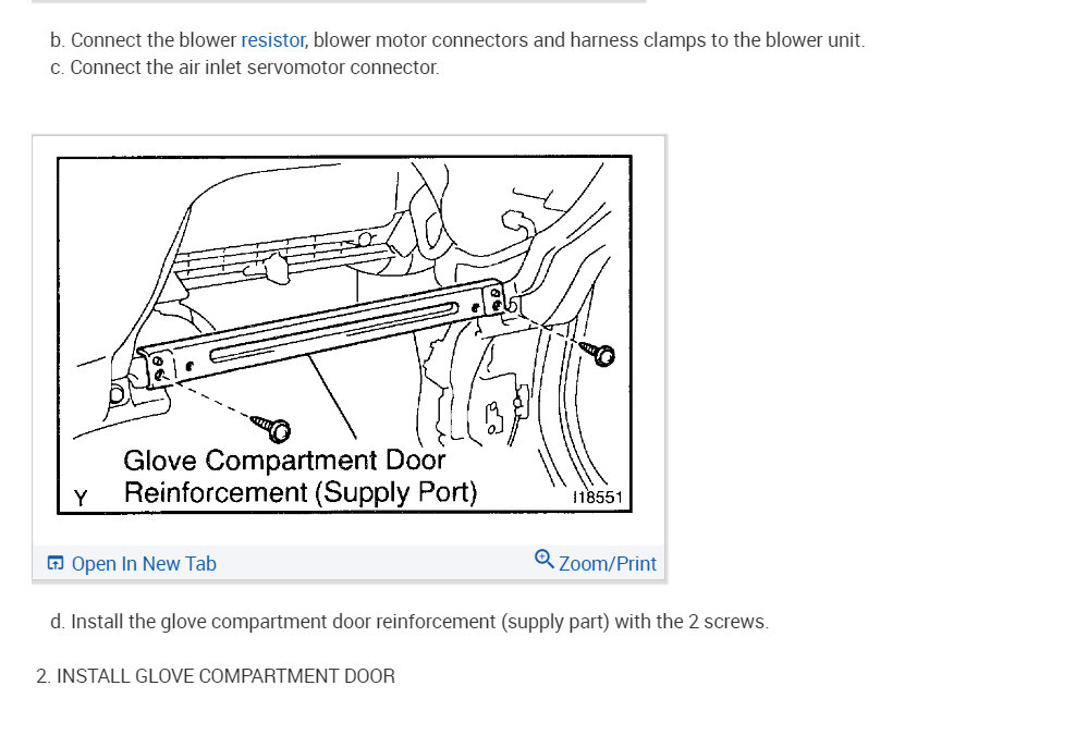

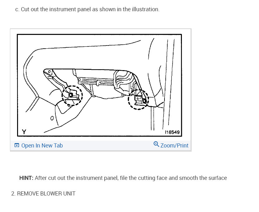

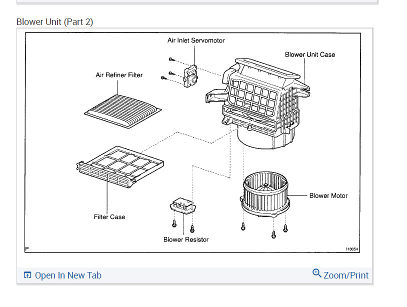

It sounds like your blower motor is starting to short out, to be sure let's unplug the blower motor to see if the problem still occurs. Here is the location of the blower motor and how to change it out in case you need it. Check out the images (below). Please let us know what happens.

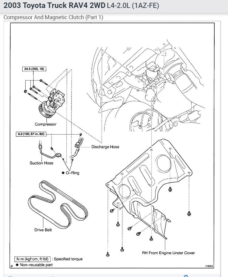

It took a while for me to get around to this problem. So, the shop informed me that I have a seized A/C compressor. To fix this problem they said it will cost me $1,800.00. Does this price sound right to you?
May 1, 2023 at 10:59 AM
  • 55,732 POSTS
it sounds a little high, here is the estimate from the book:
Compressor With Clutch Assembly 1.8 HRS @ shop rate
Compressor 883204208084 $585.78 new (you can find cheaper ones on amazon)
Here is one for $362.00 which included the new compressor and the condenser with oil and O rings:
https://amzn.to/40VXI7G
Here is a guide to help you with the vacuum down and recharge which should run about 1.0 hrs of labor plus refrigerant:
