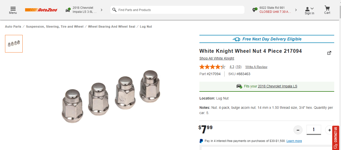

This ridiculous idea if having these cars where most people spend a ton of time just to remove them, like i did. Is there a set number for the size? I want to buy ones that do not have these decorative caps, how do i go about that without having to go to a store 100 times? Is there a size that is general to most of these cars where i can buy these plugs online?

If you want to replace the lugnuts with an OEM type, they are metric in size. You will need to get an M14 x 1.50 thread size. The length or depth of the lug nut should be 1.4" The degree of angle where the nut touches the wheel is 40 degrees.
If you go to a parts store and provide the year make and model, they will be able to get the right ones for you.
I attached a picture below from an AutoZone site showing what you need. The part number is also listed.
See pic below.
