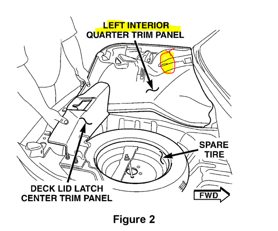

Convertible top is stuck down
2008 CHRYSLER SEBRING
172,000 MILES • 3.5L • V6 • 2WD • AUTOMATIC
ARMYNIGHTS1!
When I see what the code is it says deck lid latch limit switch is out. I have called everyone to fix it, and nobody wants the hassle. Any advice on how to fix this??

By chance, do you have the code that was found? I don't want to mislead you.

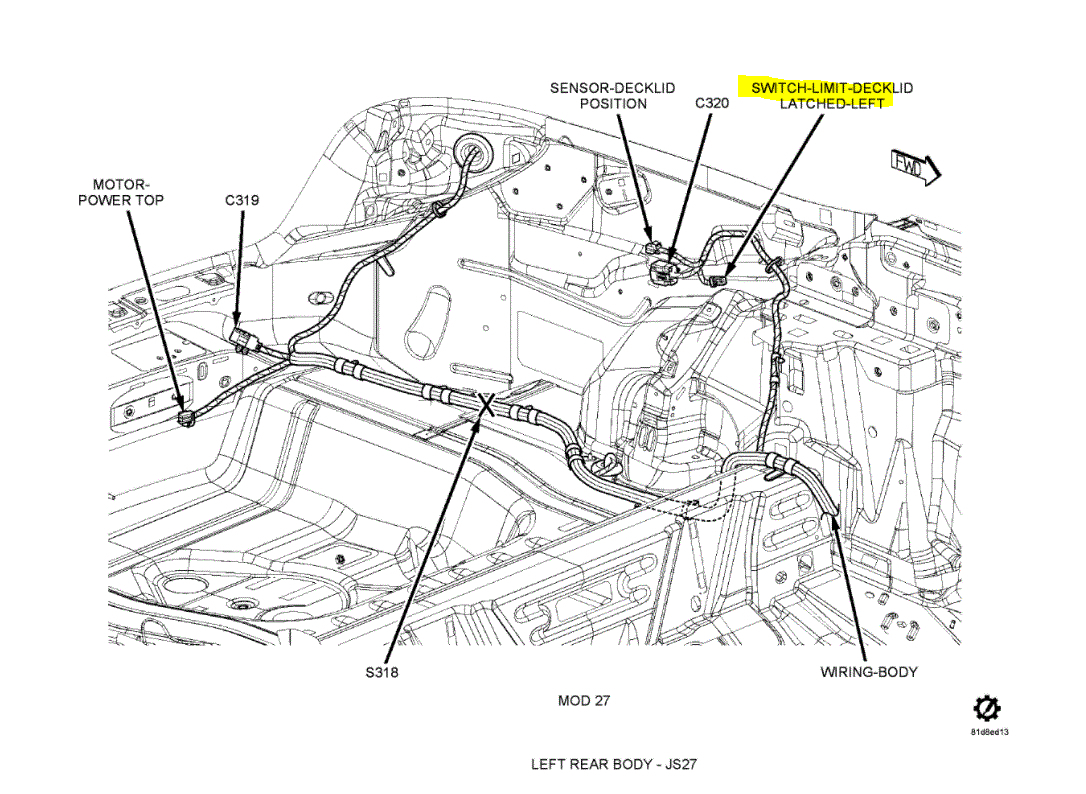

As far as the limit switch, it is in the trunk, driver's side, behind the trim. If you look at pic 1 below, it shows the approx location. IF you wanted to replace it yourself, I don't see why it would be difficult. Pic 2 shows from a different point of view. Don't laugh, but I tried to highlight/circle the approximate location. It looks like a 3-year-old did it. Sorry. It will help, regardless.
Let me know the code if possible.
