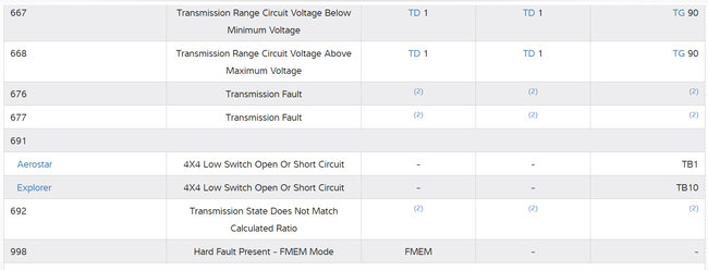

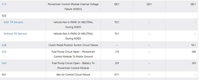

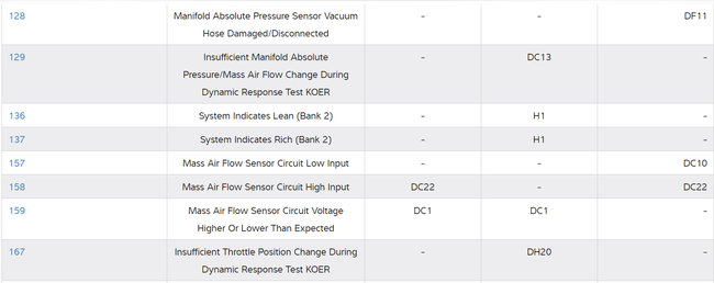

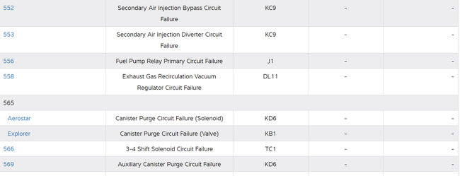

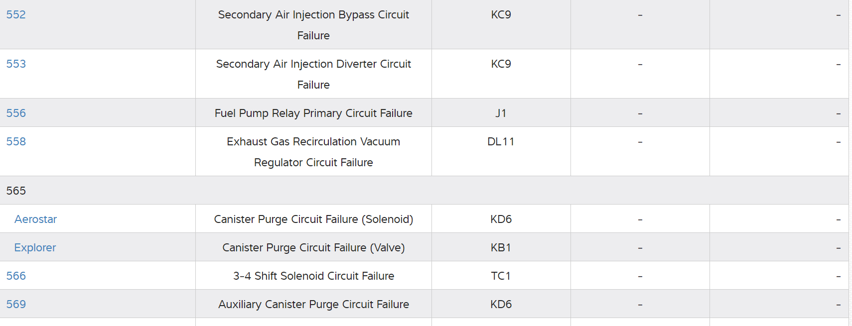

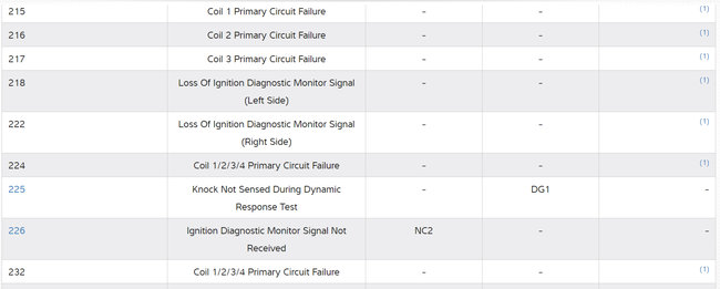

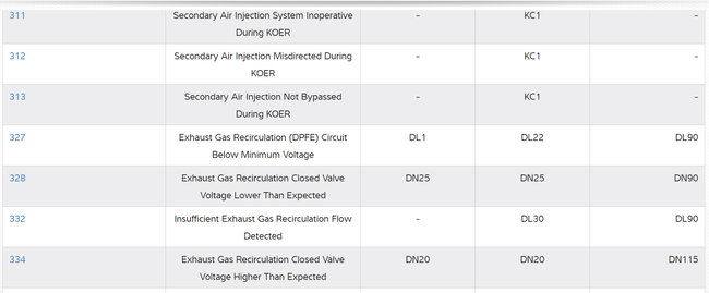

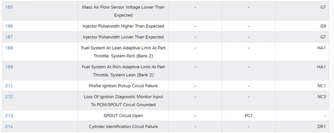

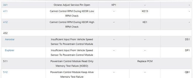

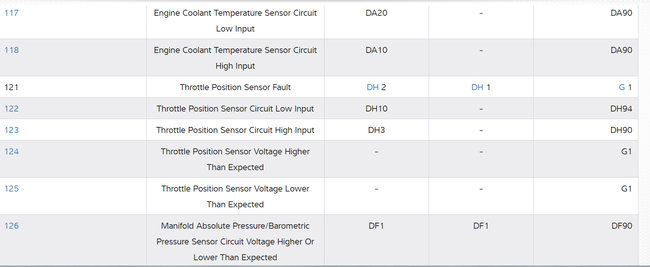

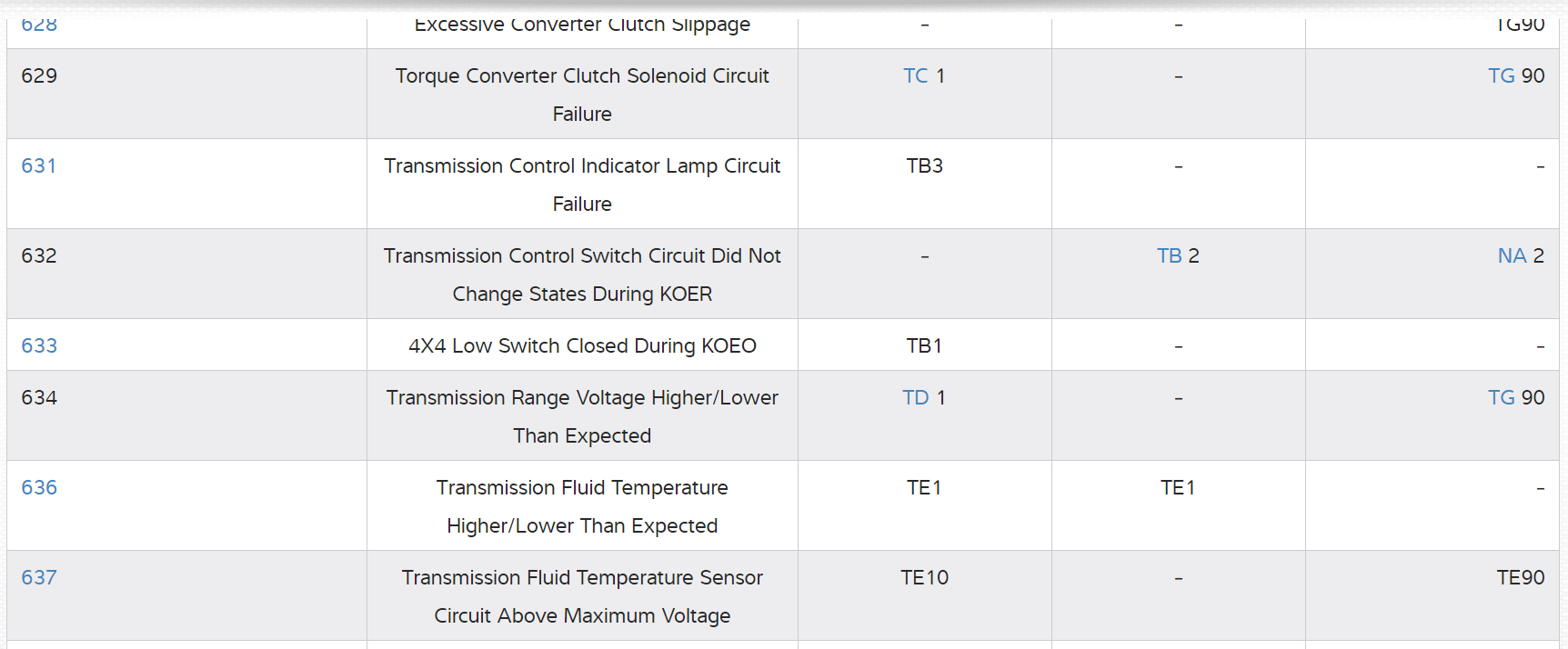

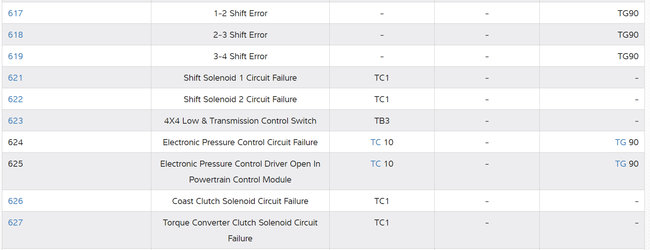

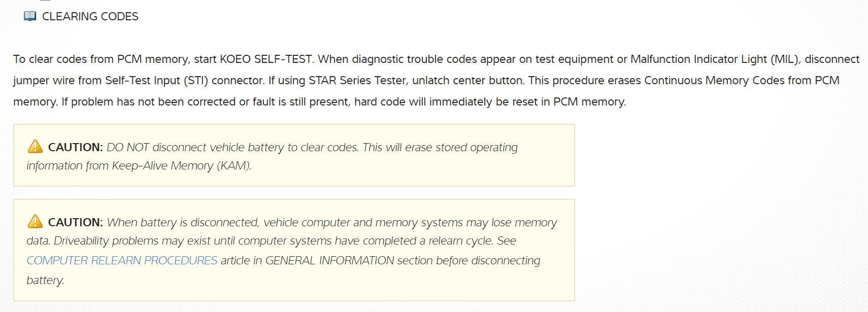

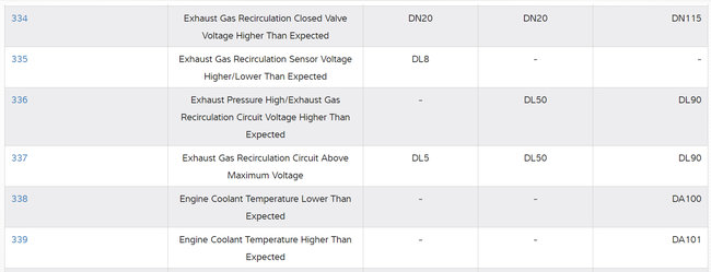

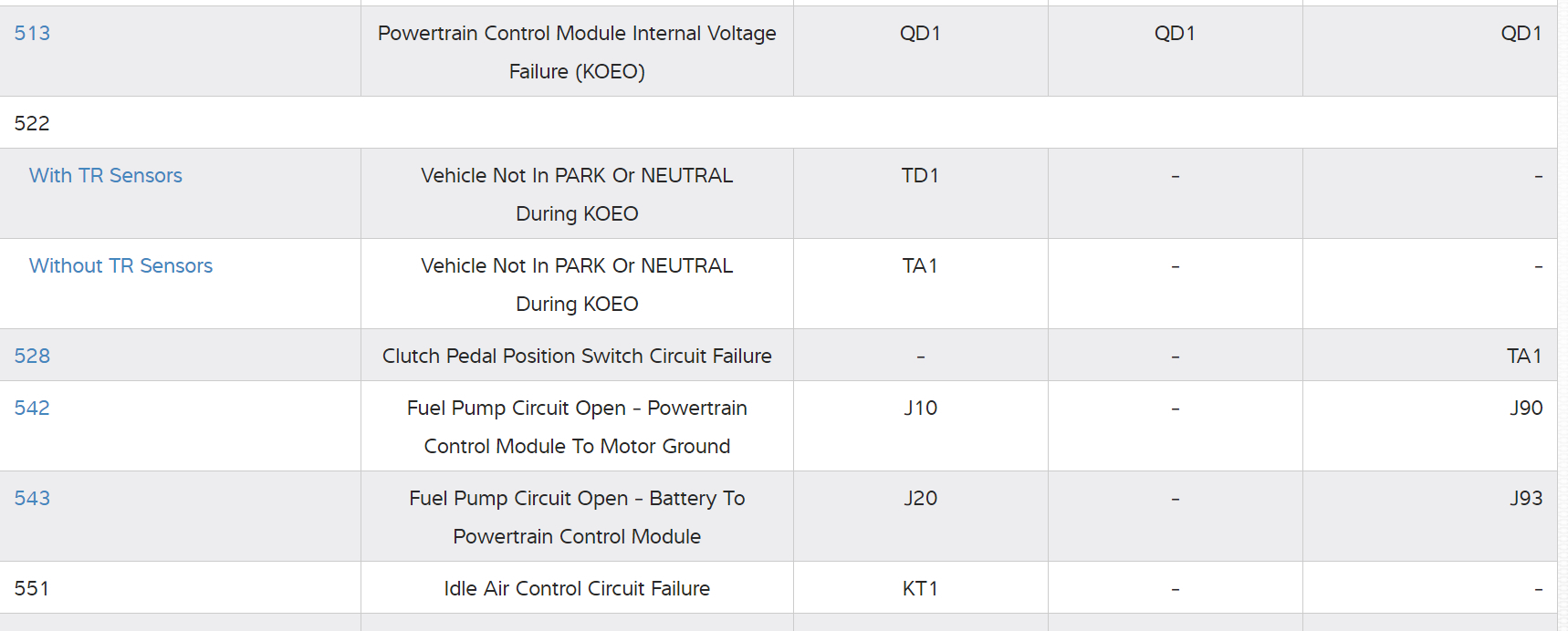

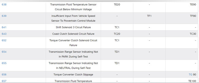

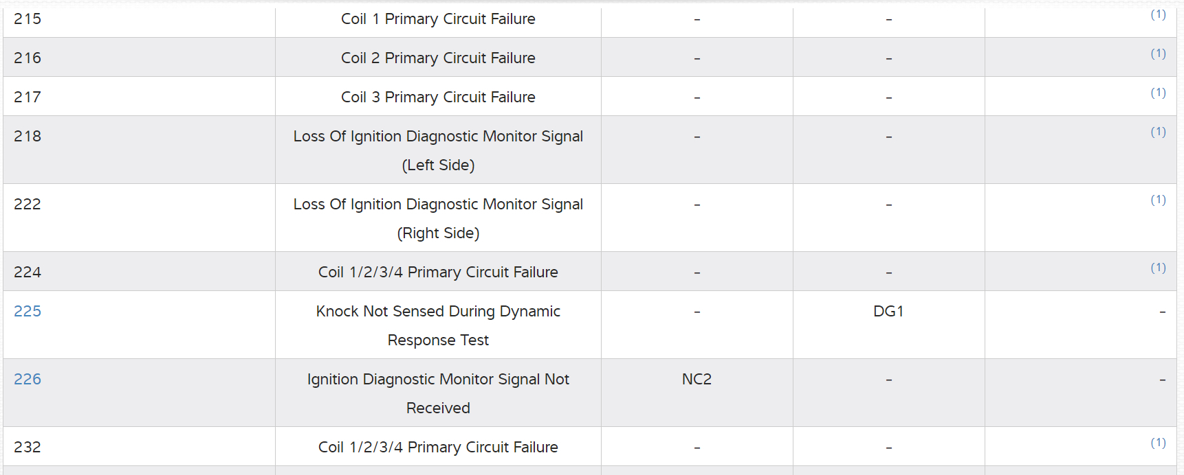

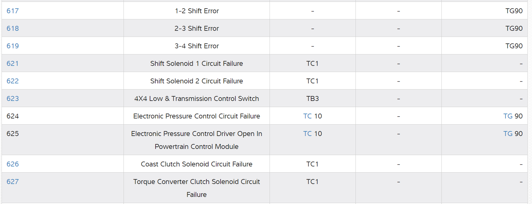

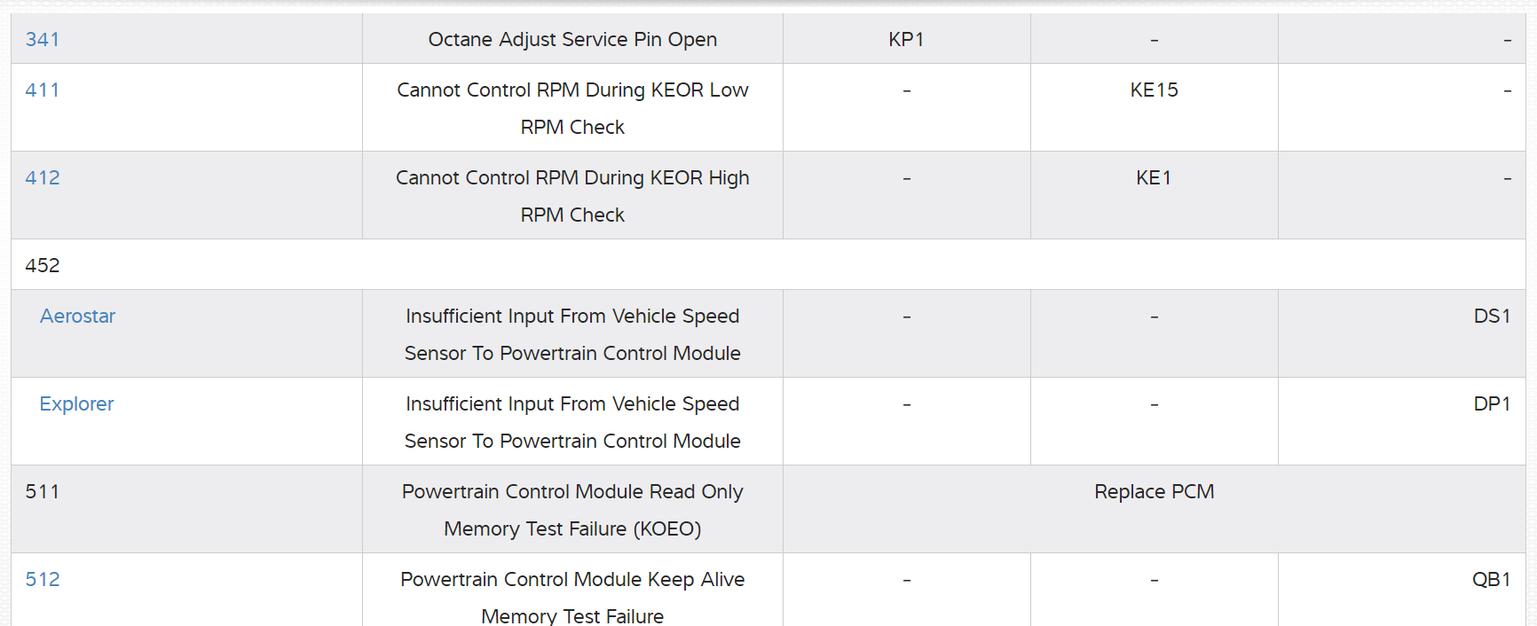

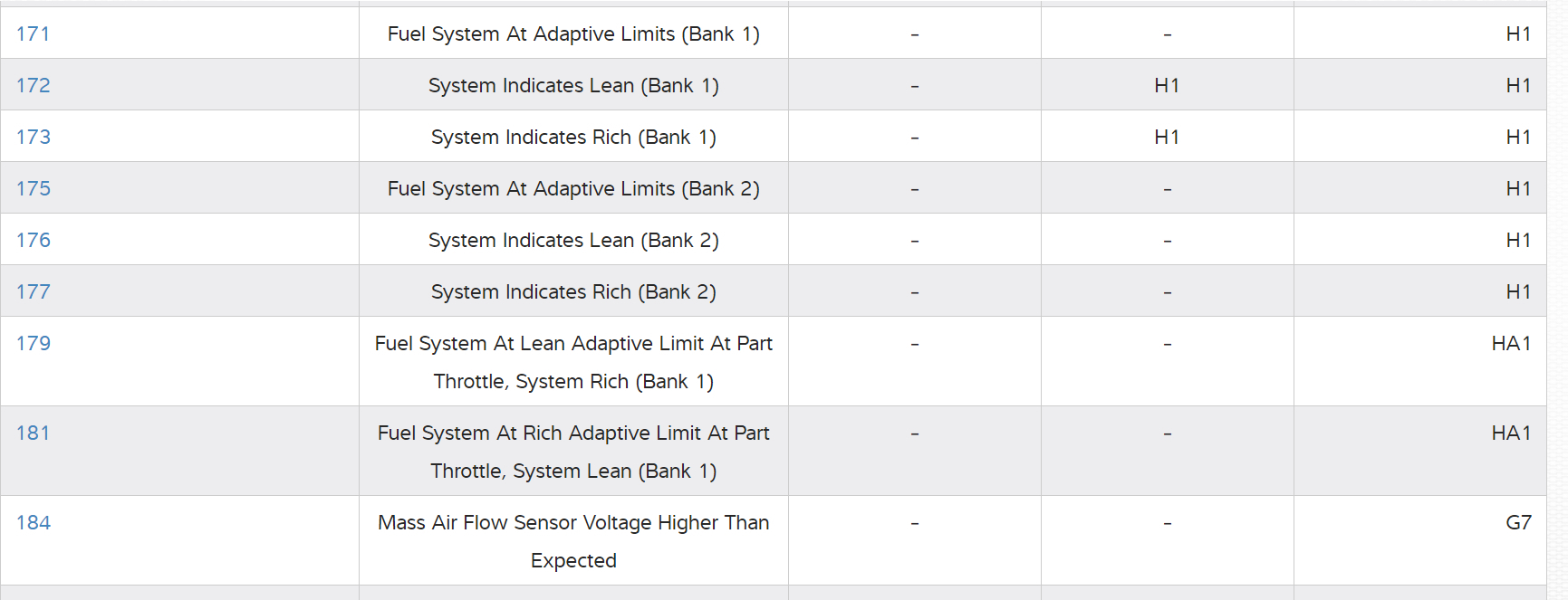

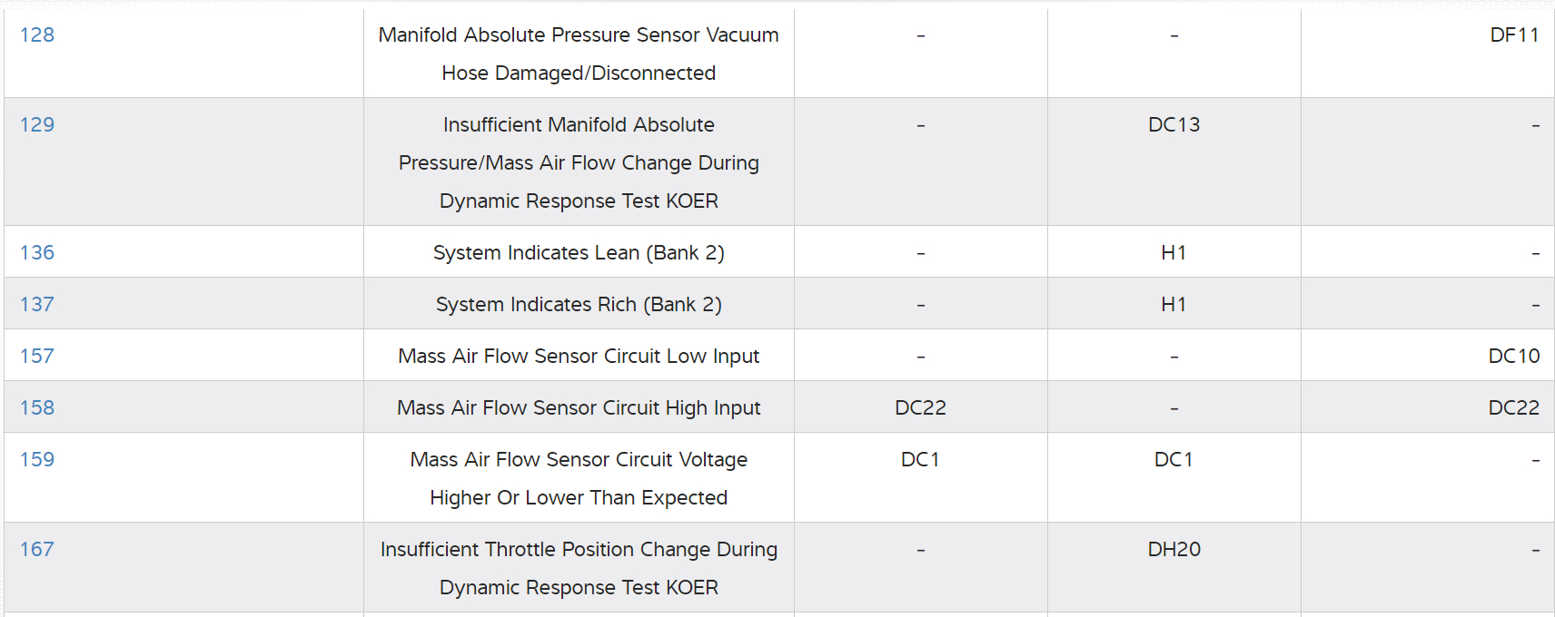

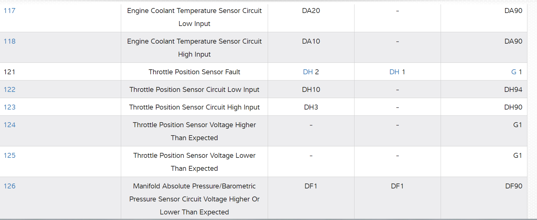

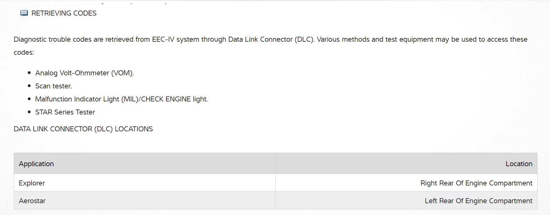

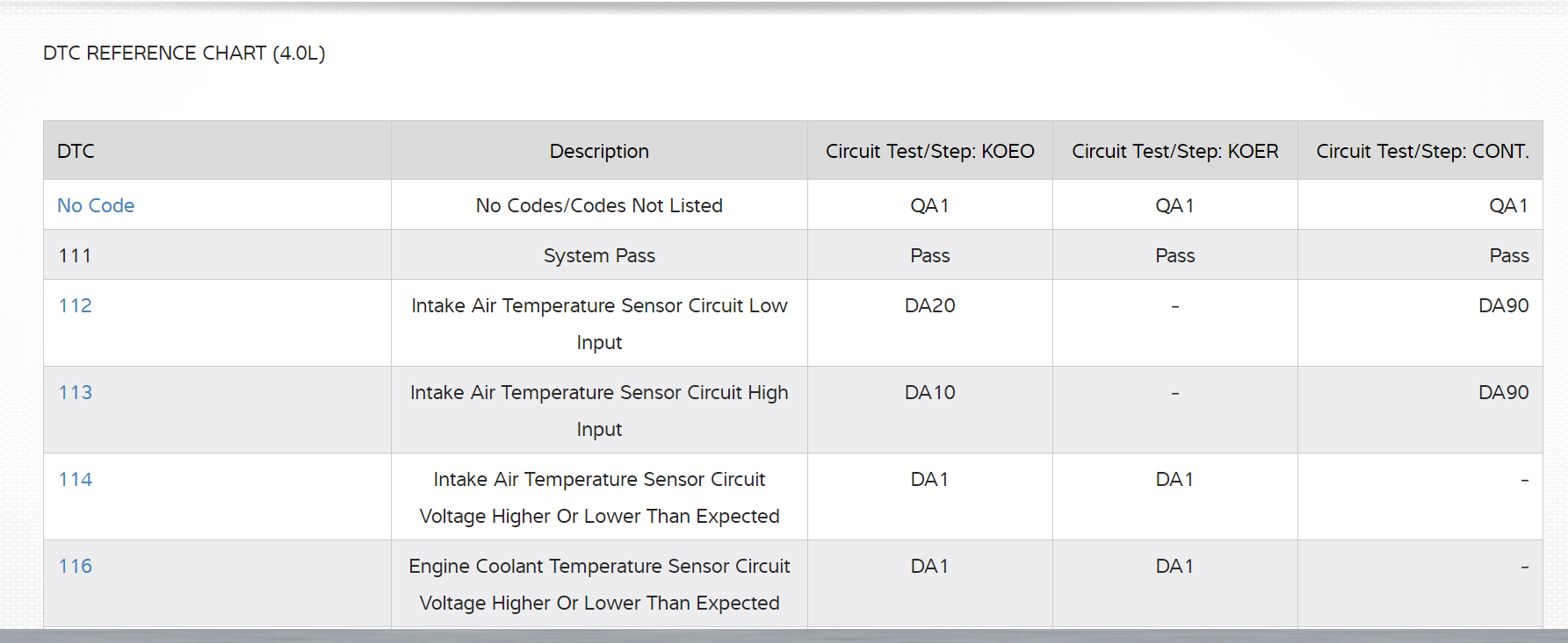

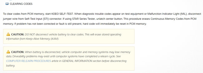

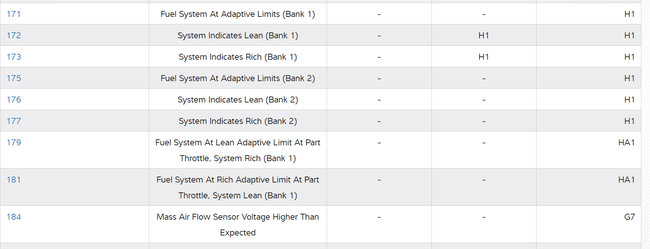

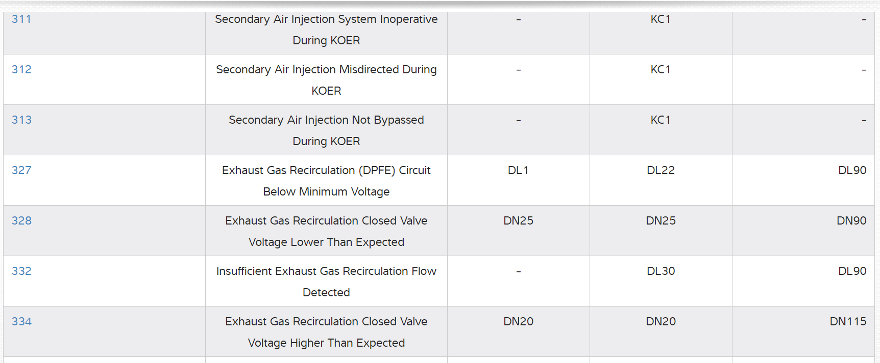

3 pause 3 pause 1 pause 3 pause 3 pause is the sequence.
Starts okay, after ten second starts to misfire, then runs okay once it warms up.
Please advise, is this a code 33? And Or 13?
Thank you for any help.
Saturday, March 16th, 2019 AT 3:43 PM
SCGRANTURISMO
MECHANIC
4,897 POSTS
I have included the information that you requested in the diagrams down below. Please let us know if there is anything else that we can help you with.
Thanks,
Alex
