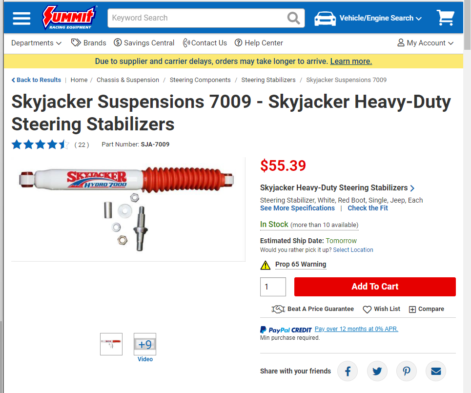

Okay. If it were me, I would rotate the tires and just make sure you don't have a weak side wall that would cause this. However, I suspect it is a steering dampener issue.
I would replace the steering dampener with an updated and larger dampener. Since you have a lift kit on the vehicle, you have altered the steering angles and so the stock dampener cannot handle the added load due to different angles and so they wear out quickly.
I would remove it and see if you can press the ram in and out by hand. If you can then it is worn out.
However, if you are going to take it off, I would just put a new one on since you can get a really good one for not much money.
Here is a link to the one I would use:
https://www.summitracing.com/parts/sja-7009/make/jeep/model/grand-cherokee
Please run through this and let me know what you find. Thanks
