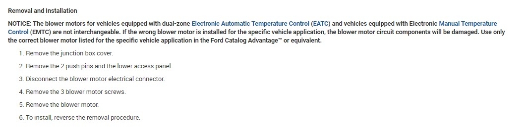

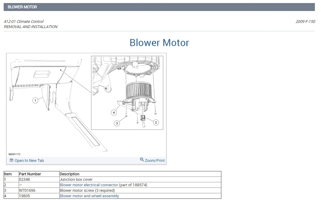

How or is there a simple way to get in the vent system on my truck listed above xlt super crew cab?
Dec 7, 2020 at 10:17 AM
BMDOUBLE
  • 1,139 POSTS
Mice absolutely love the blower motor area of the HVAC system, I guess it makes a nice nesting area and the warmth of the heater core is nearby, but they love it! I've included instructions on how to remove the blower motor. This is where I would start.
Dec 7, 2020 at 11:00 PM
