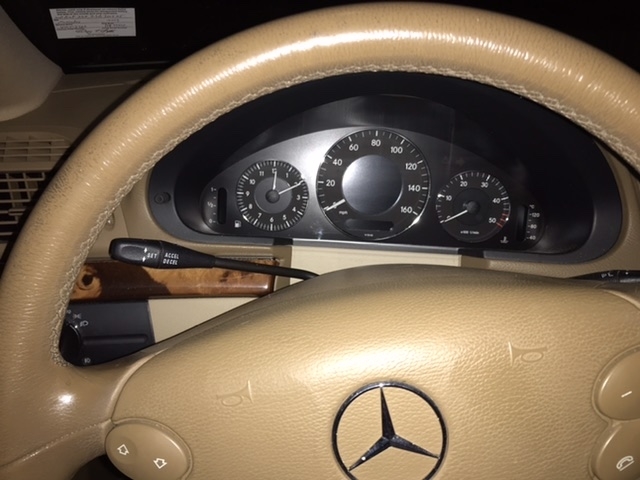

Hi, everything else seems to work around it, all lights, etc. the instrument cluster is not working. Clock, speedometer, tachometer, file gauge, temperature gauge. Whole thing.
Anyone know if they can be repaired? I would rather not replace with a used one.

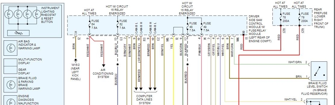

First, I need you to check a few fuses. Take a look at the attached picture. Check the fuses I highlighted and specifically the one I circled.

Hi Joe, thanks for the diagram. I did not see highlights or circled fuses on it, but I checked all the 7.5A fuses #’s 64, 52, 48, 49. They were all good.

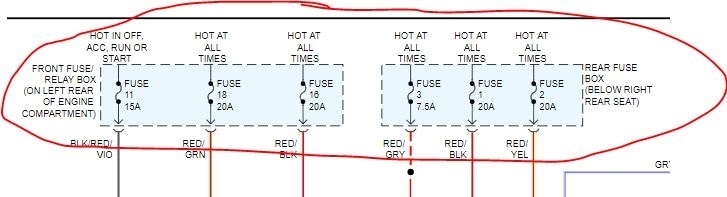

If they aren't, it can be a ground issue, a problem with the headlight switch itself, or the illumination module, which is part of the headlight switch. Also, I have a few more fuses we need to check. See pic 2

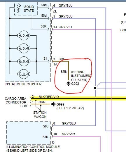

Also, if you can, there is a brown wire behind the instrument cluster which is a ground. Make sure it is okay. See pic 1

Brown wire does have continuity to ground. All fuses checked good except 18 which is not installed.
All fuses were in the trunk, none were in engine bay. 11 is 20A not 15A, 1 and 2 are 30A not 20A.

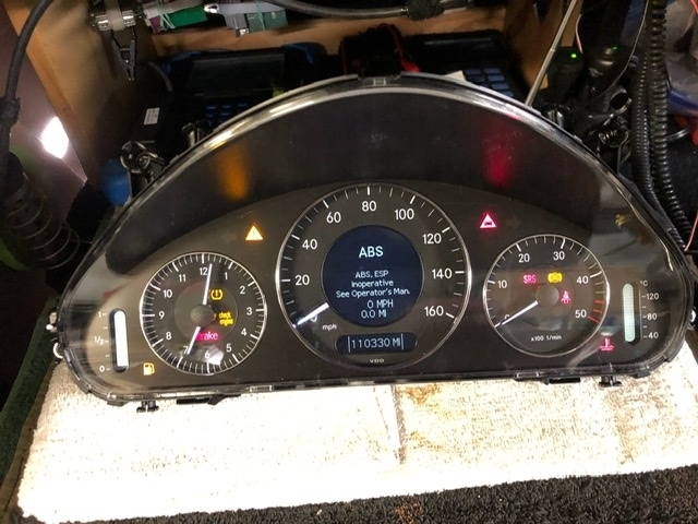

Got my instrument cluster repaired at a shop in Orlando, FL, AutoDigital. AutoDigitalinc.com is the website.

Hi Joe, yes. Keith, the tech, says he went through a rebuild procedure. Then tried powering up the cluster, and it powered up. My impression were that several components were replaced, including a power supply. He did not go into much detail.
