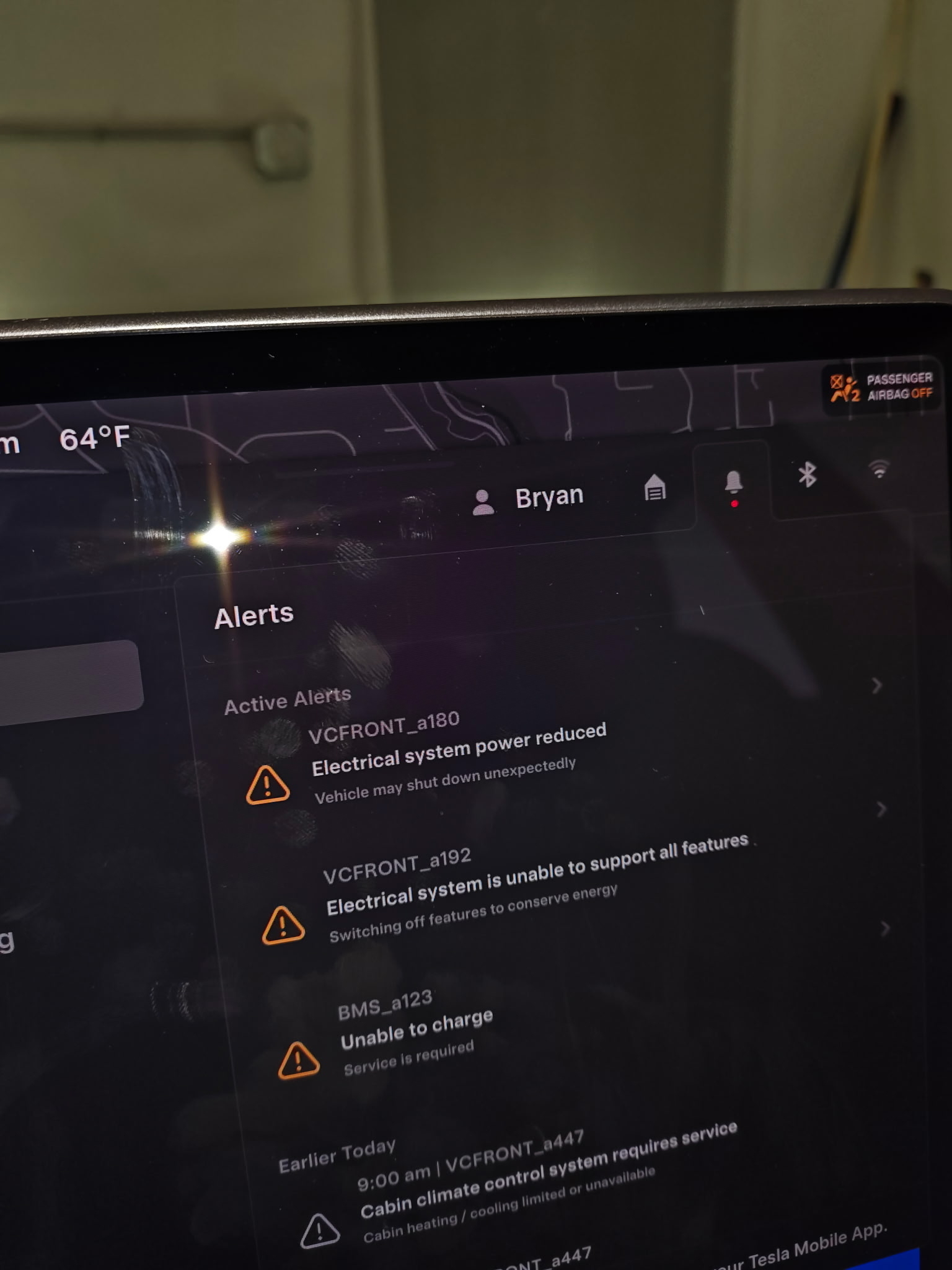

Replaced the 12 volt battery and now has codes and wont move

I would double check that the replacement battery is sitting at about 12.4 volts. Please check this guide to help.
https://2carpros.com/articles/how-to-use-a-voltmeter/
Can you confirm this is the Tesla Roaster? These alerts don’t automatically mean the main drive battery has failed.
VCFRONT_a180: Electrical system power reduced.
VCFRONT_a192: Electrical system unable to support all features.
BMS_a123: Unable to charge; service required.
Did you notice any performance issues before the battery replacement? Avoid touching orange high-voltage cables or repeatedly disconnecting components to clear the warnings. If the connections and replacement battery check out, it needs Tesla-capable diagnostics to determine why it cannot enable driving or charging.
