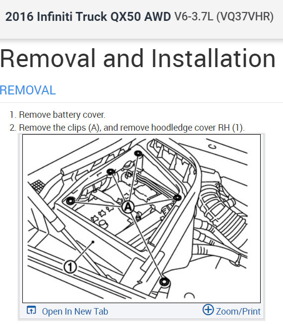

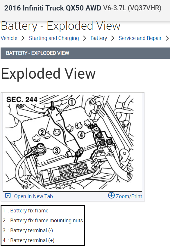

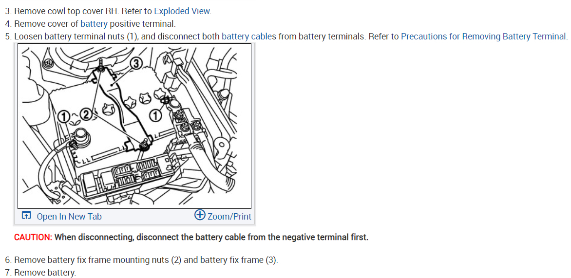

Chances are the battery is no good and needs replacement. Did you see any lights left on? The BCM usually turns all lights off after a short amount of time FYI. I would remove the battery and take it to an auto parts store for testing. Here is how the job is done. Here is a generic guide to help you step by step with instructions in the diagrams below to show you how on your car.
https://www.2carpros.com/articles/how-to-replace-a-car-battery
