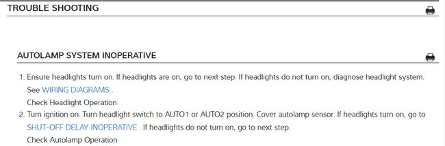

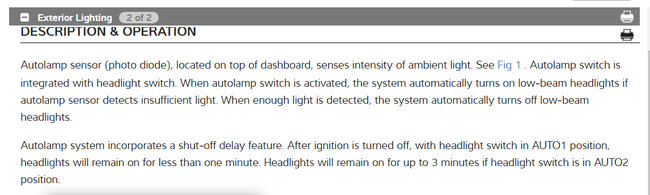

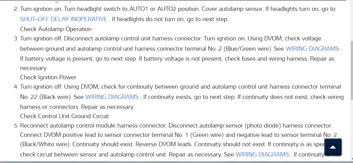

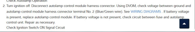

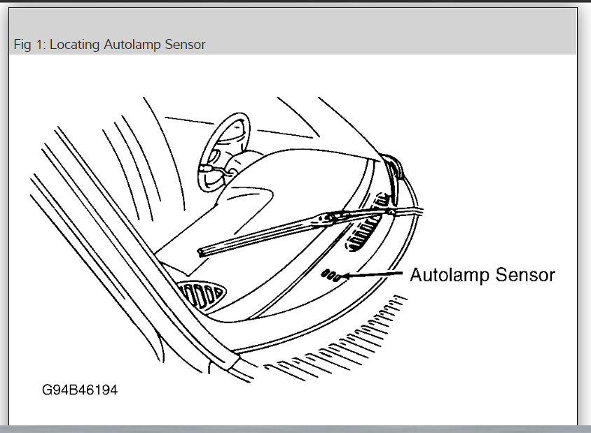

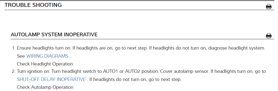

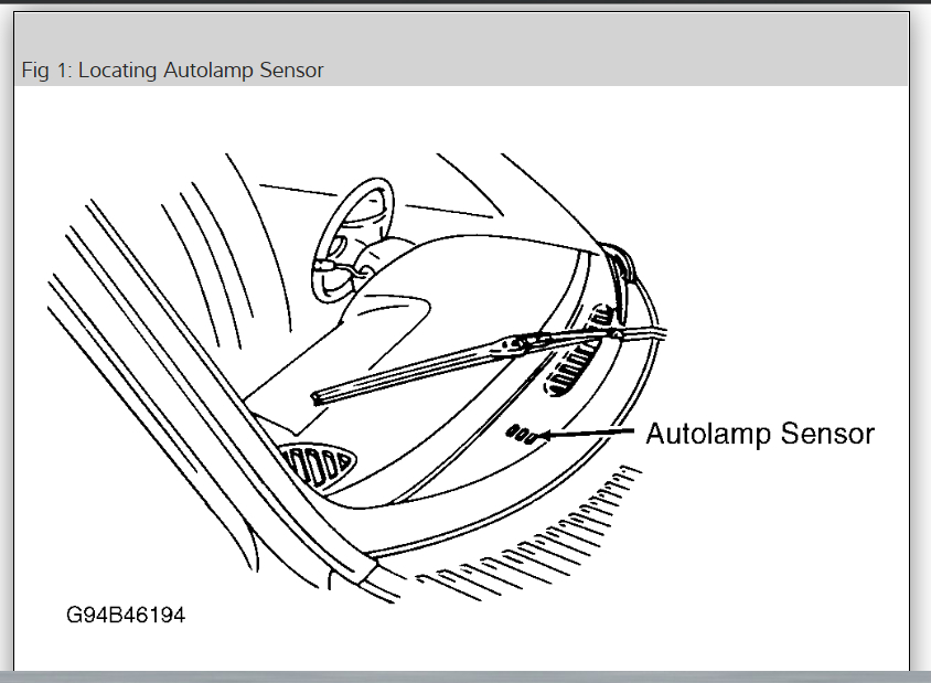

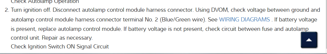

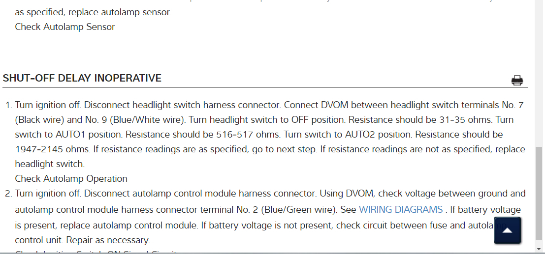

SCGRANTURISMO
  • 4,897 POSTS
Hello again,
That sounds very weird about the battery. They either have a bad cell or they don't. They usually get bad cells by not having enough electrolyte in the cell and it goes dry. I was looking through the lighting system for something that could be causing a draw on the system and came across this. Please see if this might be causing the problem. I have included it in the diagrams down below.
Thanks,
Alex
2CarPros
