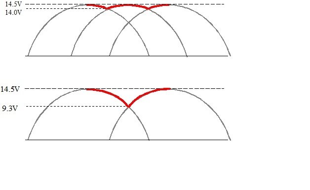

I put this drawing together to show what ripple voltage is. That's the red line in the top drawing. Every AC generator, (technically, "alternator" is a Chrysler term), has at least six "diodes". Those are one-way valves for electrical current flow. If all six are good, you'll get the top waveform, and under test, this is the only time the alternator will develop the maximum current it is designed for. You can find the listings on the Rock Auto web site, but I'd be pretty sure yours is rated for at least 120 amps.
When one diode has failed, you'll get the lower waveform in my sad drawing. Ripple voltage here is "high" and will be shown as such with a series of flashing lights on most testers. The other symptom is the alternator will only be able to develop exactly one third of its rated current. That can be enough to keep the engine running, but it's usually not enough to meet the demands of the entire electrical system and charge the battery. The battery will have to make up the difference as it slowly runs down over days or weeks. High ripple voltage also commonly shows up as an irritating whine on AM radio, that changes pitch with changes in engine speed.

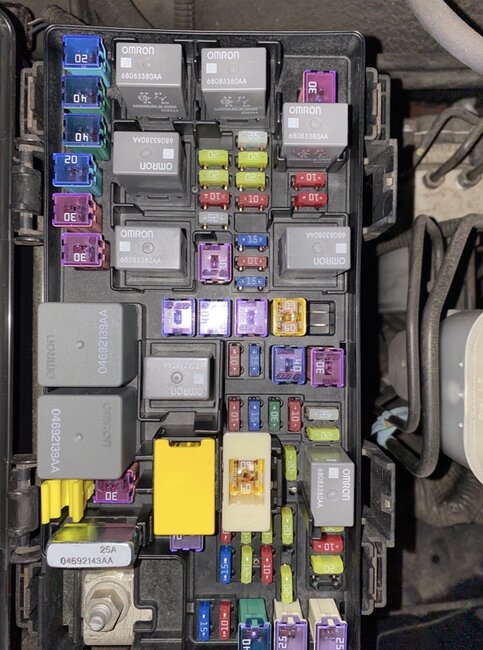

One more question, regarding the “very high-current alternator output circuit” you mentioned earlier, do you know where it is / have a diagram? I removed the black plastic fuse box cover next to the battery but don’t see anything of a 125-amp. (See pic). Thanks for your continued help.

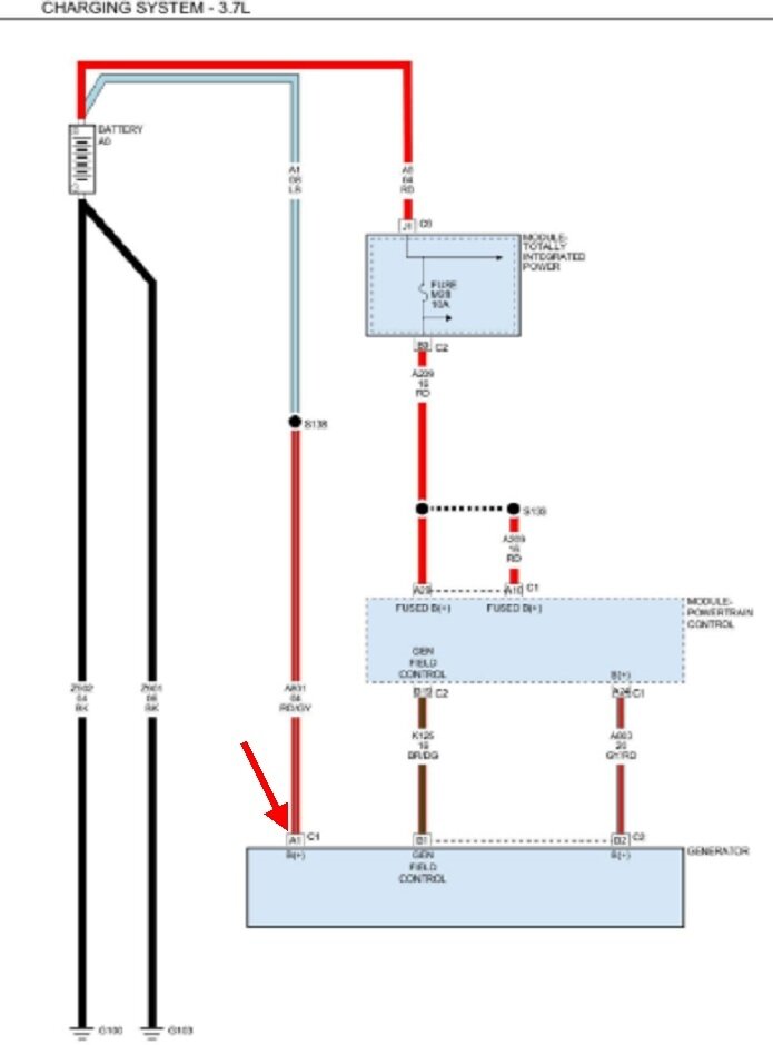

You're right. I don't see that fuse on the diagram either. It looks like they were still using a fuse link wire. That would be the gray section of the wire in this diagram. They show it here as being connected to the battery's positive cable, but I usually see them attached to the fuse box. Regardless, there's two ways to test it if it is necessary. If you can find it, just tug gently on it. If it acts like a wire, it's okay. If it's burned out, it will act like a rubber band.
The faster way is to measure the voltage right on the large stud on the back of the alternator when the engine is not running. There should be full battery voltage there all the time. That's at the red arrow in the diagram.
Of course, if the previous battery voltage test shows the charging system is working, that fuse link has to be okay.
Fuse link wires are just a regular piece of wire, but they are of a slightly smaller diameter than the circuit they protect, making them the weak link in the chain. Their insulation is designed to not melt or burn, so they must be replaced with the same type of wire. You can buy these links at any auto parts store. They usually are about 12" long, so you can cut them to make two or three repairs. Buy the same color insulation as that denotes their current rating, just like they do with fuses.
