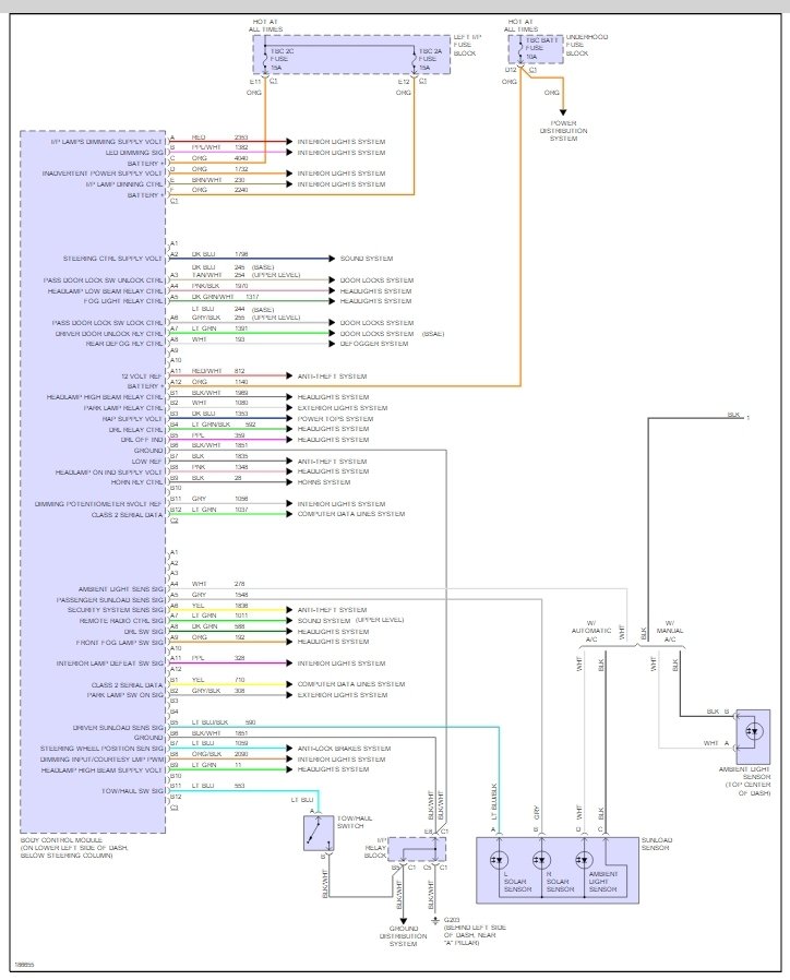

I took door panel off,took ddm apart and accidentally shorted something out and now there is no power.

ok, the fuse is located in on the left side of the dash. It should have power to both sides of the fuse with the key on.

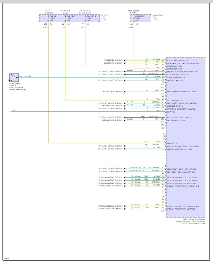

I found these I hope they can help
