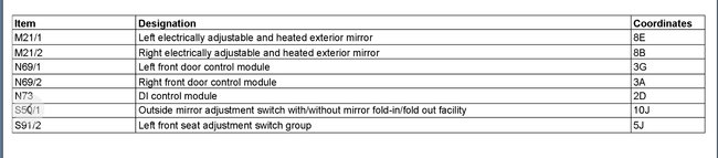

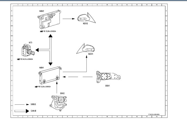

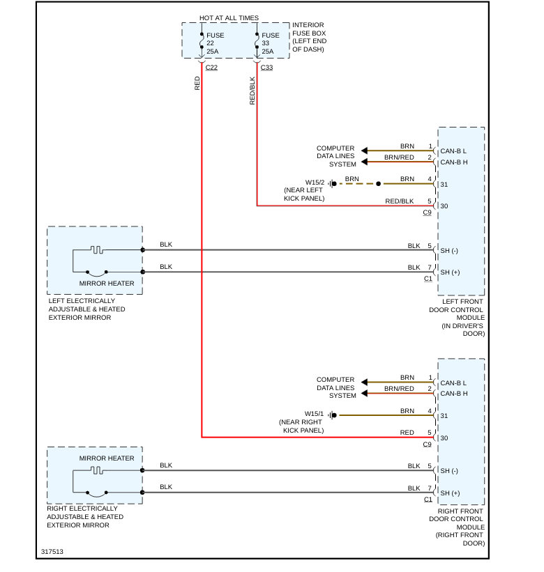

Need the pin out that goes to drivers side view mirror motor. It comes from the DCM modules 1 and 6. It is 7 wires going into an 8 pin module that plugs into mirror motor with pin #4 vacant. Please help. Thanks
Feb 17, 2020 at 2:24 AM
SCGRANTURISMO
  • 4,897 POSTS
The vehicle manufacturer does not provide pinout diagrams for the mirrors but I have included all the wiring diagrams that we have for the mirrors on your vehicle in the diagrams down below. I hope that this helps.
Thanks,
Alex
