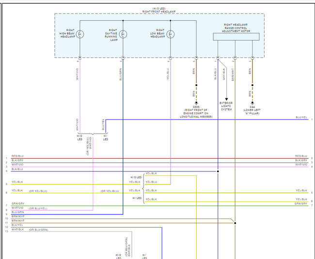

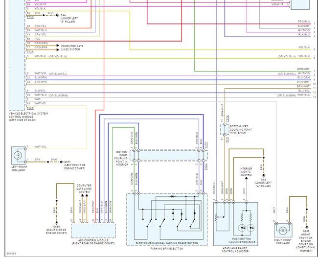

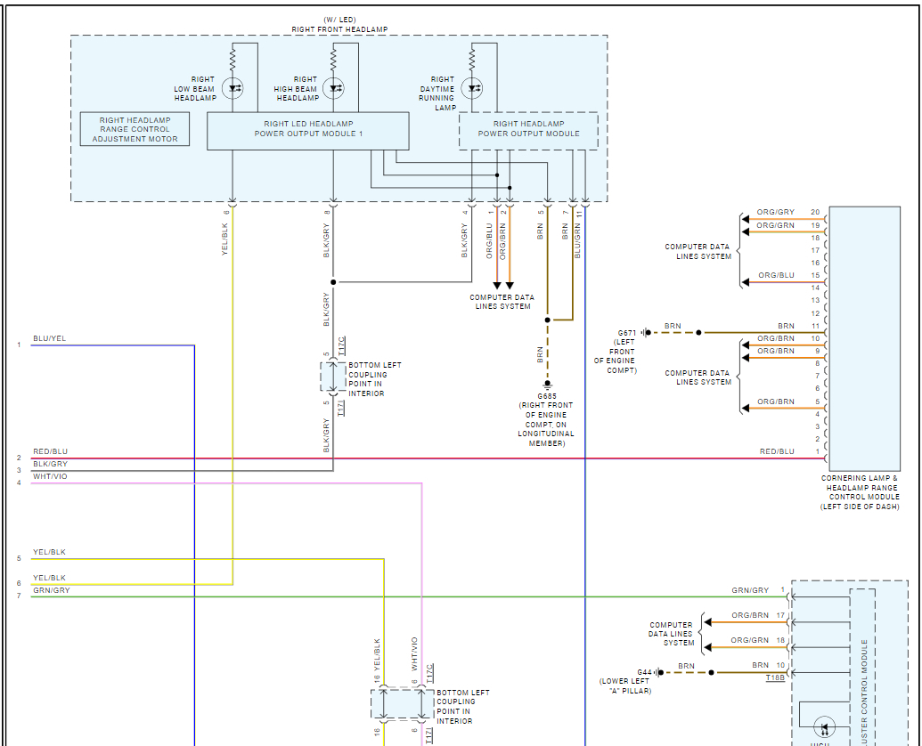

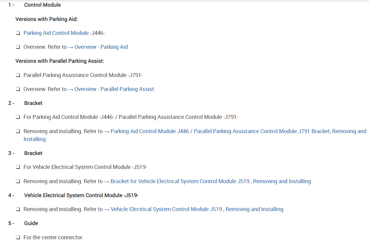

My daylight running lights do not work, even though parking lights work.
I tried an adaptation in VCDS, but nothing works.
Any tips?
May 11, 2024 at 5:38 PM
  • 55,447 POSTS

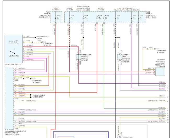

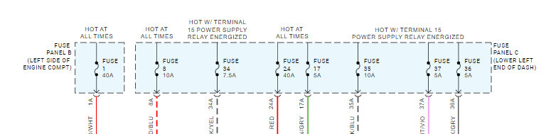

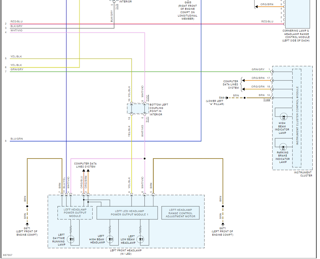

VCDS (VAG-COM Diagnostic System) is a software and hardware combination that allows for deep-level diagnostics and adjustment capabilities and can read and clear Diagnostic Trouble Codes (DTCs) from all the vehicle's control modules.

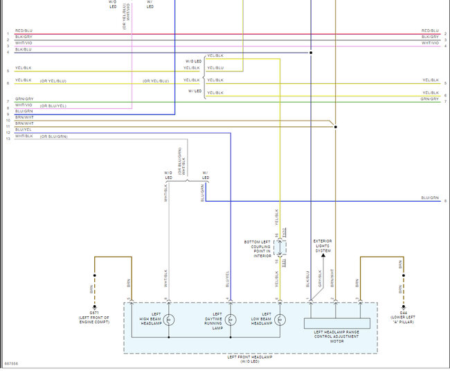

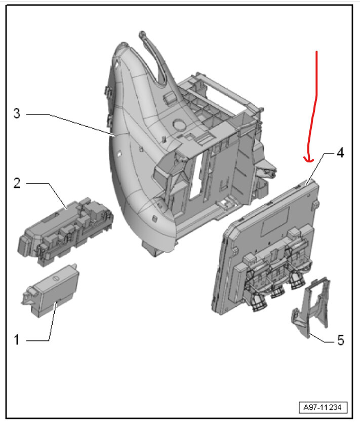

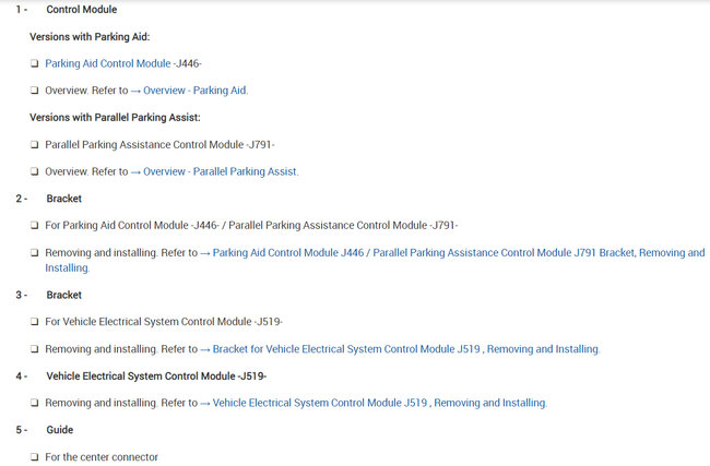

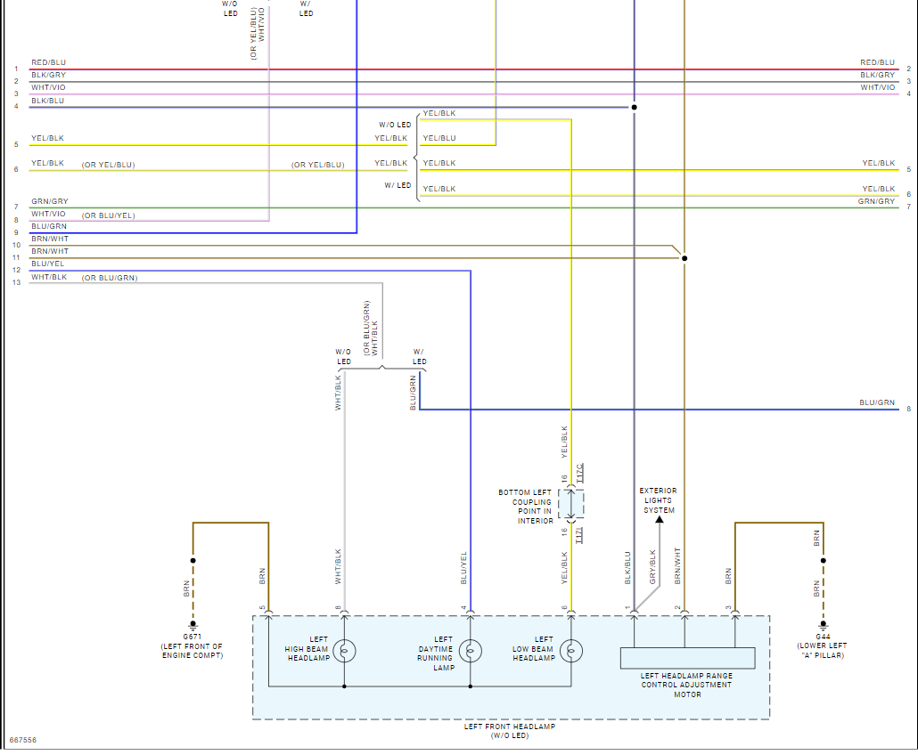

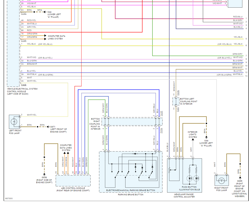

The DRL's are controlled by the vehicle electrical system control module by the left side of the dash but there are 8 fuses that run the system we should check first, here is a guide to help and the fuses that need to be checked in the images below, also I have included the complete headlight and DRL wiring system diagrams so you can see how the system works.
Here are the fuse locations as well in the diagrams, check out the images (below). Let us know how it goes

Thank you so much for your answer.
I checked all fuses, and all of them are okay.
The LED-s are working, only as park light. (park light position)
car was imported from Japan to New Zealand.
If i choose both lights under TFL (DRL) in adaptation, then i have led+low beam working on switched off position, but nothing on auto. If I choose daylight running lights, then nothing works (neither on switched off or auto position)
If you want more info, please let me know.
Thank you

Okay, it sounds like the "vehicle electrical system control module has gone out but to be sure we should do a CAN scan to see if any codes are stored. You can get a CAN scanner (Controller Area Network) which will work on most cars from Amazon.
https://youtu.be/u-4syLc-ifQ
Here is how to change the vehicle electrical system control module out for a new or rebuilt unit. Check out the images (below). Please let us know what happens.
