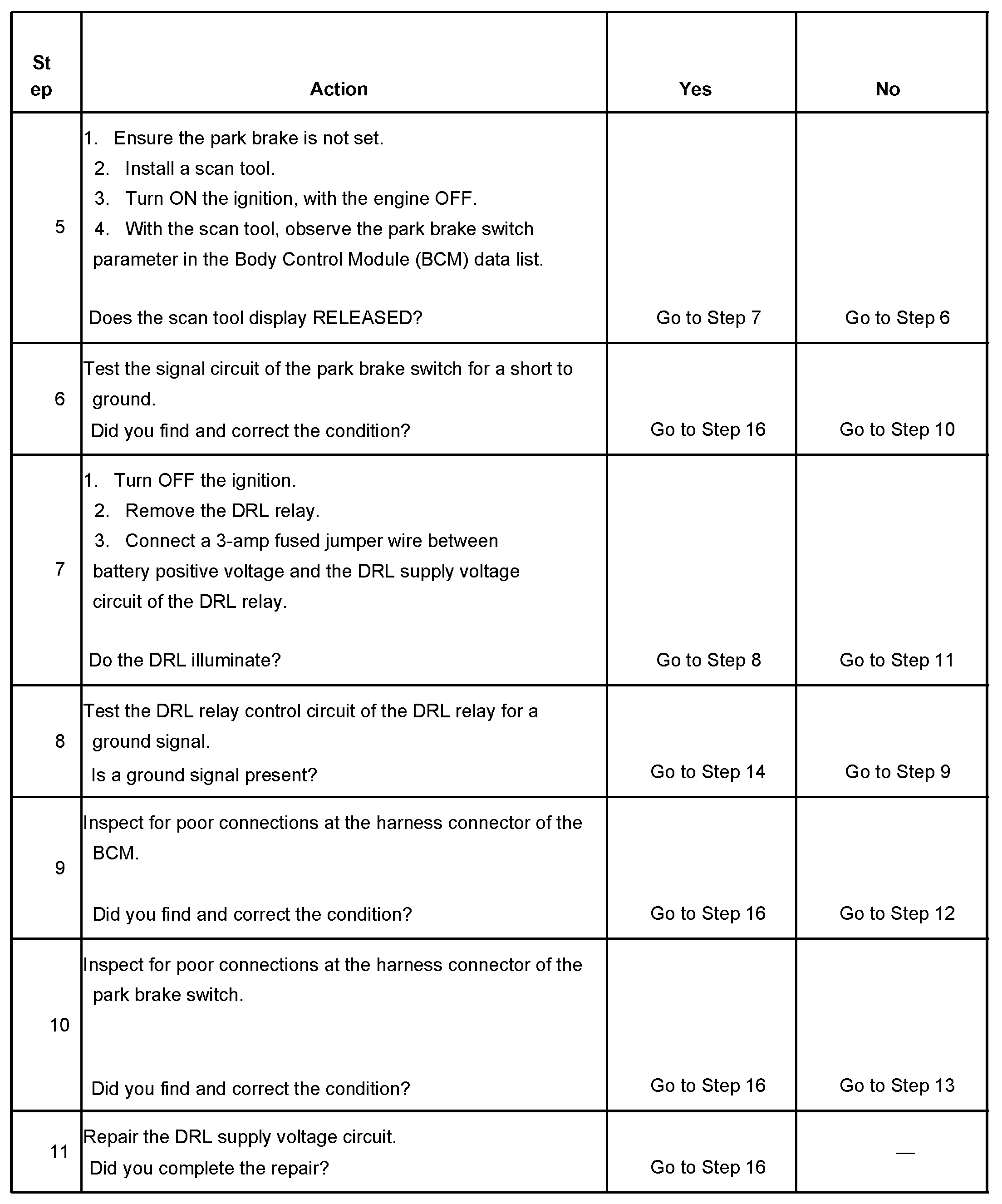

The DRL on my truck stopped working. the fuse is okay, and i replaced the relay. I will be doing a more thorough testing as suggest by your relay article. Just getting frustrated, they worked 4 days ago , now they won't. Oh, bulbs are good, I replaced them yesterday.

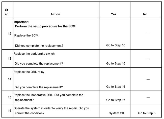

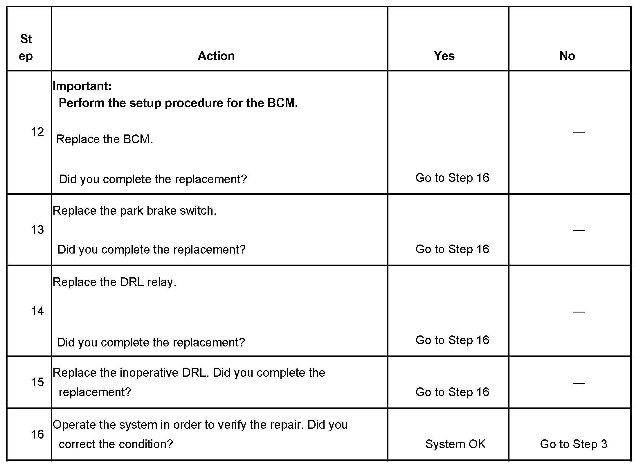

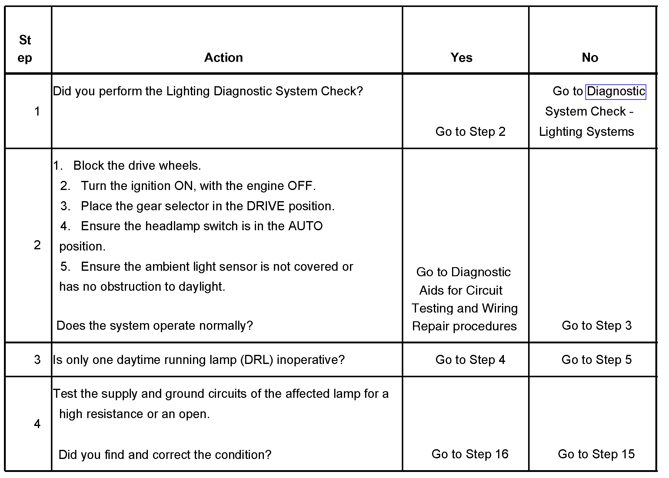

If they just stopped, it could be a few things. I have attached the diagnostics specific to this vehicle for testing. Take a look through them and let me know if they help or if you have other questions.

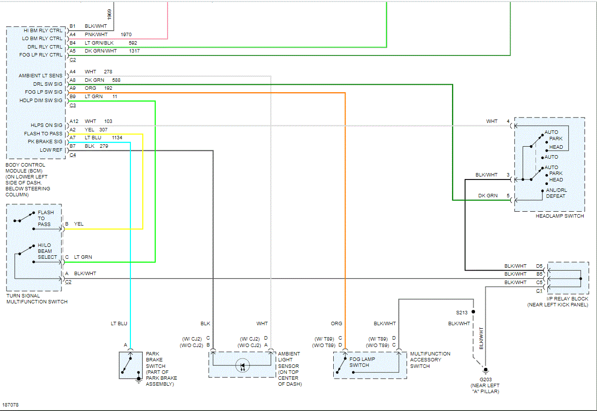

I don't have a wiring diagram to do some of the testing you are asking for DRL and/or headlamp.
Nov 21, 2020 at 7:25 AM
  • 110,244 POSTS

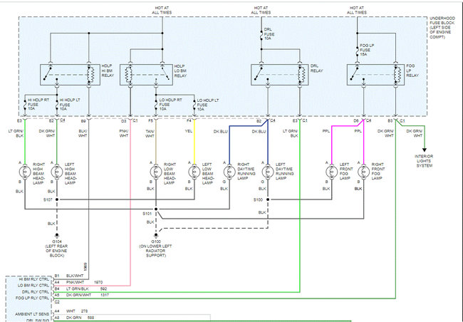

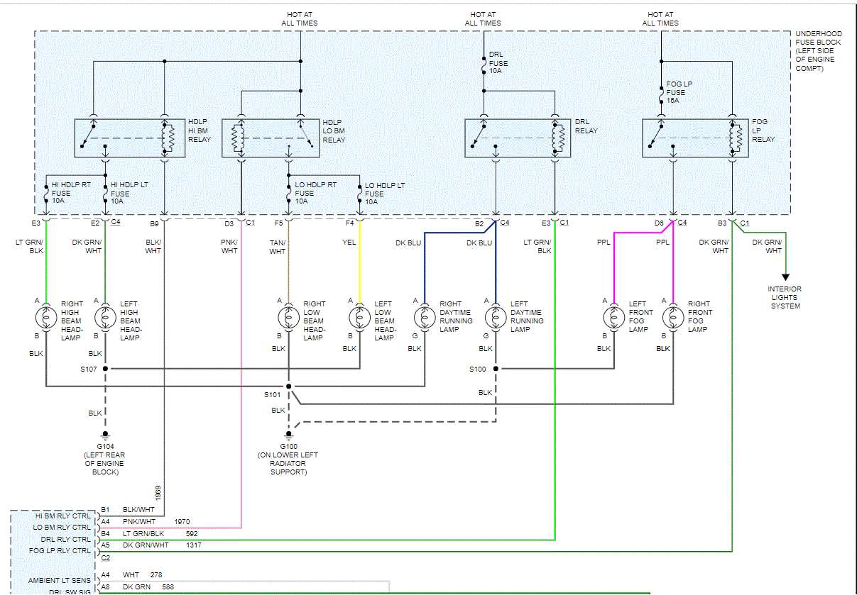

No problem. I attached the schematics for the headlamp system/DRL. I had to cut the pic in half to make it more readable, but I did overlap the two so you can follow them easier.

Found out there was nothing wrong after all. The weather condition around my area are cloudy a lot and did allow the DRL to come on when i thought they should. Thanks again.
