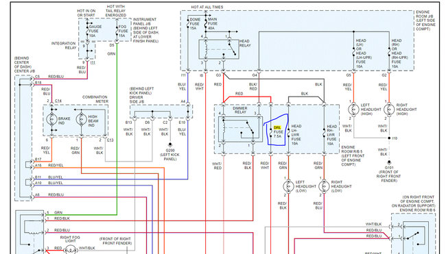

Good morning, the vehicle day time running light not functioning, I have checked the fuse and relay. What could be the cause or any troubleshooting guides for it?
Oct 22, 2020 at 8:48 PM
  • 110,194 POSTS
There are a couple of relays to check. The one mounted on the radiator support is where I would start. I don't know if that is the one you have already checked or not.

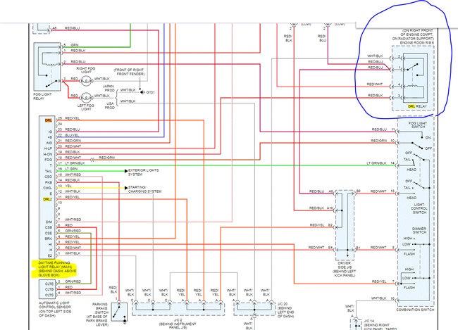

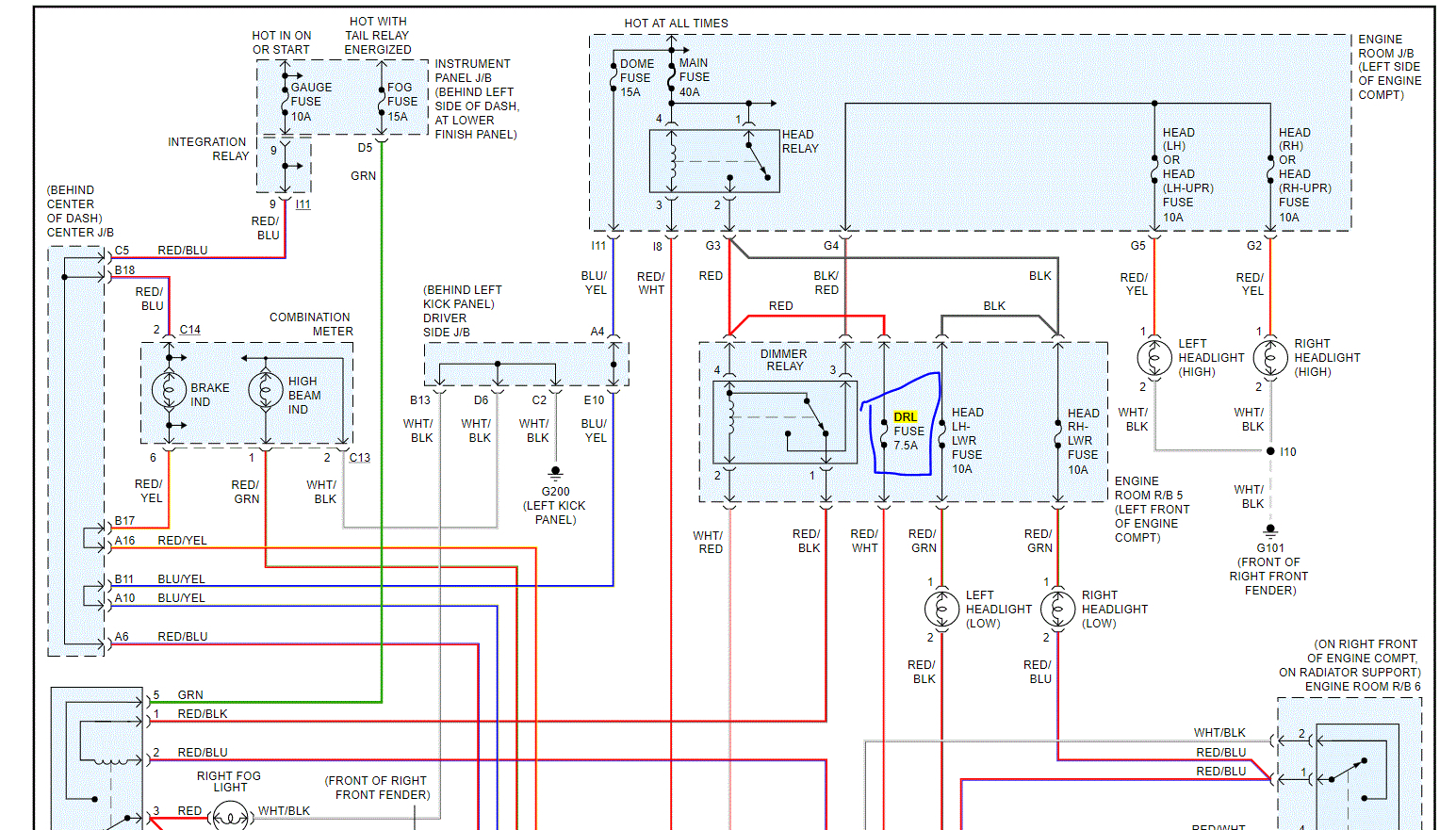

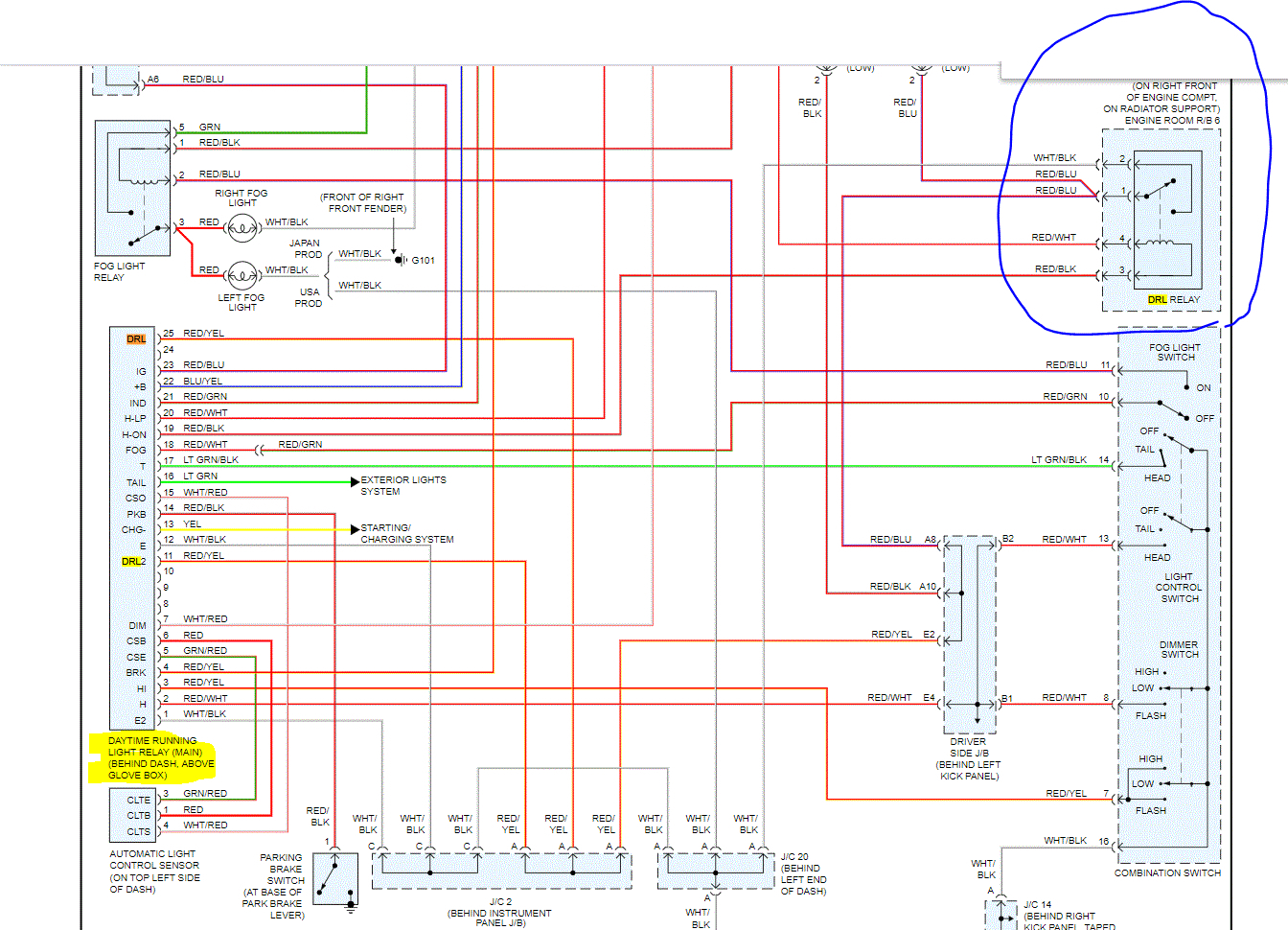

I attached two pics below. They show the entire headlamp / DRL wiring schematic. I highlighted everything related to the DRL. Note the fuse. Is that also the one you checked?
I'm not sure how the relay was tested, but here is a link that shows how it's done:
Also, in addition to checking the fuse, confirm there is power to and from it.

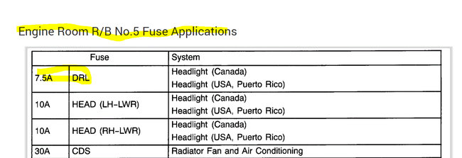

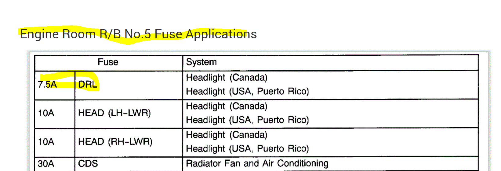

Pic 3 indicates DRL fuse number and placement in the under hood fuse box.

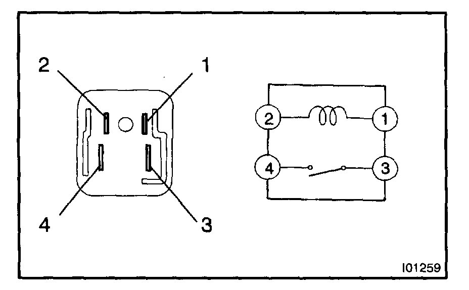

Here are directions specific to your vehicle for testing the relay.
_______________________

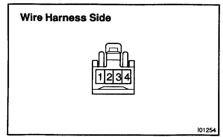

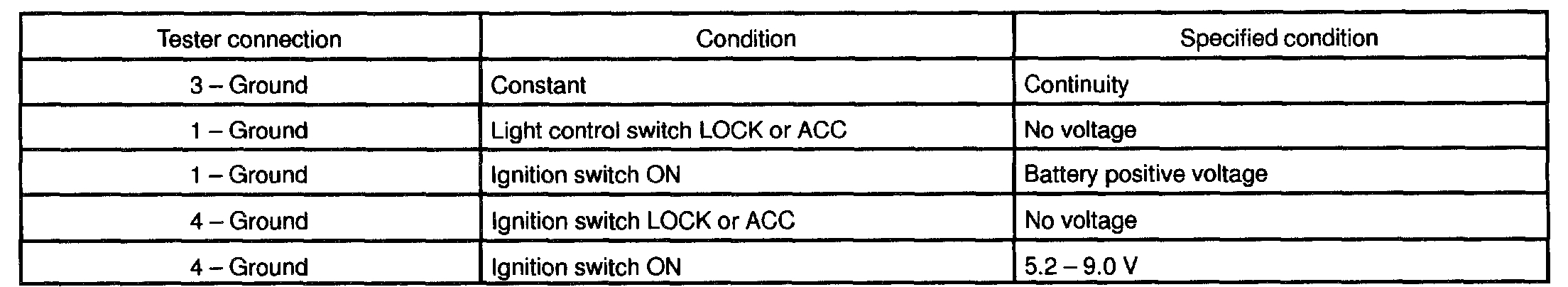

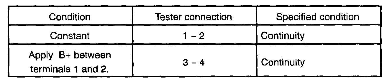

7. USA, Puerto Rico models: INSPECT DAYTIME RUNNING LIGHT RELAY (MAIN) CIRCUIT
Disconnect the connector from the relay and inspect the connector on the wire harness side.
If circuit is specified, try replacing the relay with a new one. If circuit is not as specified, inspect the circuits connected other parts.
See pic 4 and 5

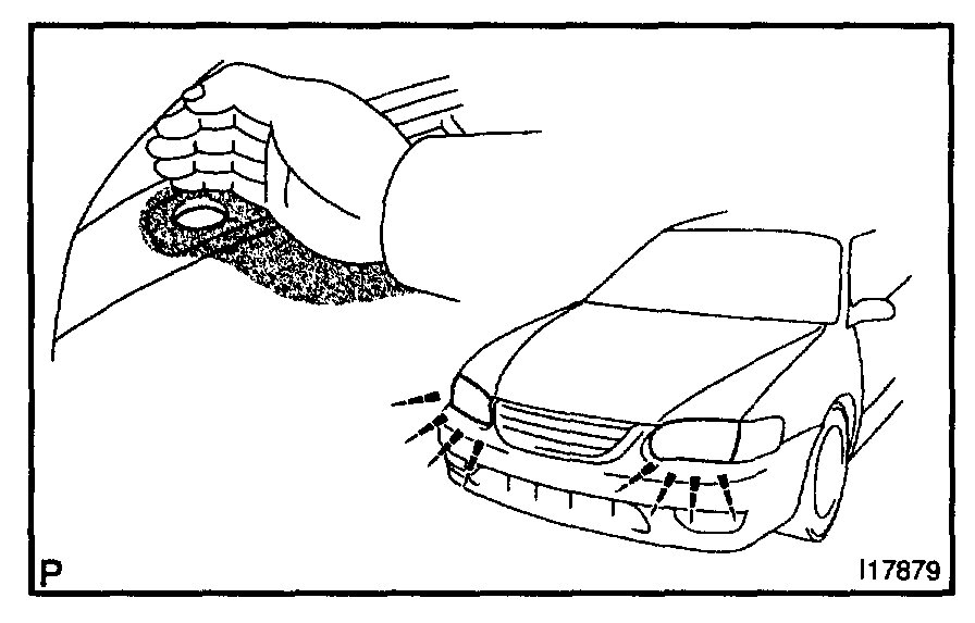

9. USA, Puerto Rico: INSPECT AUTOMATIC LIGHT CONTROL
a. Turn the ignition switch ON.
b. Turn the light control switch to OFF.
c. Parking brake lever released.
d. Gradually cover the top of the sensor.
e. Verify that the lights should turn ON the accessory lights and the headlights.
pic 6
10. USA, Puerto Rico: INSPECT AUTOMATIC LIGHT CONTROL
d. Cover the top of the light sensor.
e. Head and tail lights turn ON.
f. Gradually expose the light sensor.
g. Tail light turn OFF and DRL light turn ON.

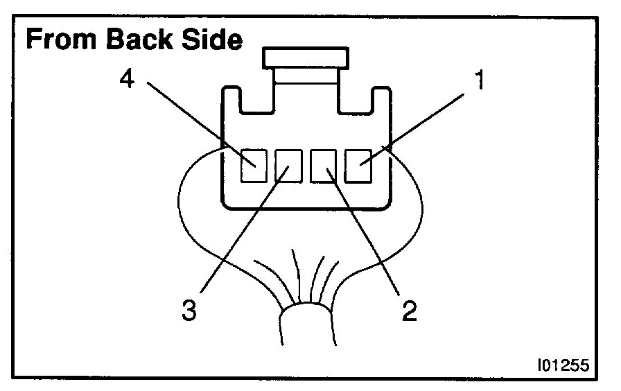

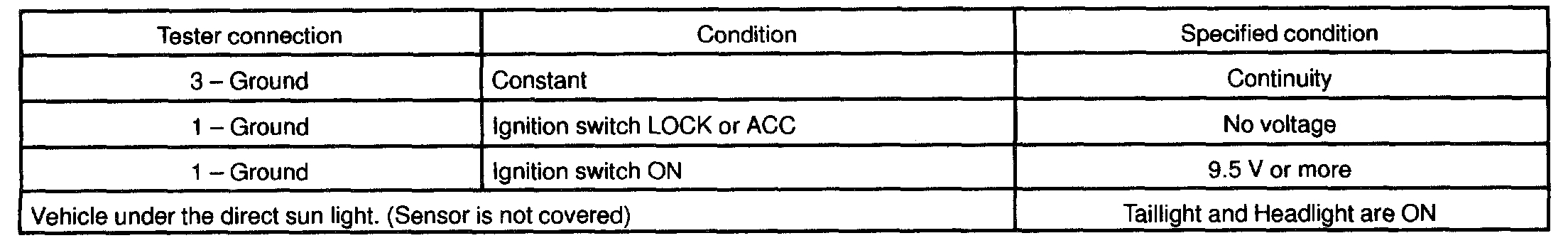

13. USA, Puerto Rico: INSPECT AUTOMATIC LIGHT CONTROL SENSOR CIRCUIT
pic 7
pic 8
a. Disconnect the connector from the sensor and inspect the connector on the wire harness side, as shown in the chart.
If circuit is as specified, perform the inspection as follows.
If the circuit is not as specified, inspect the circuit connected to other parts.
pic 9
pic 10
b. Connect the wire harness side connector to the sensor and inspect wire harness side connector from the back side, as shown.
HINT:
- Ignition switch ON.
- Light control switch AUTO.
- Vehicle's surroundings are bright.
If circuit is as specified, try replacing the sensor with a new one. If the circuit is not as specified, inspect the circuit connected to other parts.
