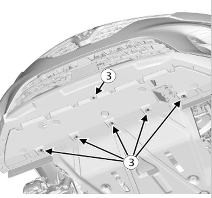

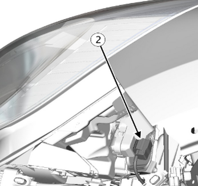

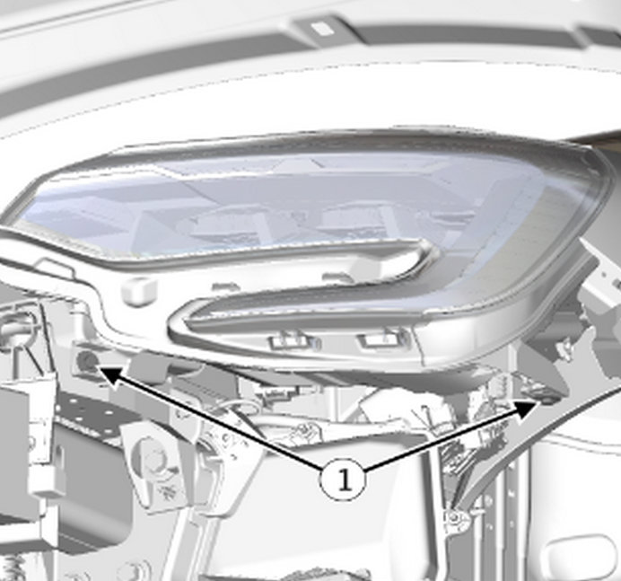

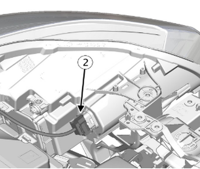

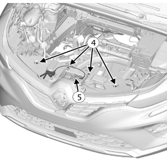

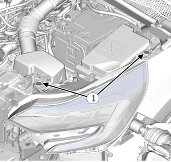

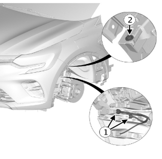

I damaged the lens on my daytime running lights (drivers' side). I have purchased the new unit to fit. Can I replace this through removing the wheel and going through the wheel arch? Or does the bumper have to be removed?

On your model Captur the front bumper will need to be removed.
To remove front bumper:
Jack up vehicle in front.
Secure with suitable axle stands.
Remove front wheels.

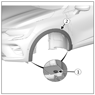

Remove front wing extensions-image 1.
There are 2 bolts, remove those then unclip extensions.
Remove both wheel arch liners- see image 2.
Remove
Front wheel arch liner bolts.
Front wheel arch liner clips.
Front wheel arch liner.

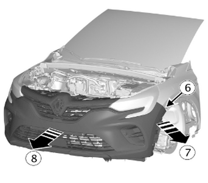

Disconnect the front bumper wiring connectors (1).
Remove the side screw (2) on each side-See image 3.

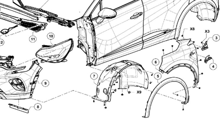

Remove lower deflector screws- image 4.
Remove the front bumper upper screws (4).
Unclip the bonnet opening cable sheath stop (5) from the opening element lock.
See image 5.
Unclip the front bumper by pulling at (6) in the direction of the arrow (7).
Slightly lift the upper section of the front bumper.
Remove the front bumper following the direction of the arrow (8). (This operation requires two people). See image 6.

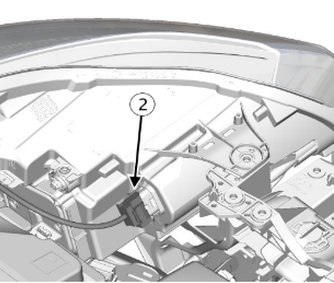

Remove upper and lower headlight bolts- see images 7+8.
Disconnect both electrical connectors- see images 9+10.
Transfer any control modules and adjuster motors- if applicable.
Assemble in reverse order.
