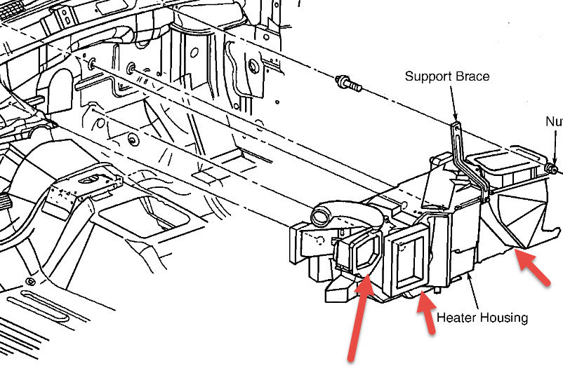

My daughter popped off the vent cover in my SUV and threw my keys down it. I got the dash ripped off and have followed it down to the floorboard. Is there a "final resting" place in which my keys may be located?

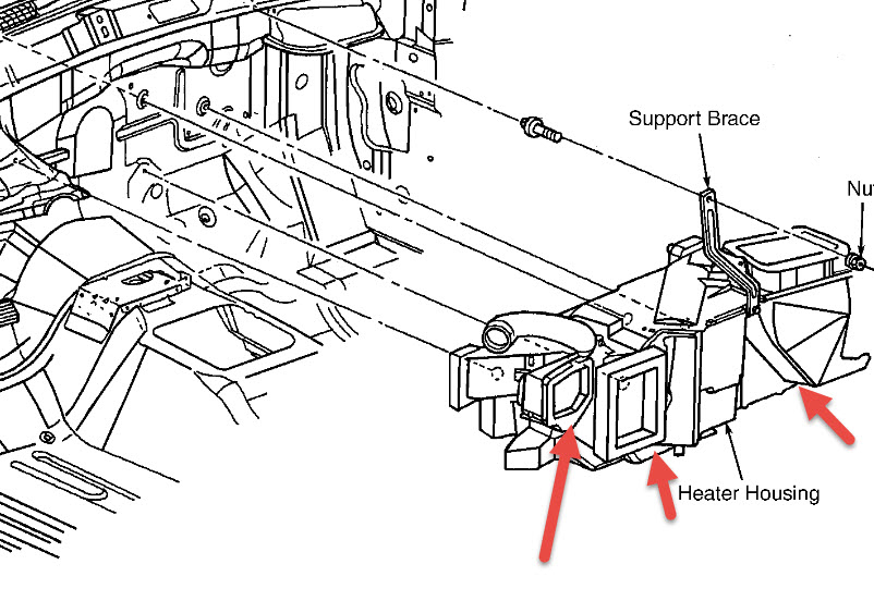

see picture and try a flexible magnet first as they are smaller. it also depends on which vent it went into.
