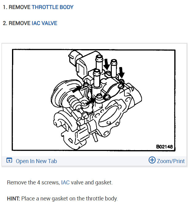

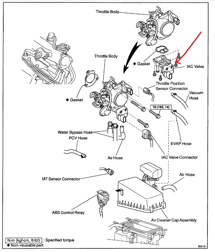

Question, my vehicle listed above is imported from Japan to Australia, engine 3S-FE, has a DLC1 in the engine bay, and gave a trouble code 33 which I think may be for the Idle Air Control Valve. Can you say whether it is please.
My name is Robert O'Sullivan.
Jul 15, 2024 at 4:10 PM
  • 55,418 POSTS
trouble code 33 typically refers to an issue with the Idle Air Control Valve (IACV). This code generally indicates a problem with the IACV circuit or the valve itself. Here is the location of the valve so you can check it out. I would look at the wiring and connector and if it looks okay replace or clean the valve. Check out this video as well:
https://youtu.be/JZoEb_hyWC8?si=G7KqreelYZP7s_uS
Check out the images (below). Let us know what you find.
