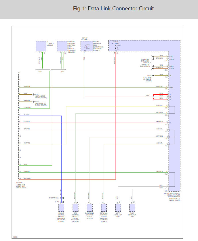

I could not connect with c4 Xentry DAS.
It shows that there is a problem in circuit 30 and 31.
Apr 20, 2018 at 1:45 AM
Experienced Mechanic
55,583 POSTS
I would check fuse 4 and 82, here is a guide to help and the ALDL wiring diagram so you can see how the connector works.
