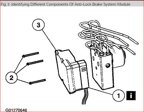

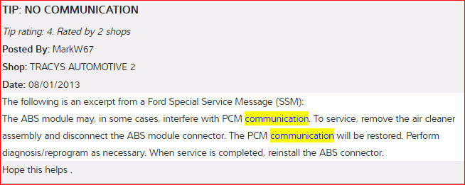

I bought a ob1 and obd scanner and I hooked it up to mine and the single wire to test sti wire is missing because when I use the scanner it keeps saying check dlc.
Jul 4, 2018 at 7:40 AM
DANNY L
  • 5,648 POSTS
Hello, I am Danny.
Here is something I found about non-communication. I have attached two pictures about testing and location. Hope this helps! Thanks for using 2CarPros and let us know if you have any other questions.
