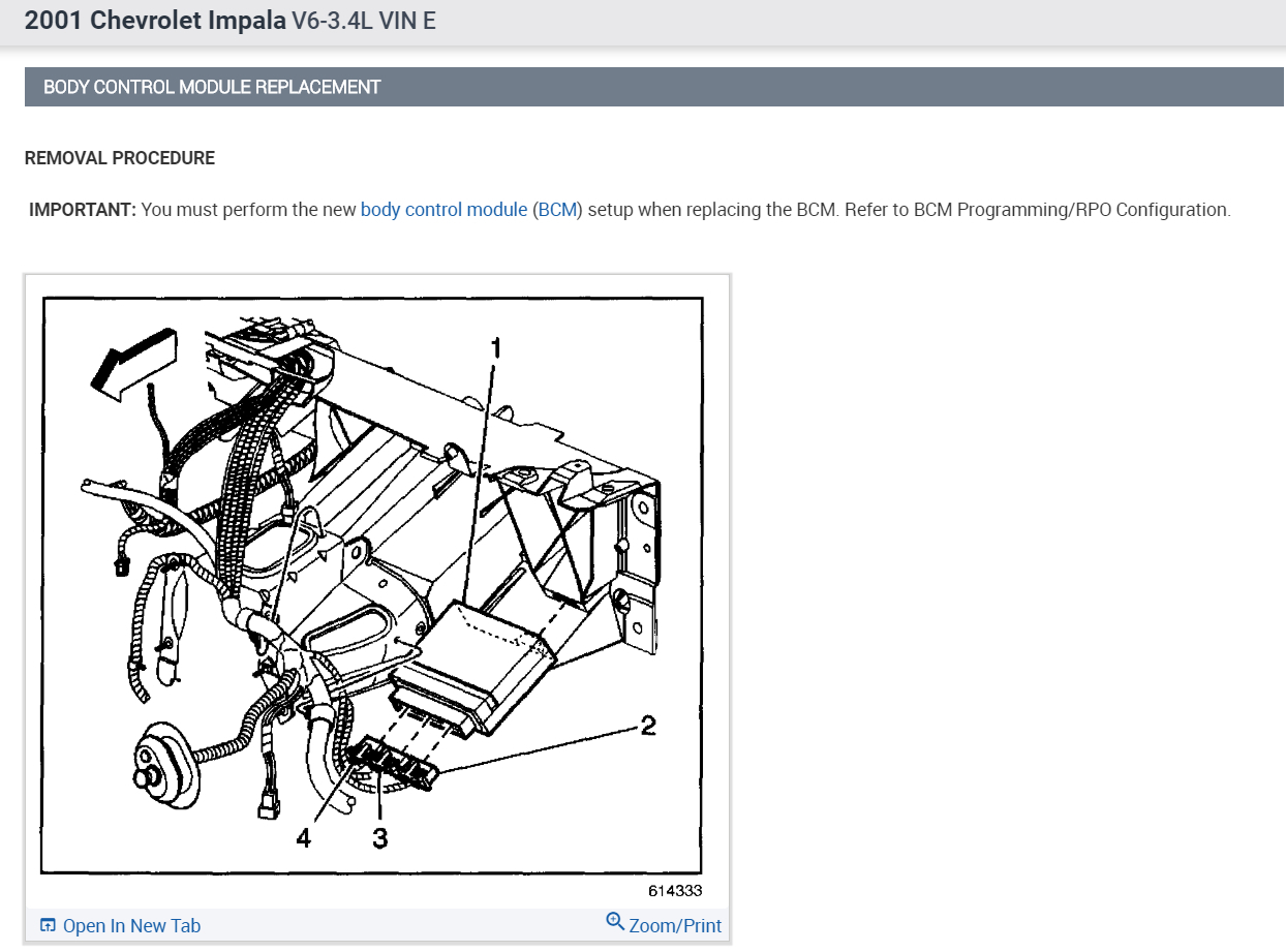

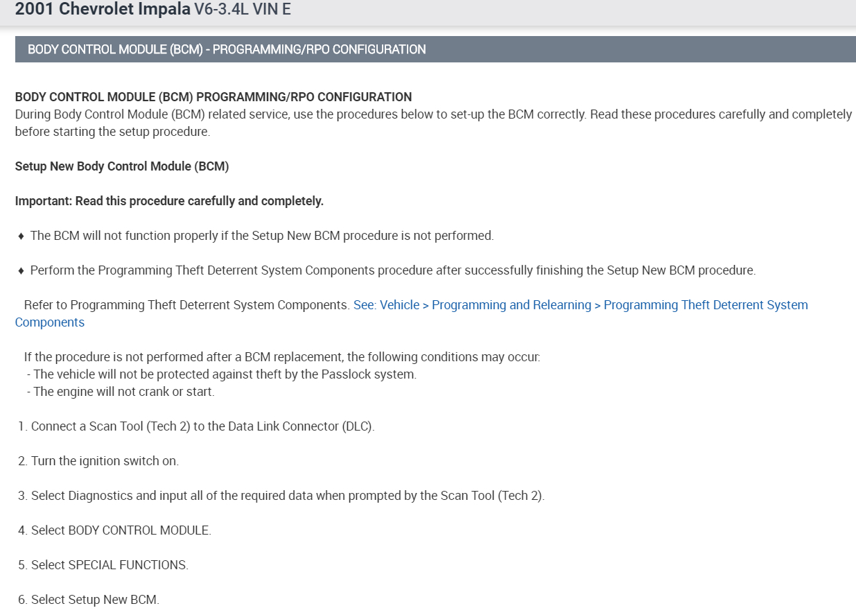

During the day the lights for the odometer and stuff don't go on. But as soon as night arrives they turn on.

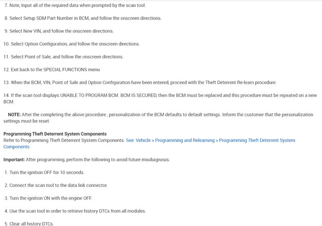

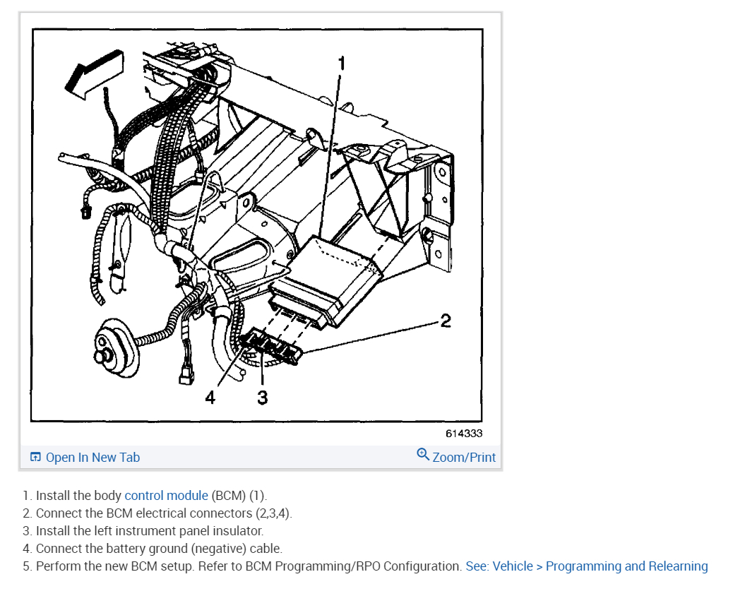

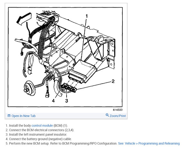

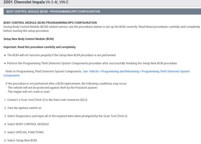

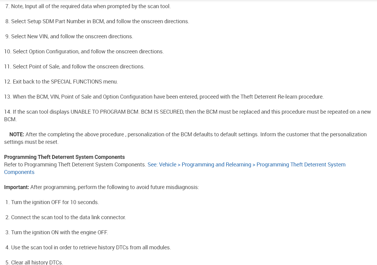

The BCM controls the lighting to the cluster it must have gone out here is how you replace the BCM in the diagrams below. Check out the diagrams (below). Please let us know what happens.
