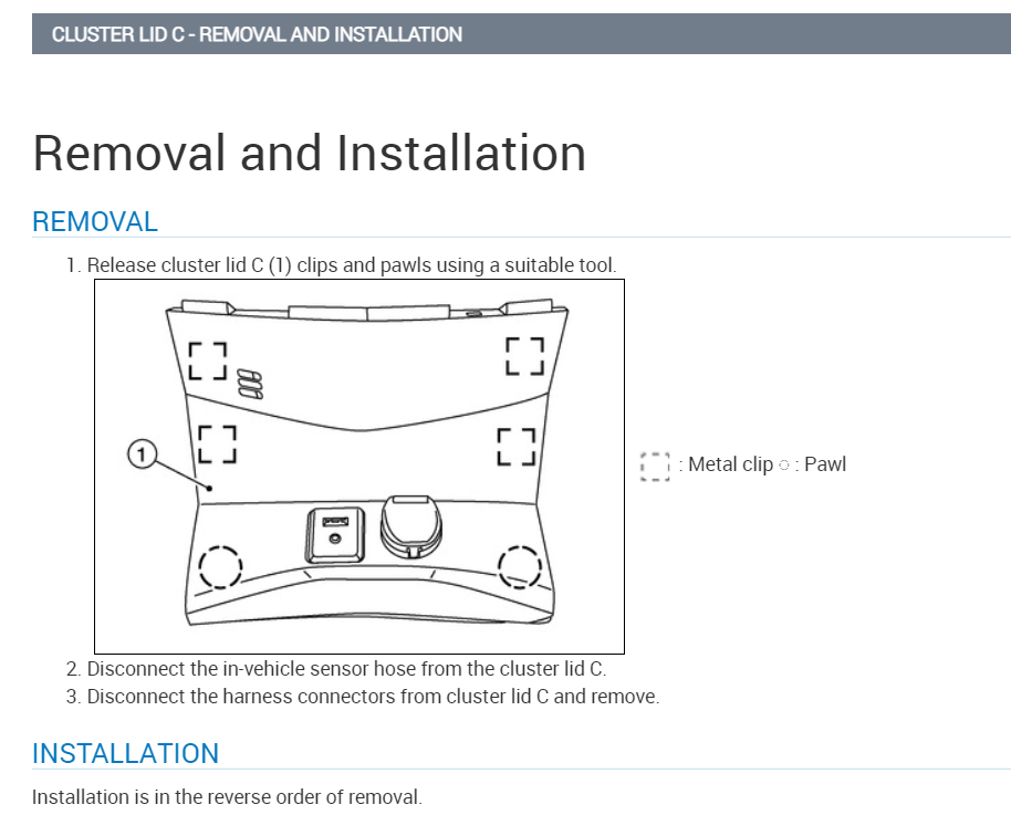

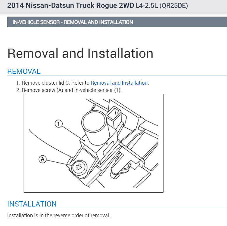

Why would the outside temperature light be flashing on the dashboard?
Dec 23, 2022 at 9:19 PM
  • 55,399 POSTS
This means there is no input from the temperature sensor, or it is not hooked up. Here is the location so you can check it out. Check out the images (below). Please let us know what happens.
