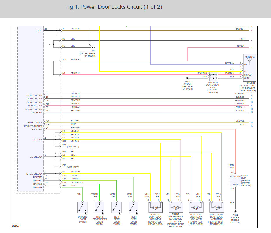

So I started my car this morning and the dashboard notification was saying my back right door was open. So I opened it and closed it and the notification didn’t go off. So the interior lights wouldn’t go off. So I pulled out the fuse for the interior lights problem solved. So I started up the car, now the right front and back door open notification came on. So I continued driving and put my seat belt on and when I did that both dashboard notifications went off. Any help would be appreciated

Hi Danny, thank you for getting back to me. I failed to mention, I drove through some pretty deep water and I’m hoping it’s not electrical issues.

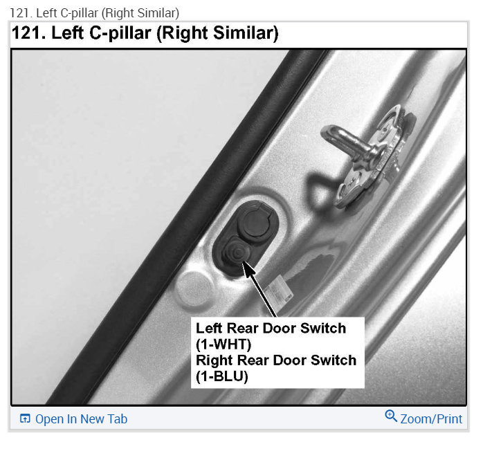

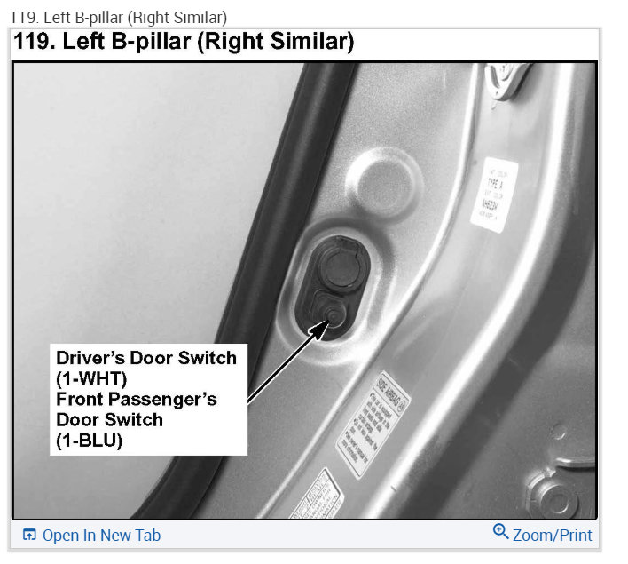

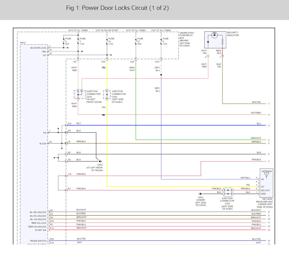

The system is run by door switches. Check to see if the switch is okay and has not lost the rubber piece. Here is what they look like and the wiring diagrams so you can see how the system works. Check out the diagrams (below). Please let us know what you find. We are interested to see what it is.
