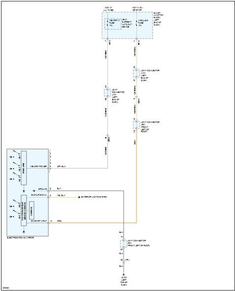

I was replacing rear view mirror to install a pro cam the wires touch each other and blew out my dashboard gauge components. Also my vehicle will not change gears.

Which motor does your Santa Fe have the 2.0 turbo, 2.4l or the 3.3l?
What color were the wires that touched each other?
Let me know and I will get the info for you on that ckt. Did you check all the fuses in the car yet?

Here is the diagram for the mirror looks like there is fuses that could have popped.
