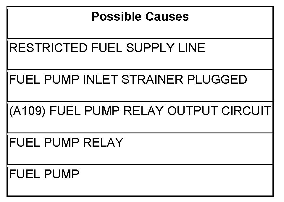

I'm not sure how the two would be related. As far as the code, it is for a lean fuel mixture. Most times, it is caused by an engine vacuum leak, an exhaust leak, or a weak fuel pump. With that code, the catalytic converter is most likely fine.
Lets start with the code issue. First, are there any exhaust leaks? If not, then follow this link to check for engine vacuum leaks.
If none are found, then check fuel pressure.

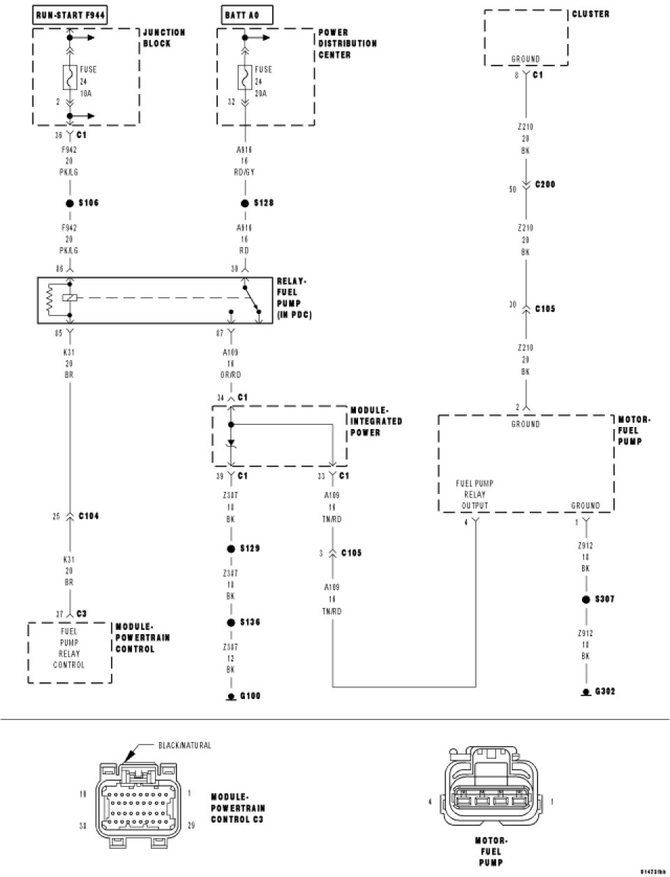

Here are the directions specific to your vehicle for testing fuel pressure. The attached pictures correlate with the directions, and the manufacturer's specs are included. Also, the directions include a flow chart if you find the pressure is low. However, they will require a scan tool to complete.

*CHECKING THE FUEL DELIVERY SYSTEM
pic 1
For a complete wiring diagram refer to Diagrams/Electrical.
pic 1

5. (A109) FUEL PUMP RELAY OUTPUT CIRCUIT OPEN
Turn the ignition off.
Remove the Fuel Pump Relay from the IPM.
Disconnect the Fuel Pump Module harness connector.
Measure the resistance of the (A109) Fuel Pump Relay Output circuit from the relay connector to the fuel pump module connector.
Is the resistance below 5.0 ohms?
- Replace the Fuel Pump Relay.
- Perform the POWERTRAIN VERIFICATION TEST. See: A L L Diagnostic Trouble Codes ( DTC ) > Verification Tests > Powertrain Verification Test
- Repair the open in the (A109) Fuel Pump Relay Output circuit.
