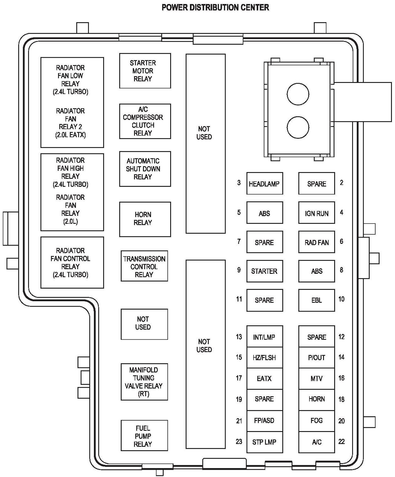

Dashboard lights and lights by gear shift went out
2005 DODGE NEON
100,000 MILES
BRIAN BEDDOR
It still shows mileage though. I am thinking it is a fuse but cannot figure out which fuse it is. Can anyone tell me what fuse?

First, check fuse 13 in the power distribution box under the hood. See picture 1. Also, here are a couple links that may be helpful:
