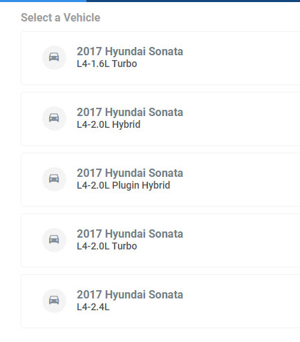

Additionally, I need the correct engine size. There are several options but all are 4-cylinder. (See pic below) I need to know so I can look at the correct charging system wiring schematics.
See pic below.

It’s 2017 L4- 2.4L

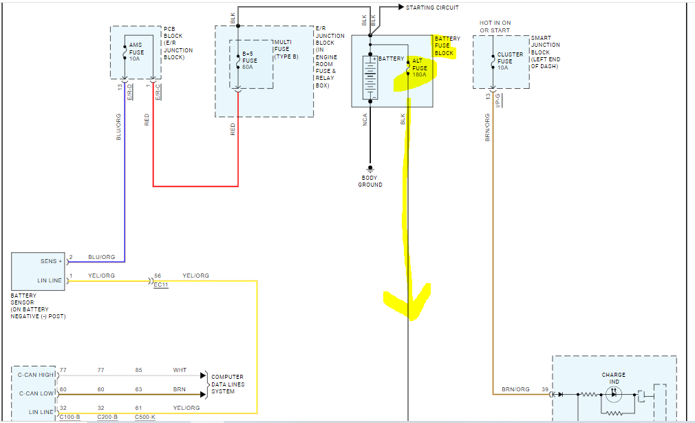

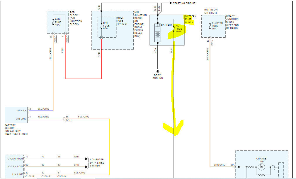

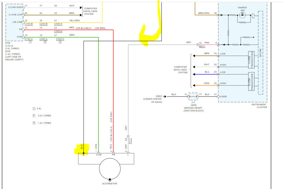

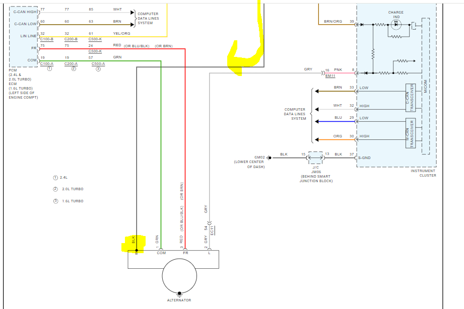

Did you have a chance to perform the aforementioned test on the alternator? If so, let me know the results.
Also, at the alternator, there will be a black wire. That wire should have voltage at all times. I need you to check that for me. Just be careful not to short it to anything.
I attached the wiring schematic below so that you have a reference. Note the black wire is fused by a 180-amp fuse right from the battery. If you find there is no power at the alternator, confirm that fuse is good.
Let me know what you find.
