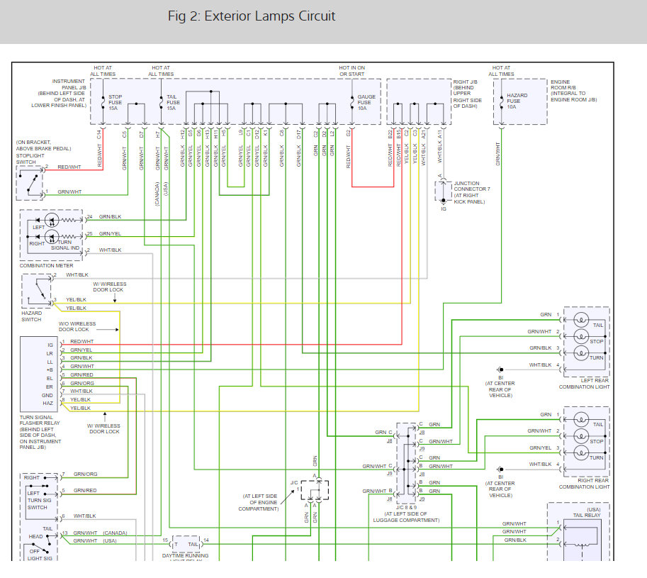

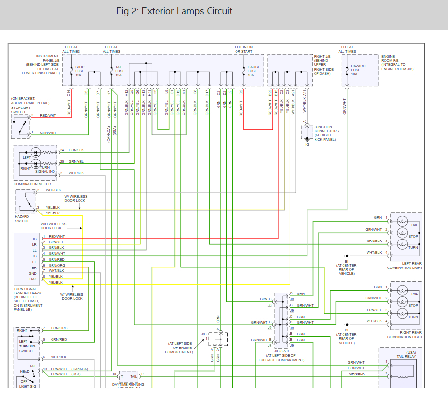

The person I had look at it said the fuses were okay. What else could it be? Will changing the headlight switch fix the problem with my dashboard lights?
Thursday, August 1st, 2019 AT 3:01 PM
22 Replies
KEN L
  • MASTER CERTIFIED MECHANIC
  • 54,364 POSTS

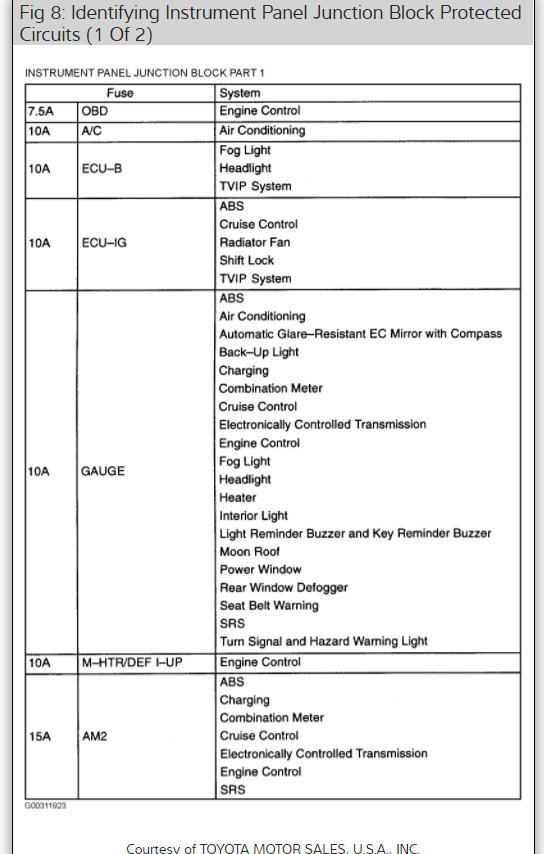

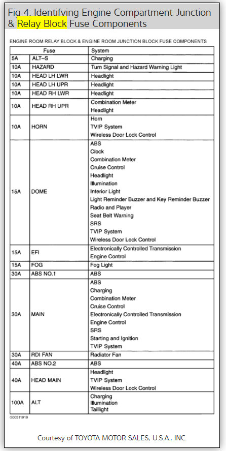

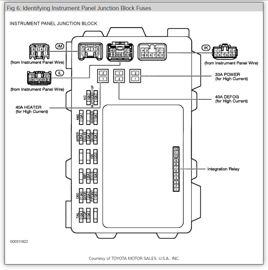

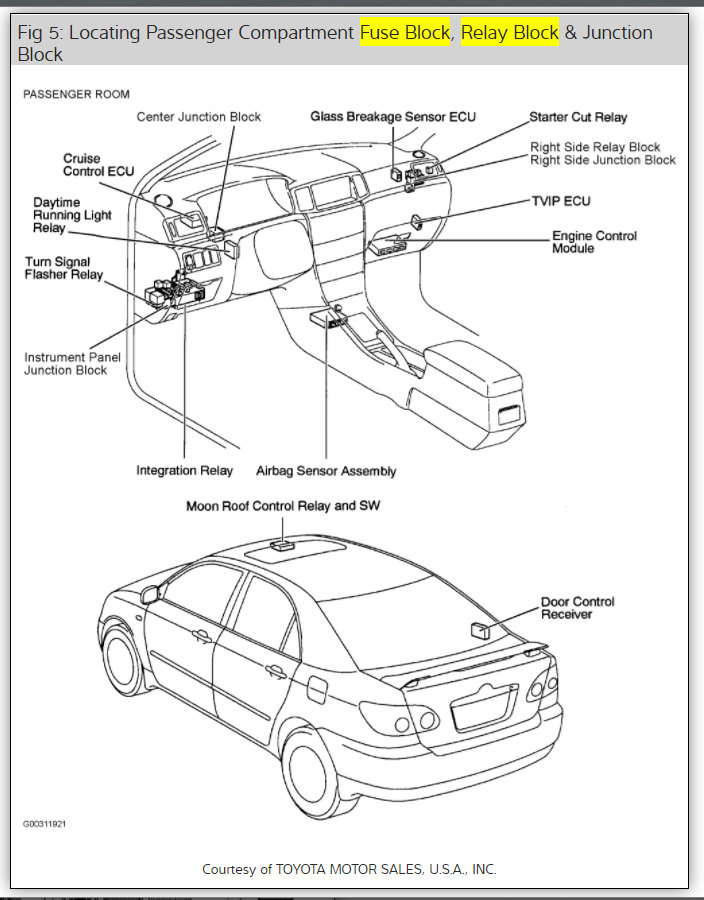

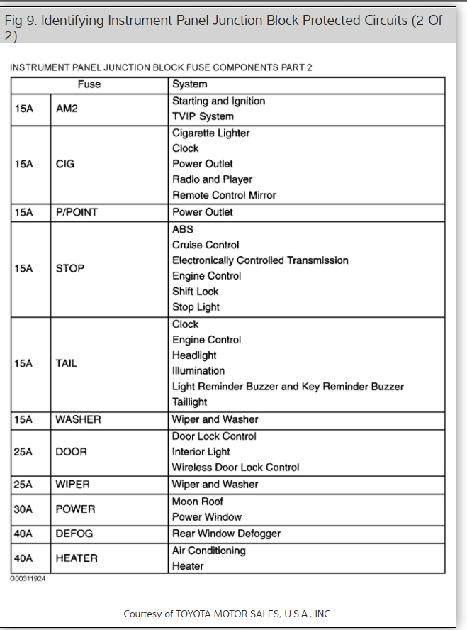

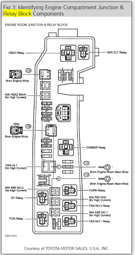

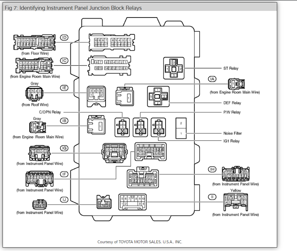

There are two fuses and a tail light relay that needs to be checked first. Here are two guides and the fuse with relay location plus the lighting diagrams for the system so you can see how it works and which fuses to check.
and
Check out the diagrams (Below). Please let us know what you find. We are interested to see what it is.

It was the relay for my car cost $32.00 for a new relay

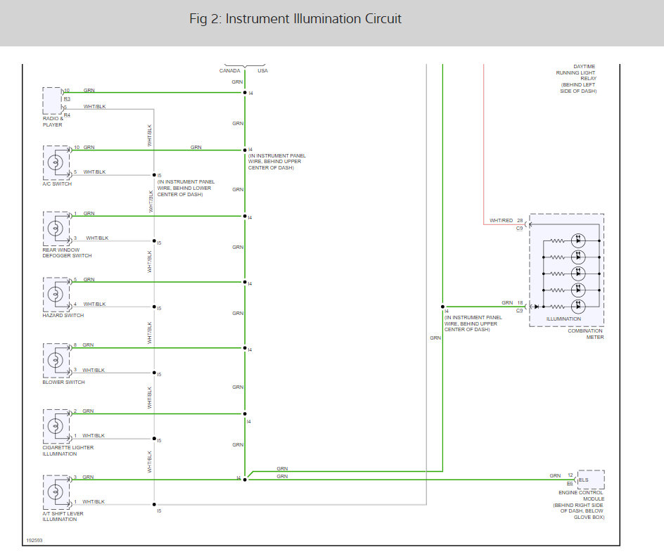

Dash lights are related to taillights and front combination lights, check if they are working.
You should check the T-light relay.

So its the AC in the same circuit as the dash and the tail lights?
Cause when I press the AC botton it should turn green to indicate its on, so it does nothing
thank you
Friday, January 3rd, 2020 AT 4:35 PM (Merged)
KHLOW2008
  • 41,814 POSTS
Hi esaenz,
I am not sure but for most models it is not the same circuit.
Repair the lights first and see if the AC comes on.

You have to remove the IP (instrument panel) to replace lights. Some lights on Toyotas come as an assy. (Light and base).
It would be best to use the car repair manual link in this thread or get a Haynes manual.

Dash bulbs are plug in type, there are a few of them in the meter.
Check if front combination and rear tailights are working, they are on the same circuit.
