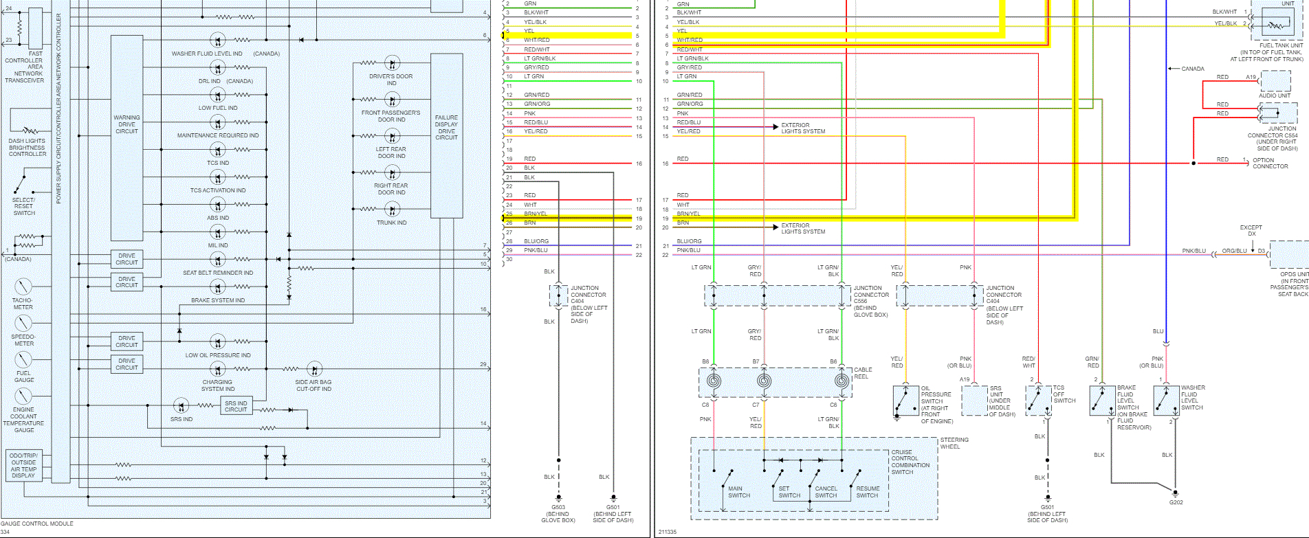

Dashboard lights are not lighting up none of the gauges are working and my turn signals do not work. I put all new fuses in the fuse box on the driver side fuse panel and I can't find any fuse labeled light or dash lights. Is it called something else in the car listed above coupe?

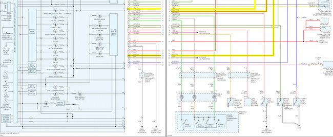

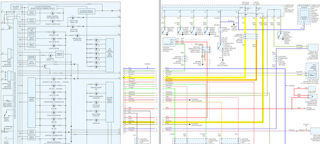

There are three fuses under the dash I need you to check.

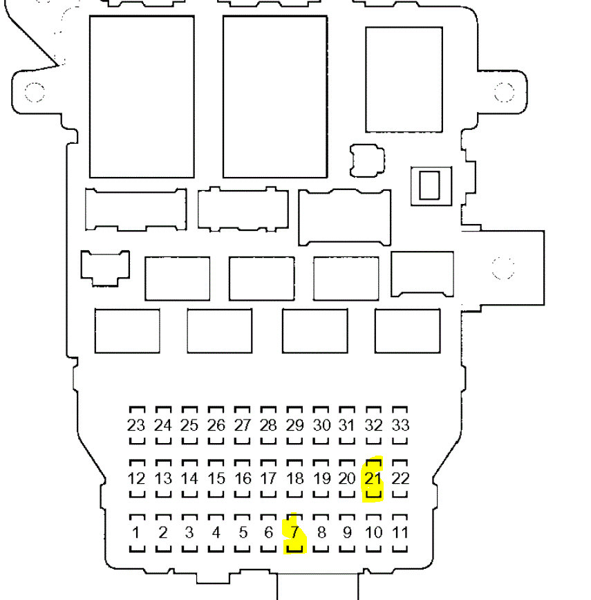

First, if you look at the pics below, I included the wiring schematic related to the instrument cluster/gauges. I highlighted two fuses I need checked. In addition to checking the fuse, confirm there is power to and from it. Pic 3 shows the fuse location in the box.

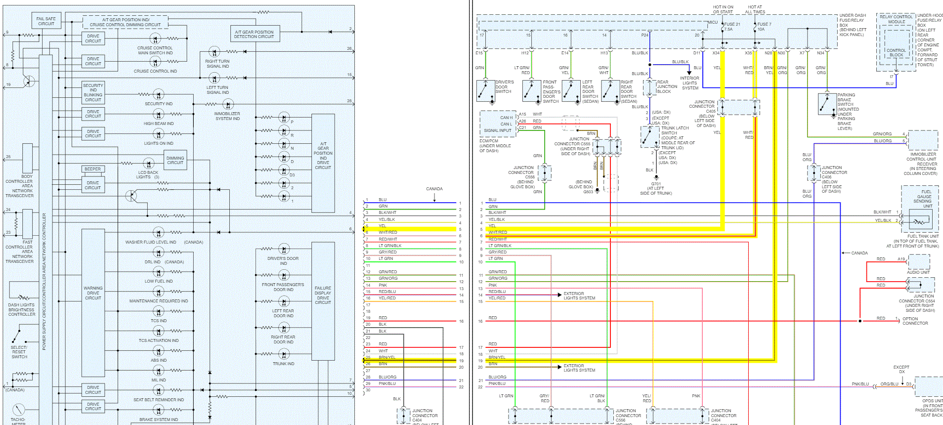

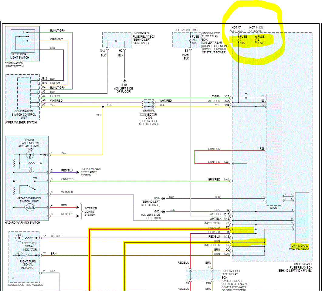

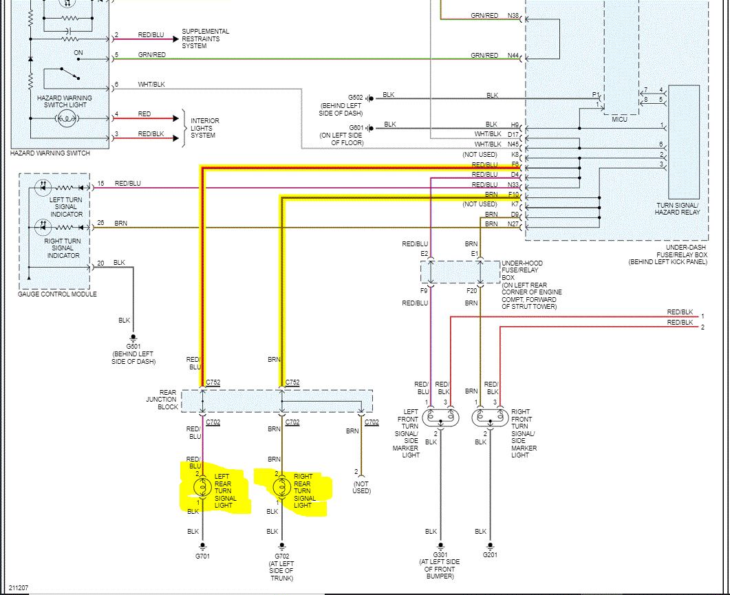

If you look at pics 4 and 5, they show how power is supplied to the signals. Note they are the same two fuses responsible for the cluster and gauges.
