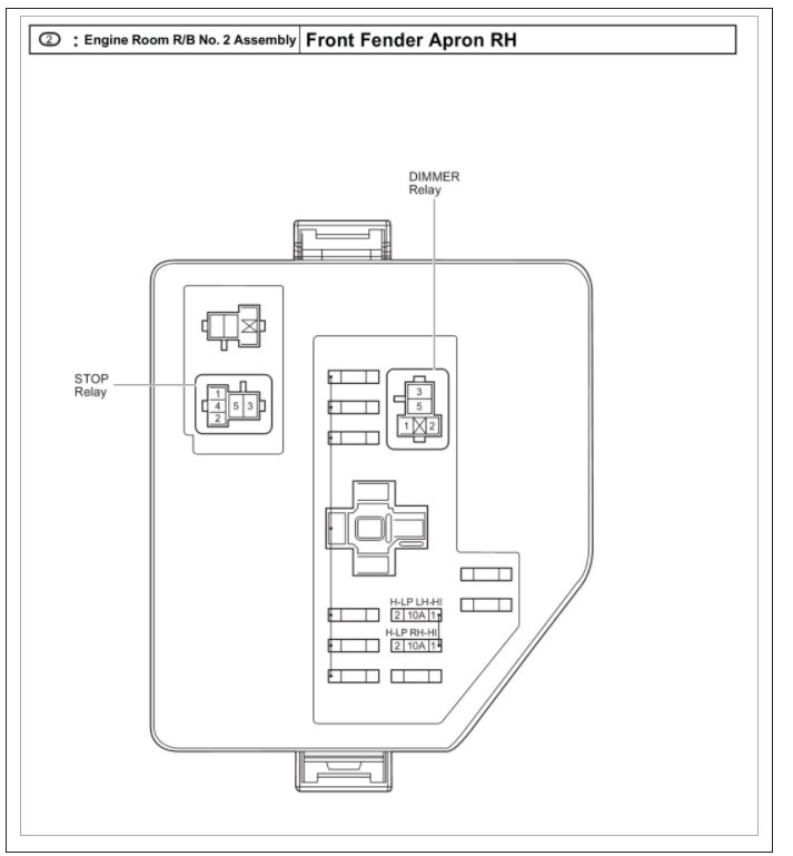

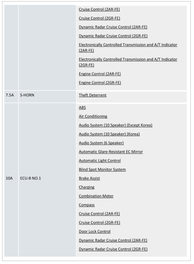

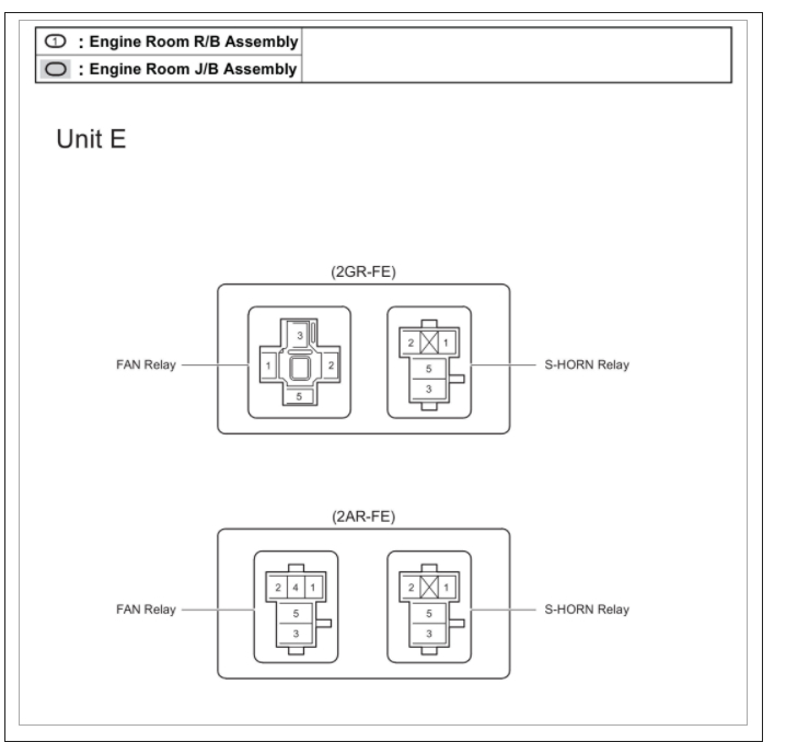

My speedometer, fuel, heater, lights are always off. I cannot see my speed and fuel level at night.
Apr 2, 2018 at 6:11 AM
KHLOW2008
Experienced Mechanic
41,812 POSTS
Check the dashlight dimmer control, it could have been turned to minimum.
Apr 2, 2018 at 6:52 PM
55,554 POSTS

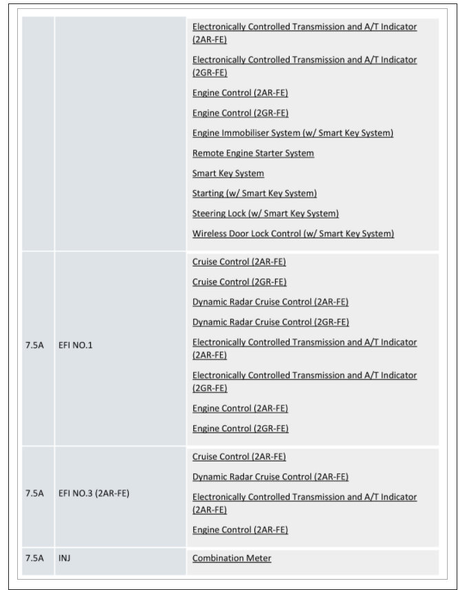

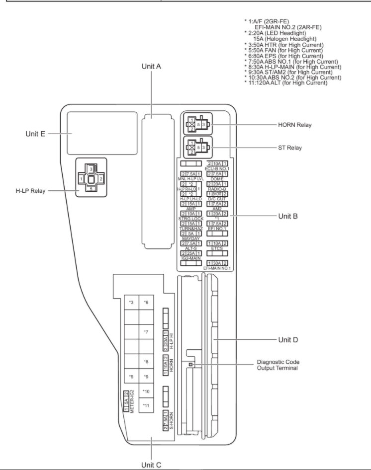

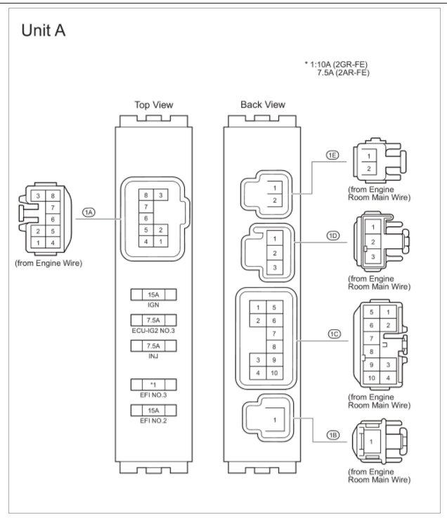

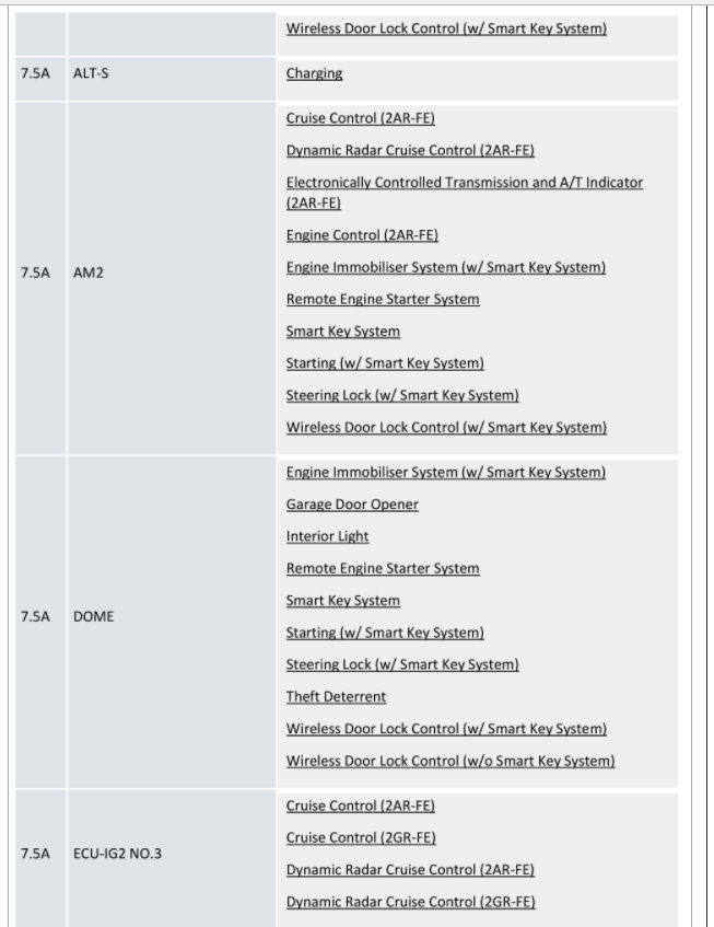

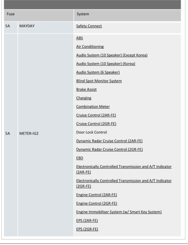

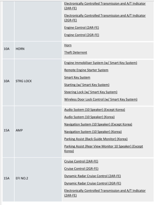

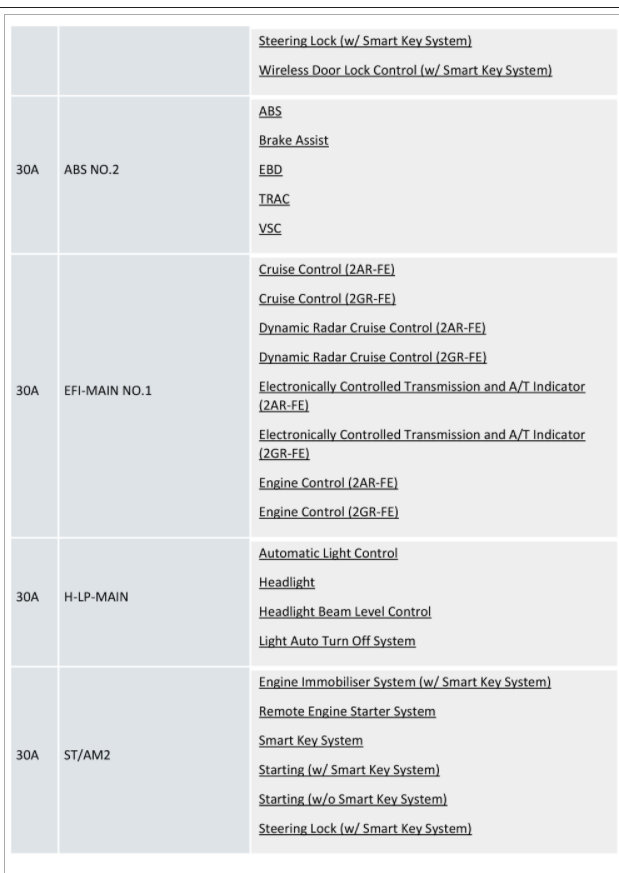

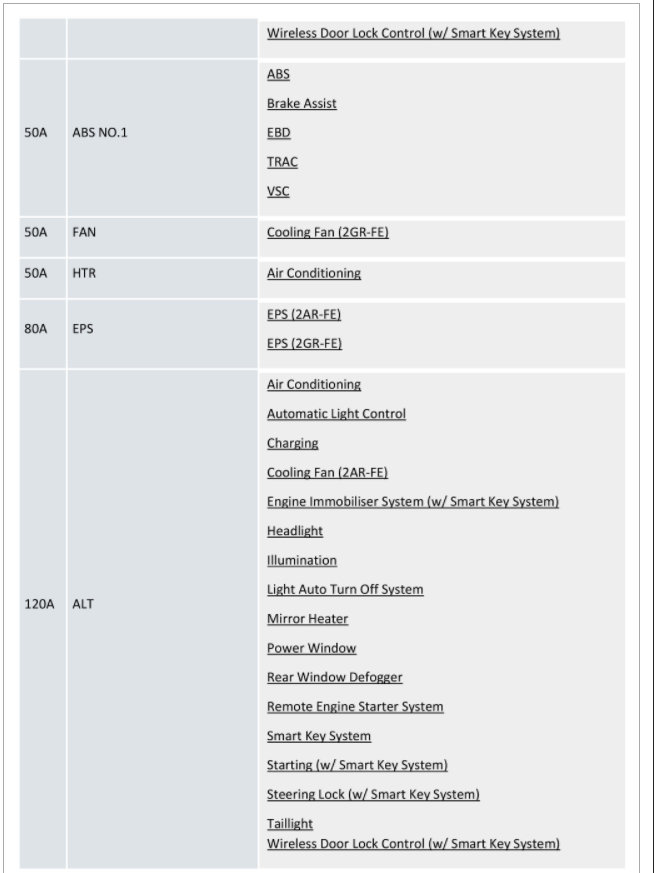

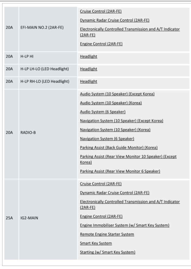

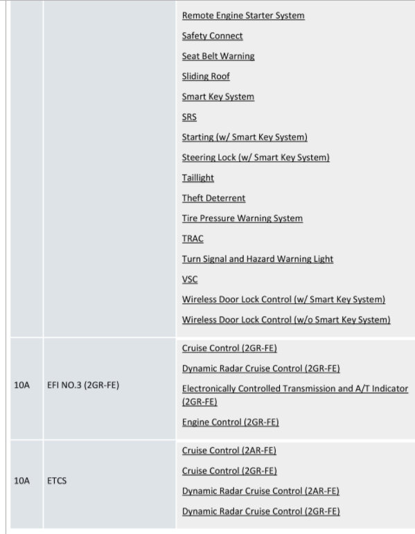

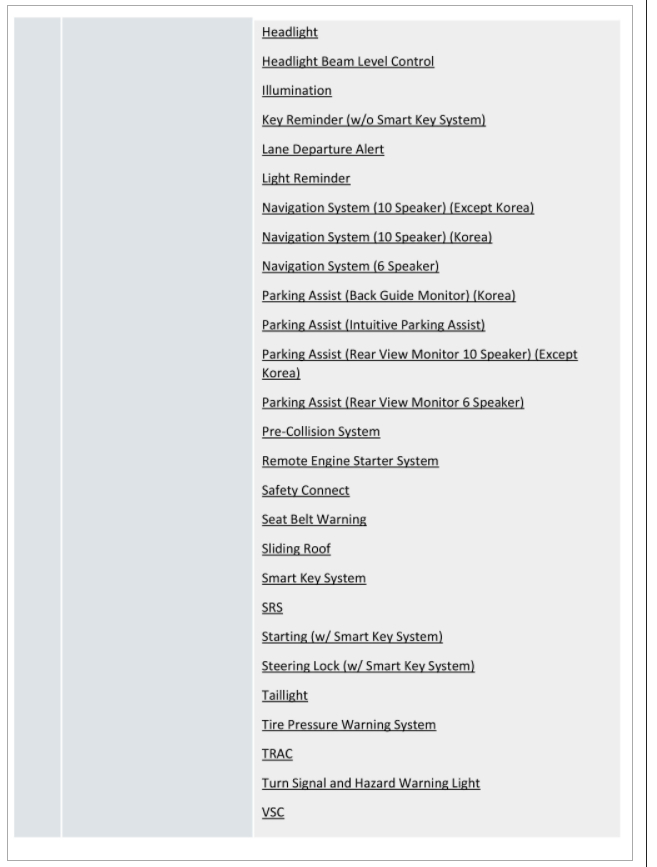

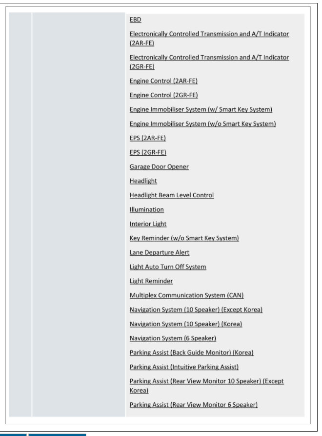

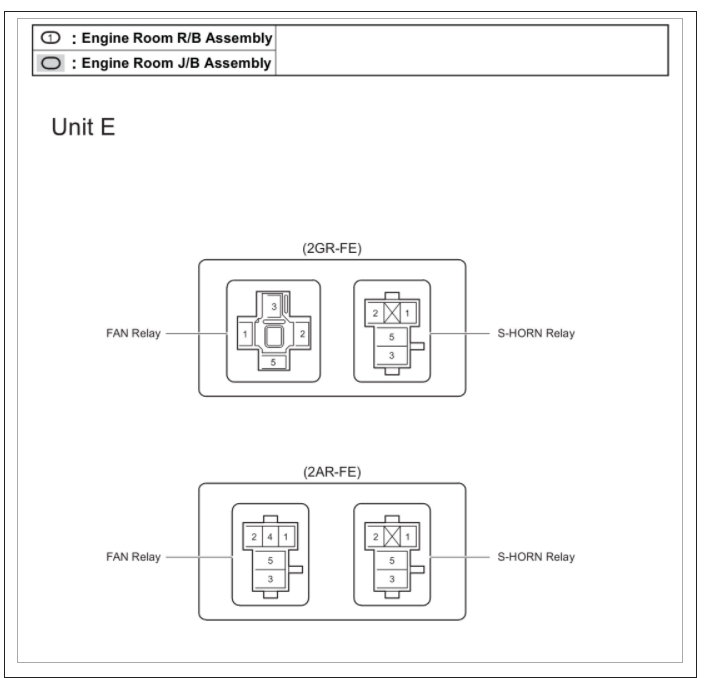

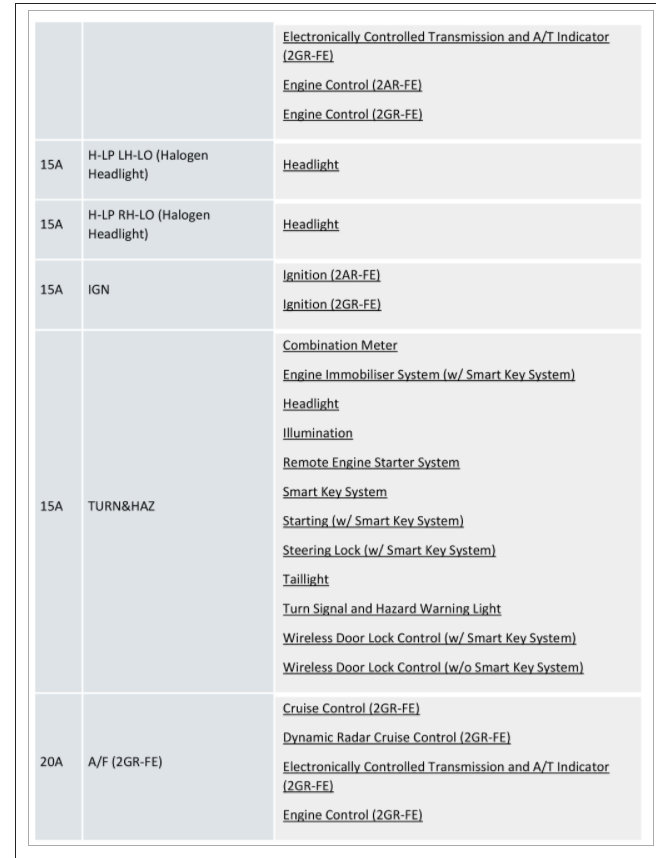

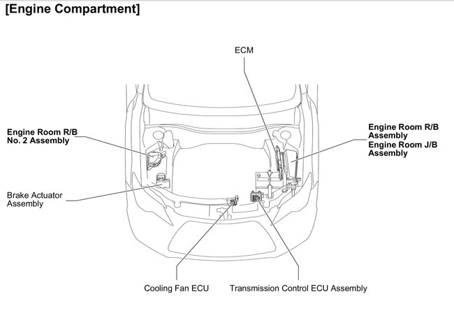

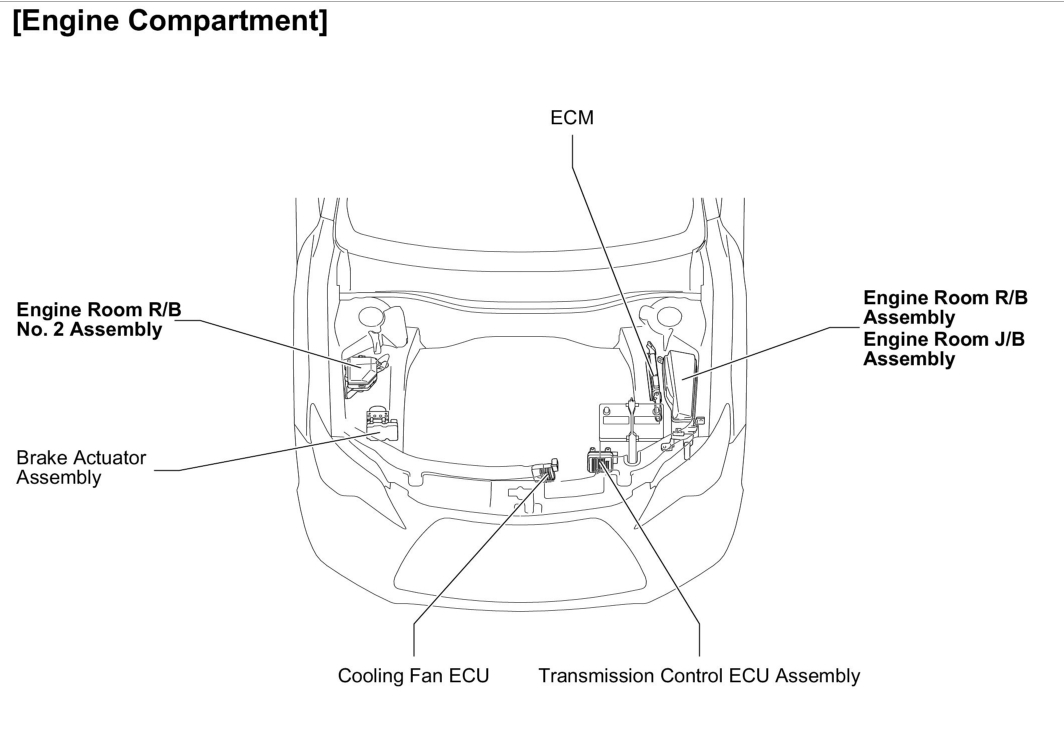

If that did not help here is a guide to help you check the fuses and the fuse panel location and identification:
