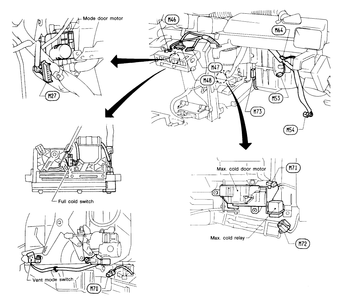

The dashboard switch that controls the speed of the heater/AC fan will not work. Actually, it works intermittently; I will press the switch until all speeds are highlighted but no air comes out. If I leave it on high, it will sometimes come on about fifteen minutes later. But sometimes it will not come on at all. How can this be repaired?

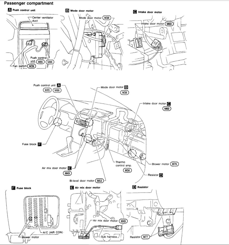

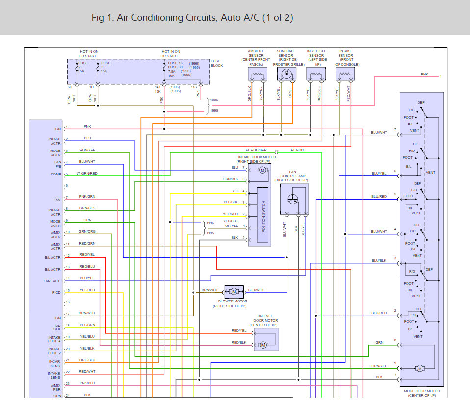

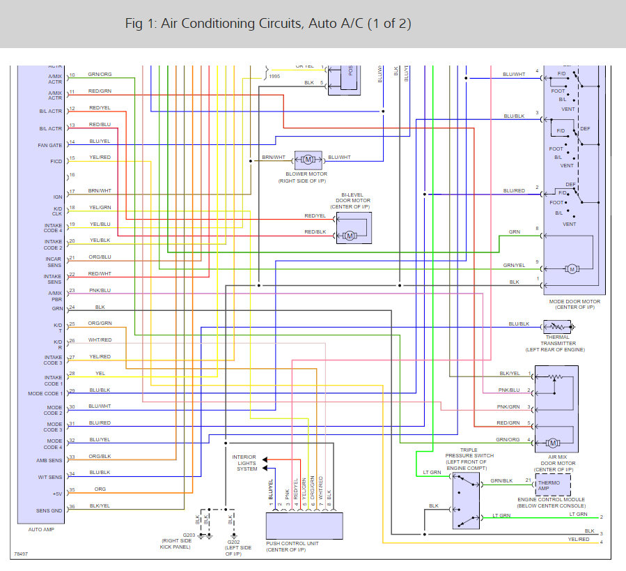

This sounds like you have a problem with the blower motor or the controller. Here is a guide to help us test and replace the blower motor:
https://www.2carpros.com/articles/blower-fan-motor-works-on-high-speed-only
Here are blower motor wiring diagrams so we can test for power loss:
Please run down these guides and diagrams and report back (below).

Could it possibly be blower resistor?
Jan 8, 2018 at 3:51 AM
  • 55,752 POSTS
Yes it could when you remove it please look for anu burn marks on the resistor which will tell you the unit is bad. If you have a question about it please upload an image of the part in question.
