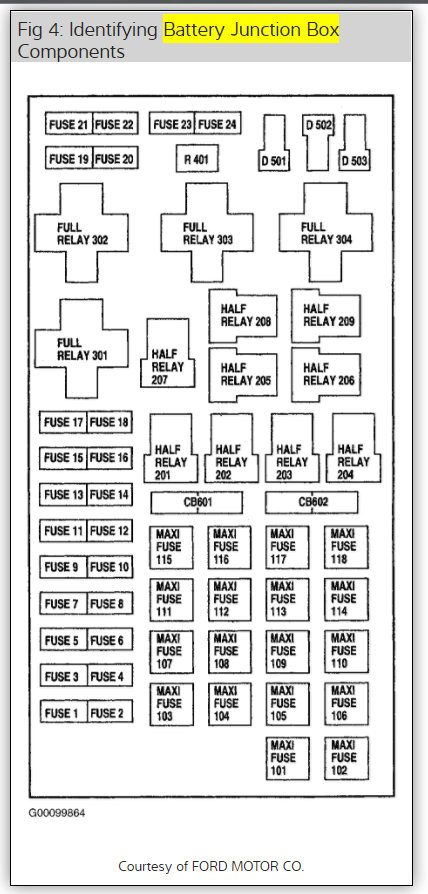

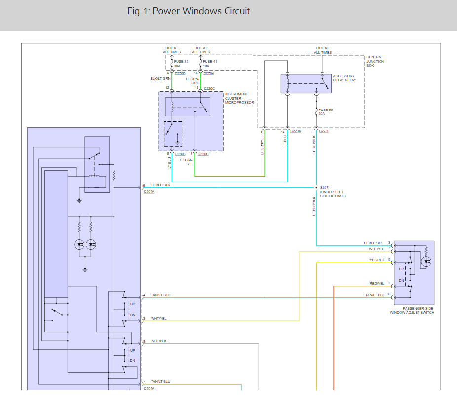

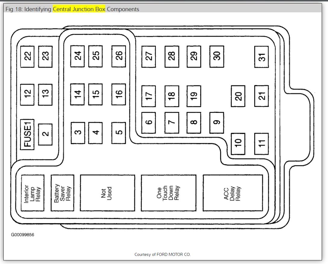

Ran through a mud puddle now my dash doesn't work in the windows won't roll down.

We need to check fuses # 35 and #41 for power. here is a guide to help us and the wiring diagrams below so you can see how the system works:
