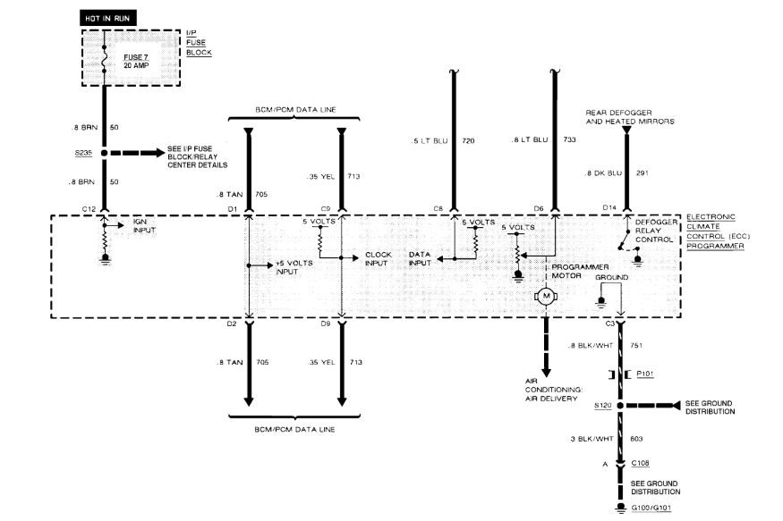

The letter c and d appear on gas gauge and A/V heater display.
Tuesday, January 7th, 2020 AT 2:57 PM
  • 52,797 POSTS
Good afternoon,
Can you post a picture of what you see to this post?

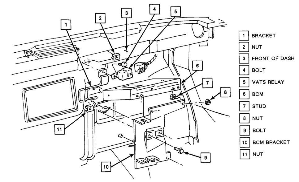

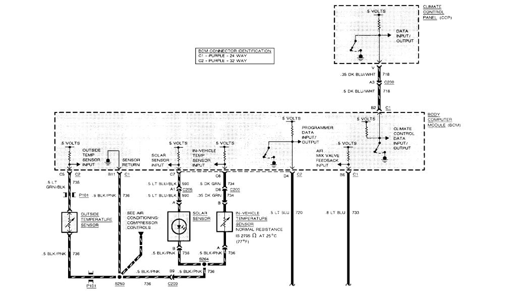

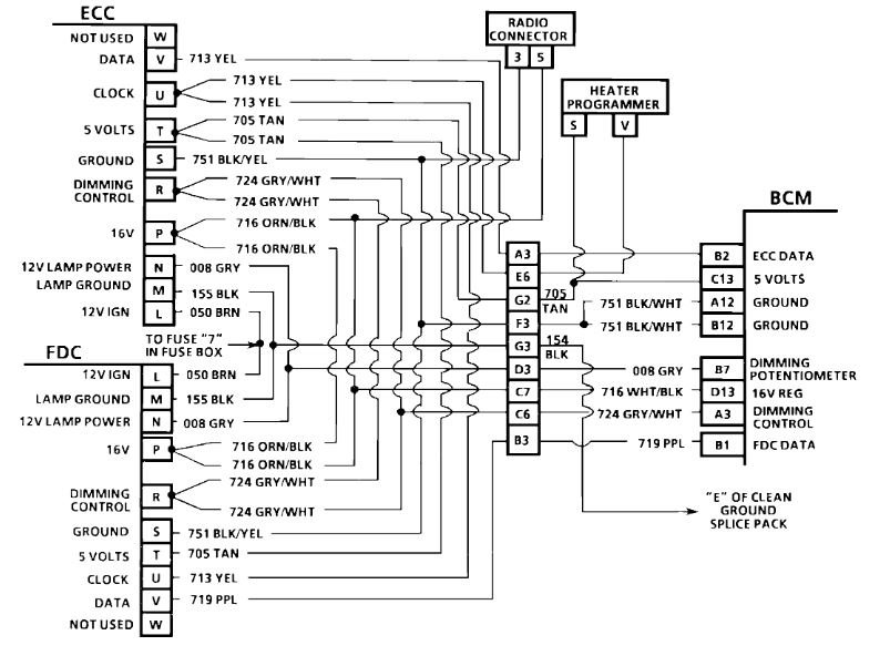

As far as the displays, they are controlled by the BCM or body control module. I attached diagrams and a flow chart for you to follow to determine the failure. The most common cause was the BCM.
