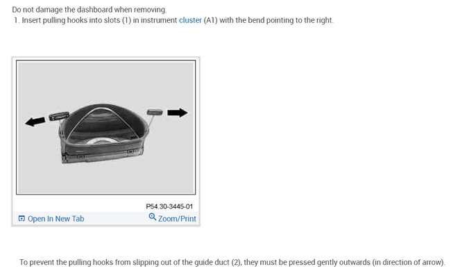

Also the head lamp goes on when I start the engine. checked battery, yes was dead. Took battery for recharge. Battery okay now but when I fix the battery I still face the same problem. Please advise.
Sep 26, 2019 at 12:27 PM
  • 55,711 POSTS

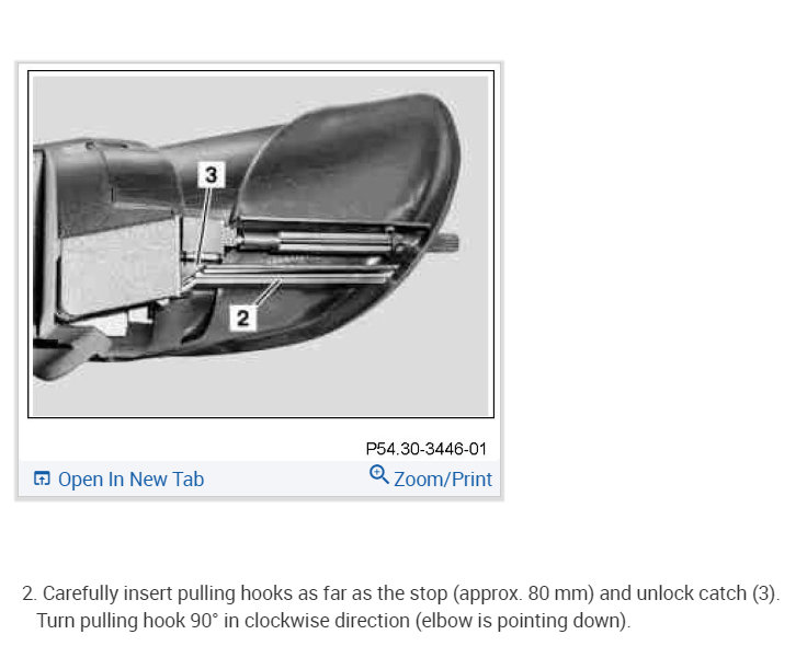

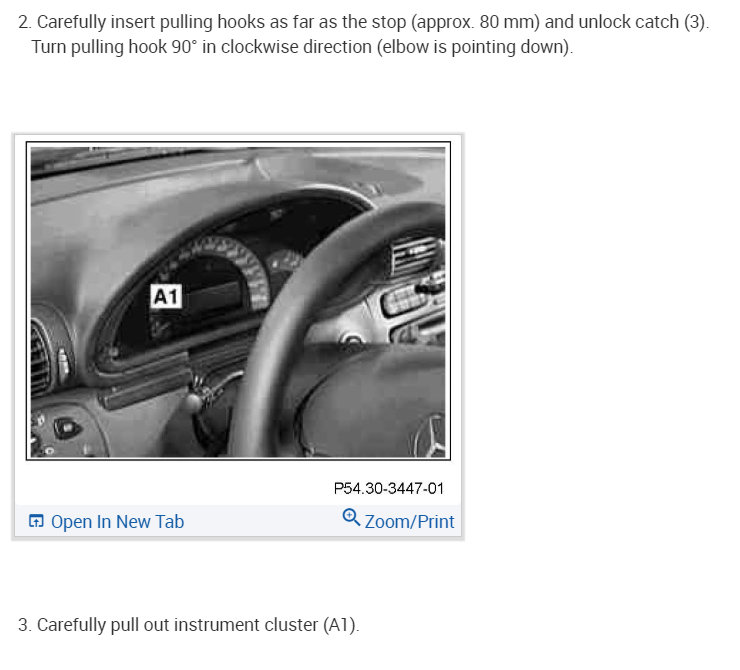

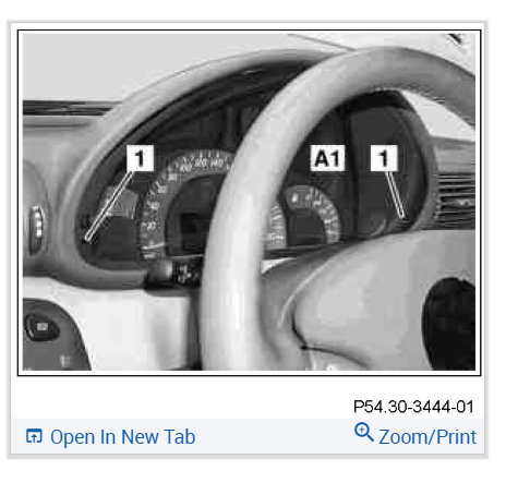

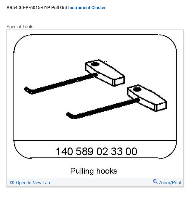

this is common when the cluster shorts out and needs to be replaced with a rebuilt unit. I have included the instructions of the instrument cluster remove in the diagrams below. Check out the diagrams (below). Please let us know what happens.
