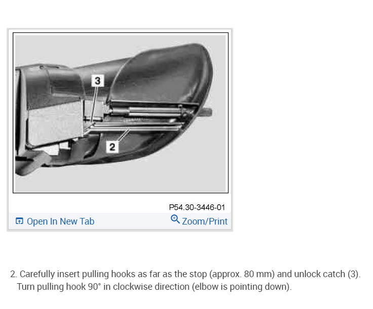

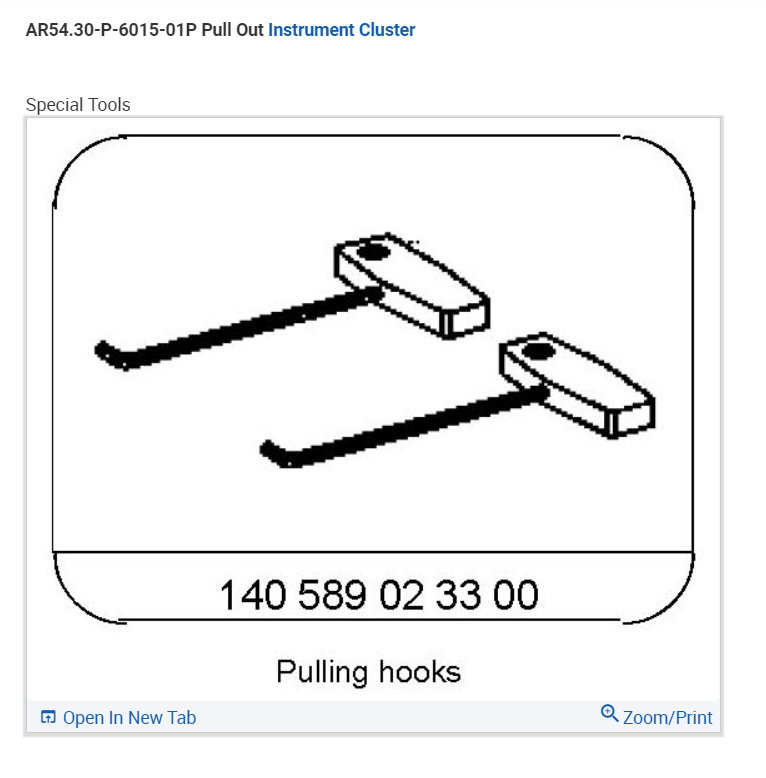

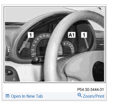

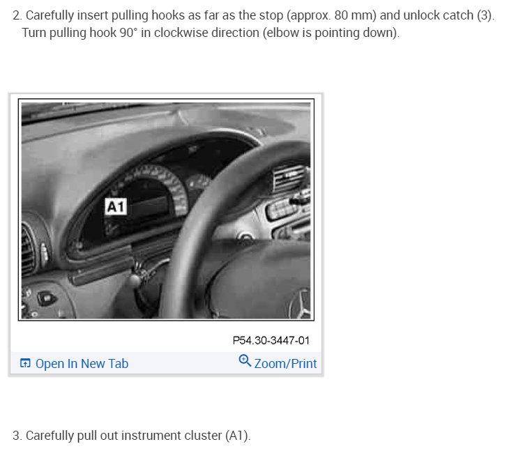

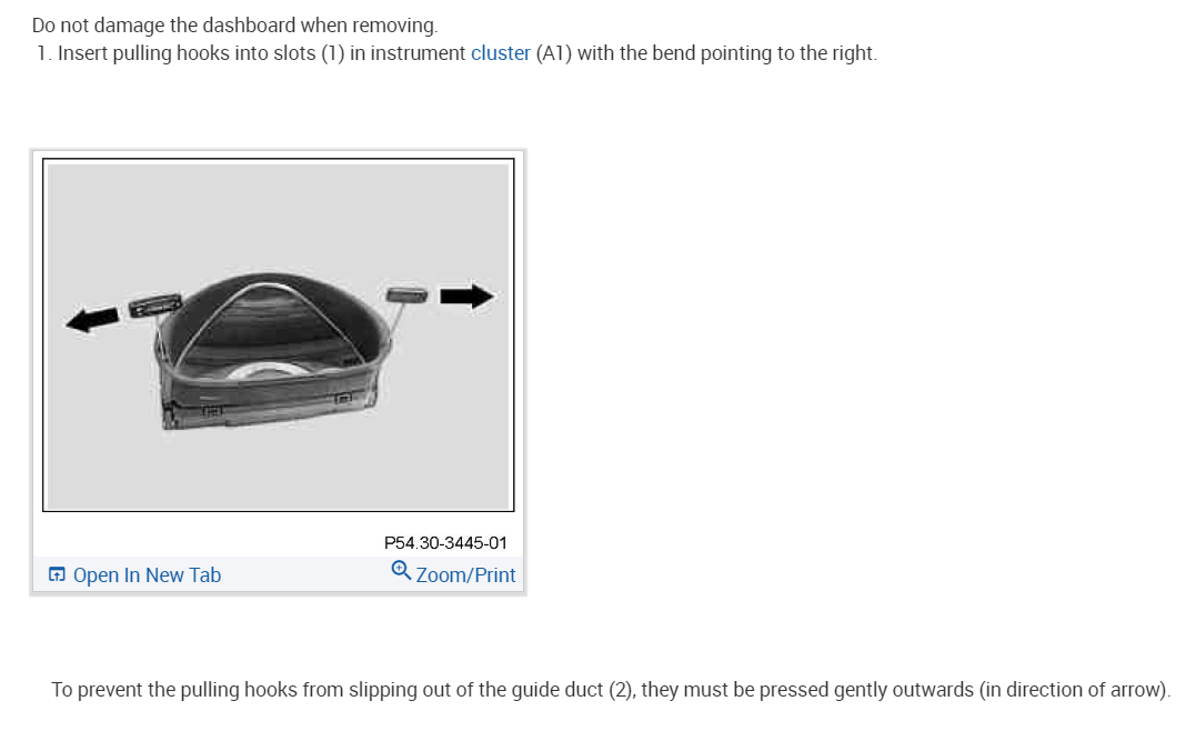

Also the head lamp goes on when I start the engine. checked battery, yes was dead. Took battery for recharge. Battery okay now but when I fix the battery I still face the same problem. Please advise.
Sep 26, 2019 at 12:27 PM
  • 55,224 POSTS
this is common when the cluster shorts out and needs to be replaced with a rebuilt unit. I have included the instructions of the instrument cluster remove in the diagrams below. Check out the diagrams (below). Please let us know what happens.
Sep 29, 2019 at 3:49 AM
MERZW203
Hi Ken, Thank you for the reply. Took your advise and got a used cluster, fixed it and everything seems back to normal, including the head lamp. Everything is fine except there is a display shows this alert message " Visit Workshop! Display Faulty!". Please advise.
