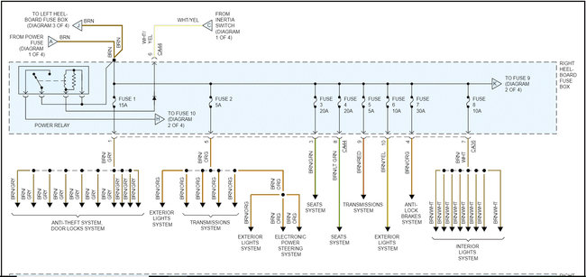

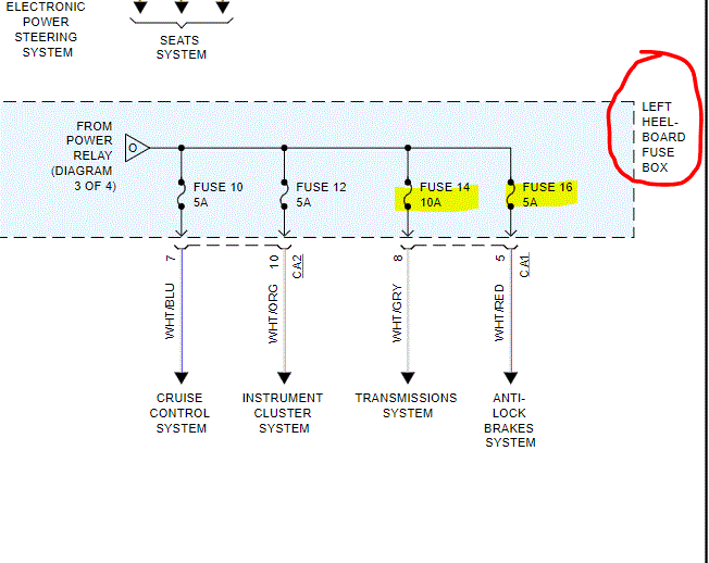

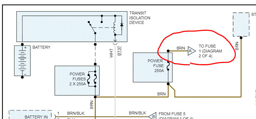

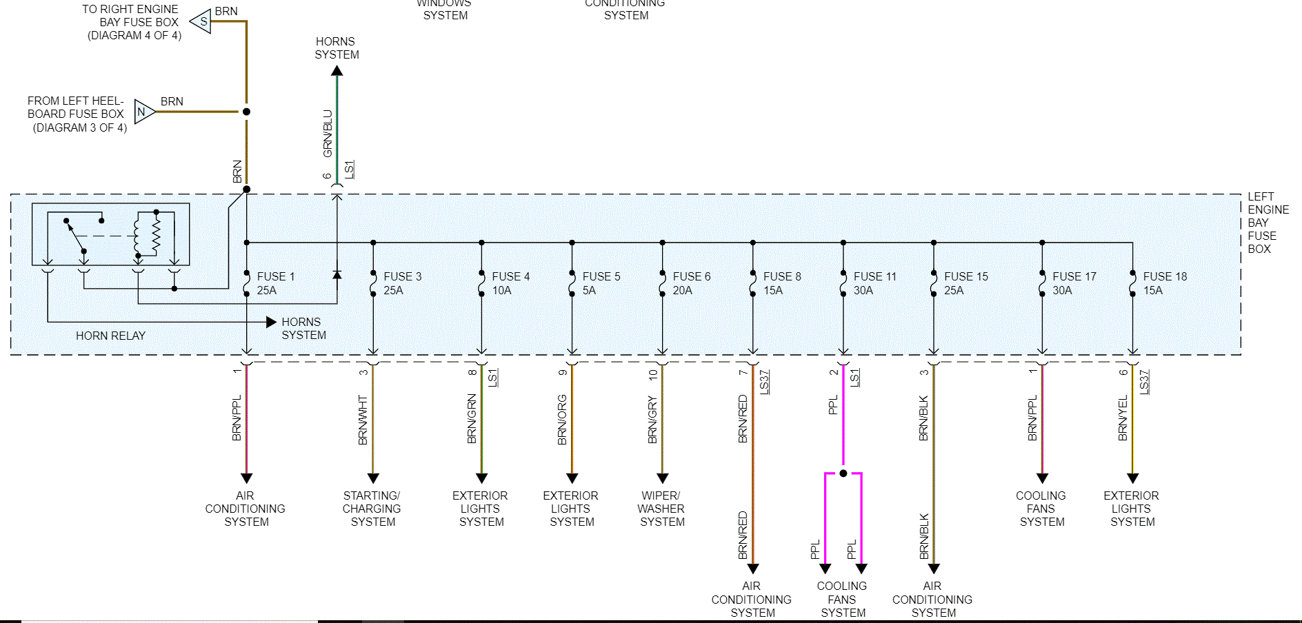

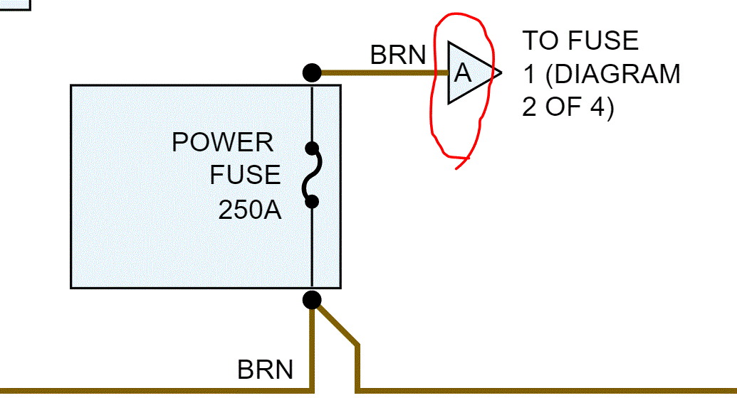

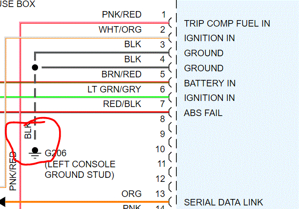

Did all the lights/gauges fail at the same time? Also, you indicated that fuses were good. Please confirm power is to them. Pic 1 shows the fuses to inspect.

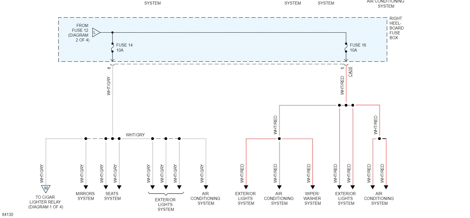

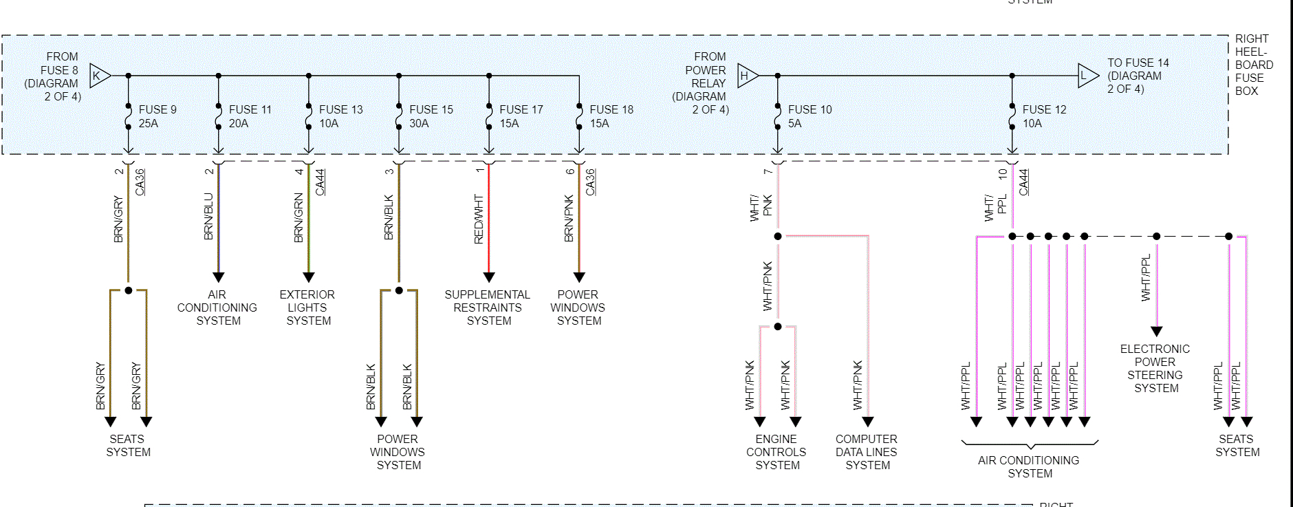

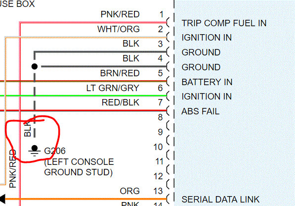

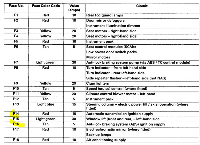

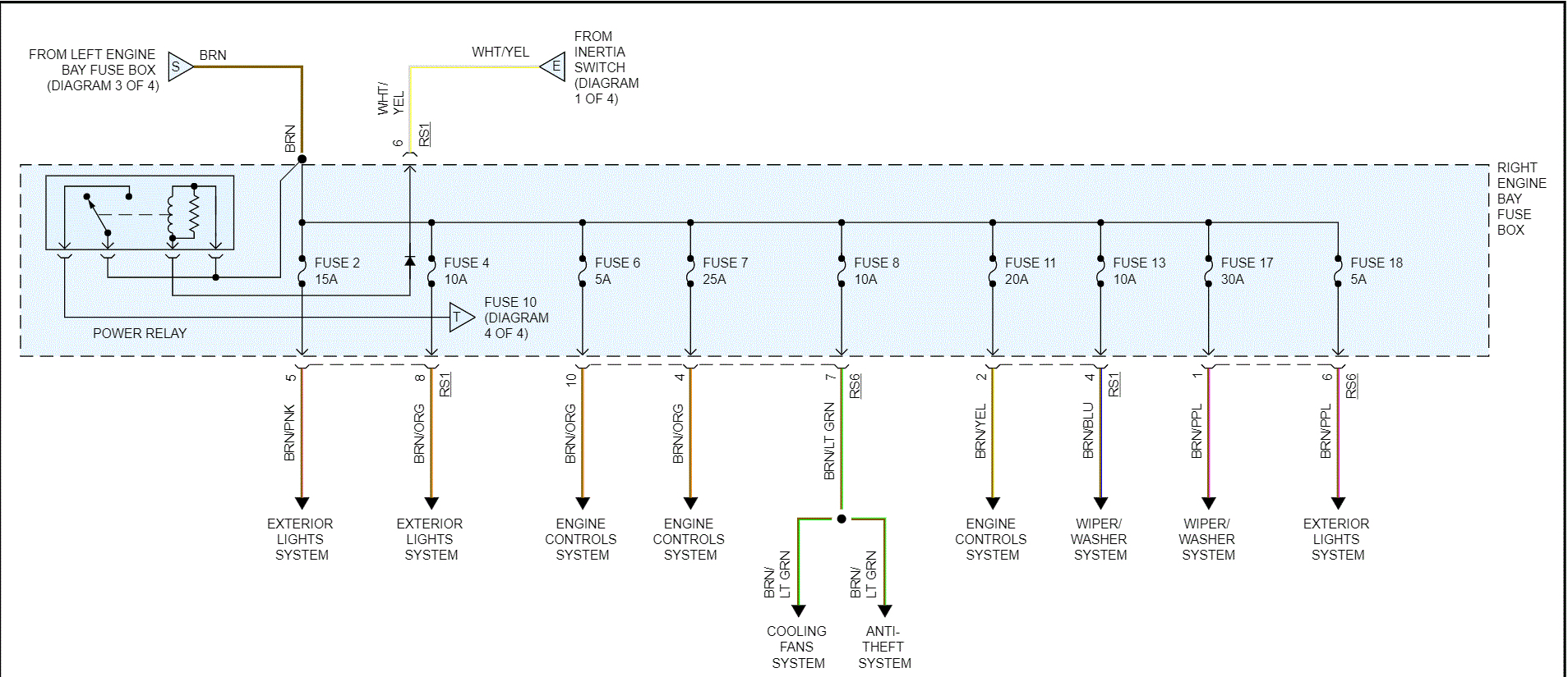

Pic 2 shows a ground. It is located on the left side of the console ground stud. Check and make sure nothing has come disconnected or has been damaged.
Here are a few links you may find helpful:
I'm not sure if you confirmed power at the fuses. That is why I'm asking.

no power at fuses.what governs these two fuses behind left hand heel board?

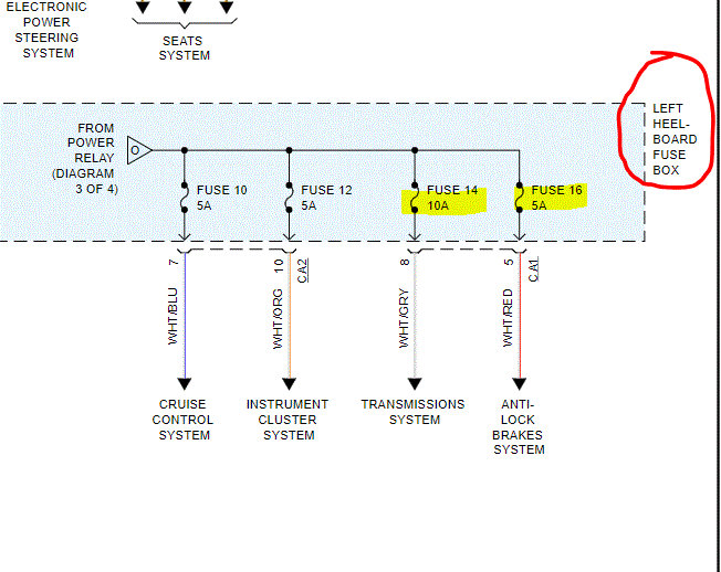

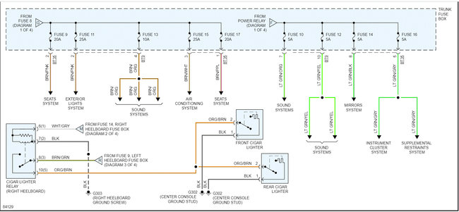

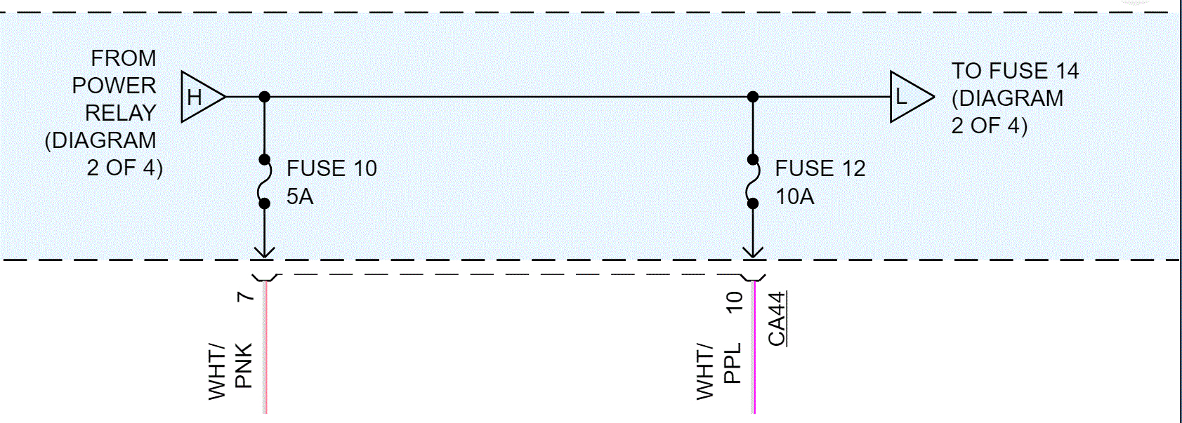

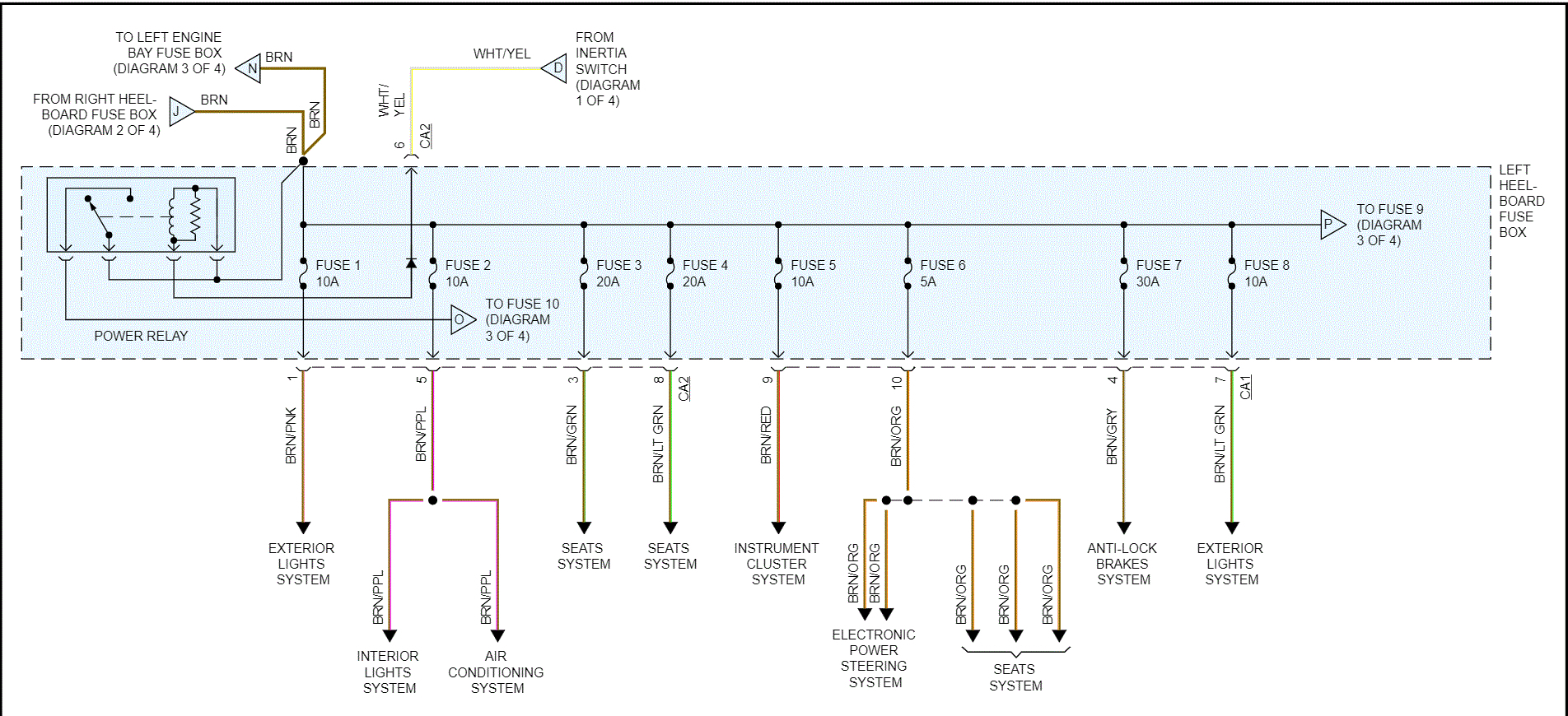

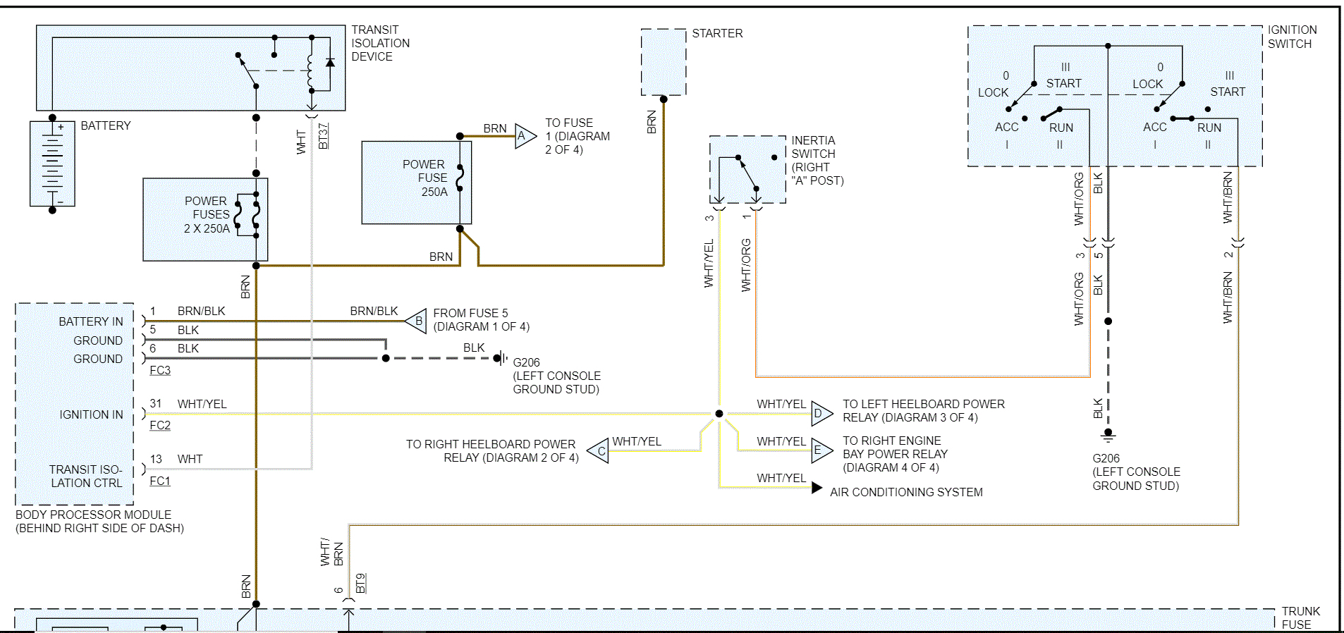

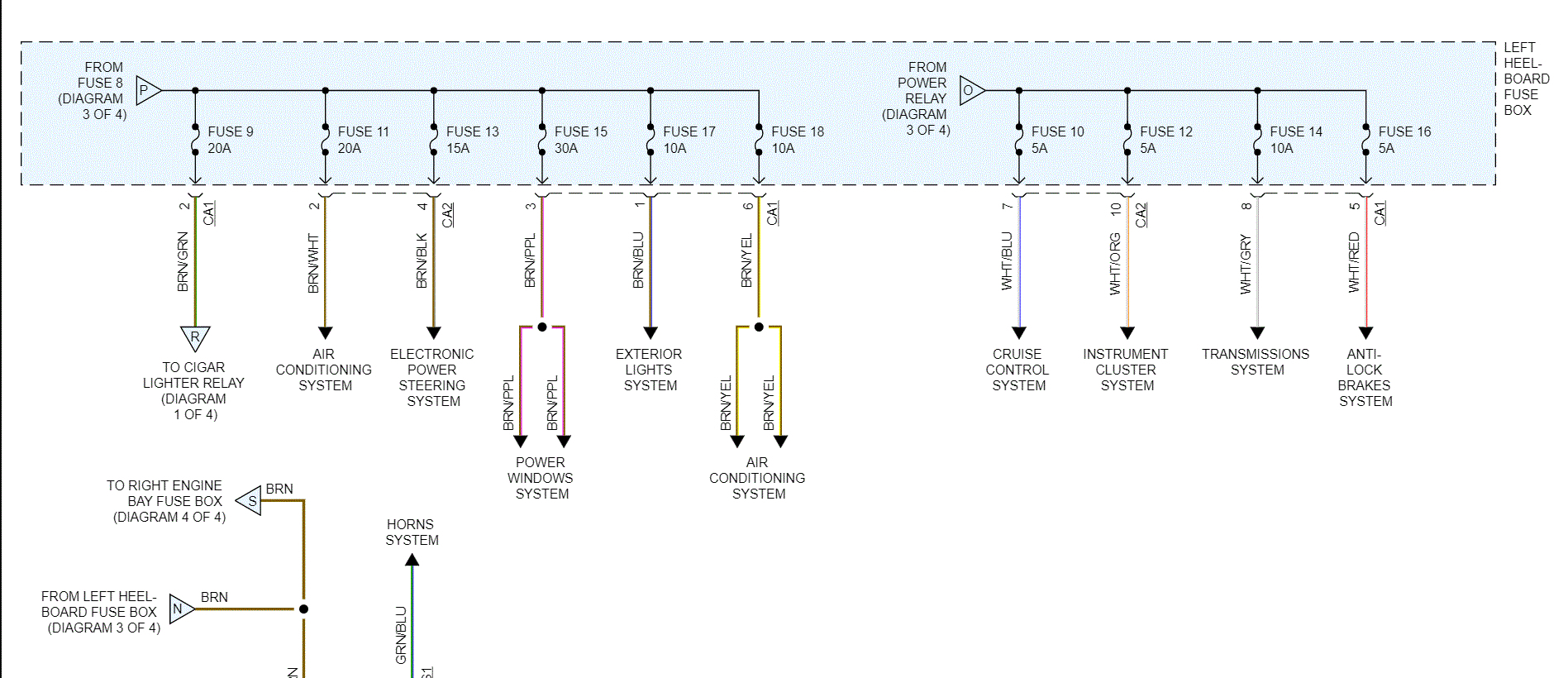

I attached 3 pictures below from the wiring schematic. It shows how power gets to the fuse you checked.
Let me know if this helps.

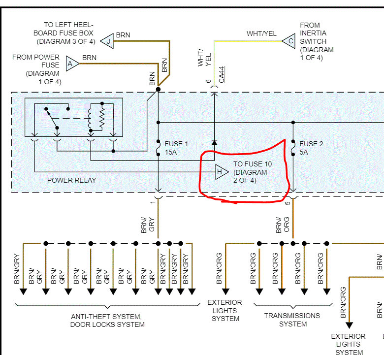

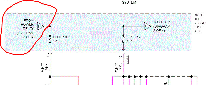

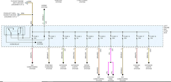

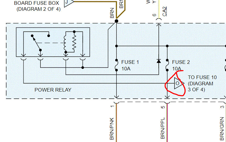

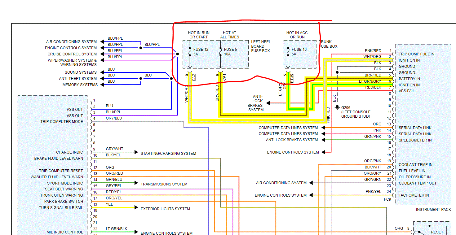

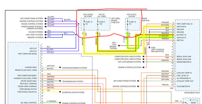

  • 110,240 POSTS

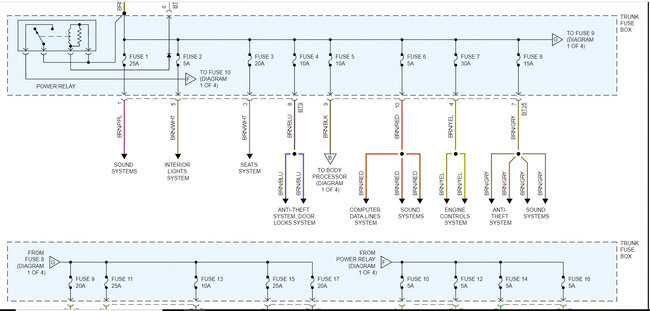

Hi, Michael.

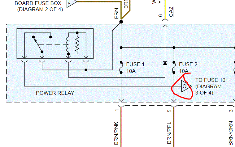

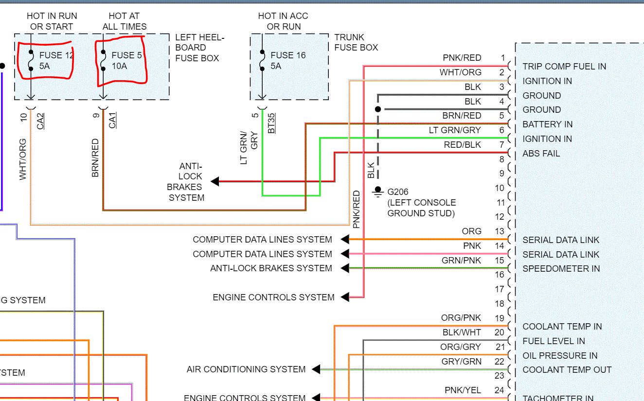

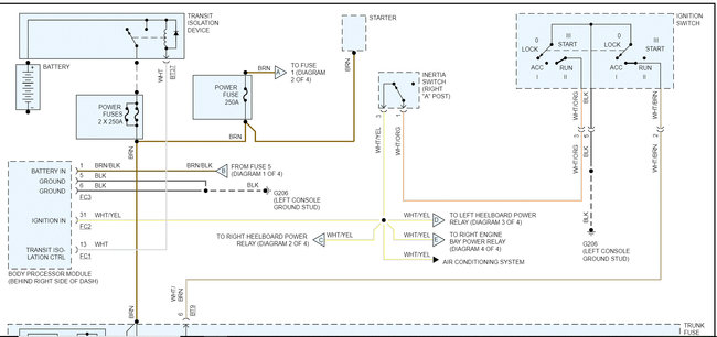

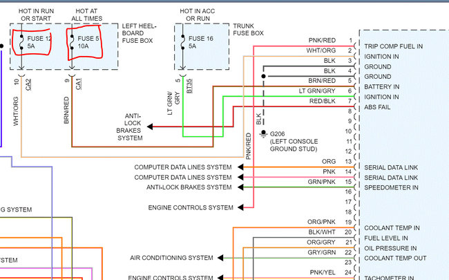

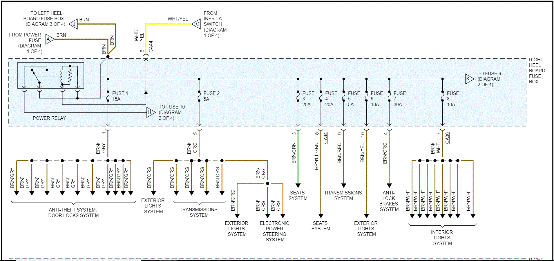

Here are the same pictures but I enlarged them. Let me know if they help. Also, starting with picture 4, I copied the entire power distribution system. I overlapped them to make it easier to follow. Keep in mind, the schematics are 4 pages long regular size, so I had to break them up to enlarge them.

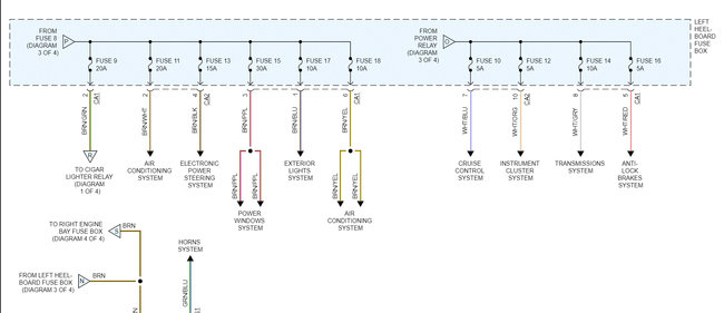

Hi Joe, sorry to be vague. Behind L/H heel-board are two fuses F14 and F18, there is no power at either of these two fuses, wondered if there is a common denominator between these two or if two separate parts need replacing. Hope this helps.
Best regards,
Michael.
Mar 8, 2020 at 6:27 PM
  • 110,240 POSTS

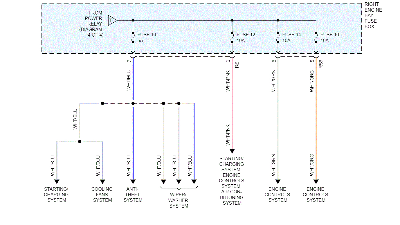

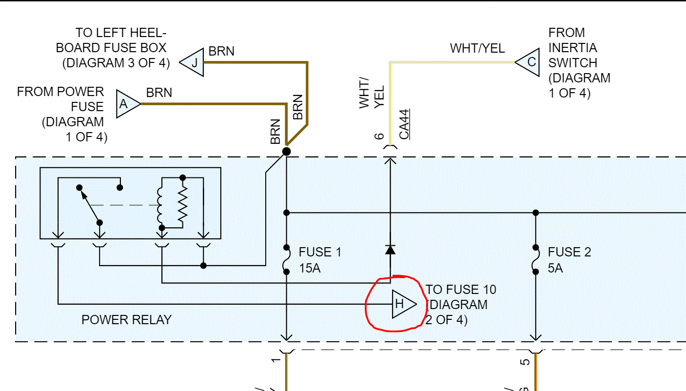

sorry for the delay The two fuses you mentioned are not related to the instrument panel. See picture 1. By accident I highlighted 16 rather than 18. There is no F18 on the schematic. Are you sure that is the correct number?
Also, I attached two other schematics. They show how power reaches that box.

I'm not 100% sure why there is a difference. The pictures I sent are from the manuals I have. Did I indicate the fuses you are referring to? (sorry this is so confusing. Wiring schematics can get somewhat involved)
