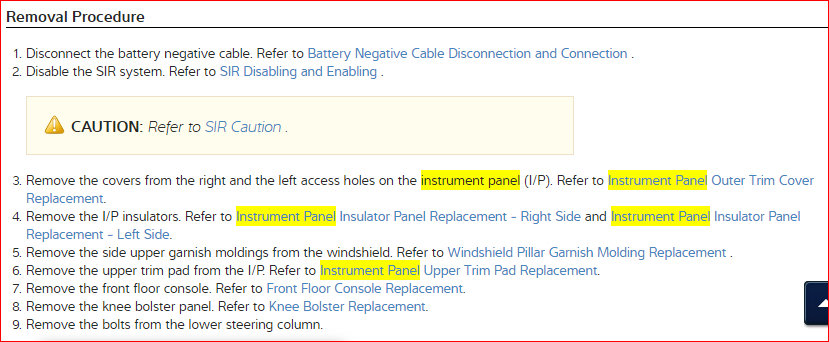

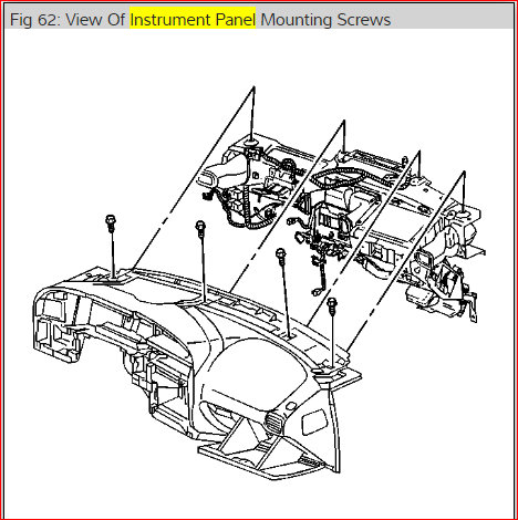

Hello, would like information on how to to remove dashboard, to get access to air conditioning unit box.

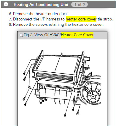

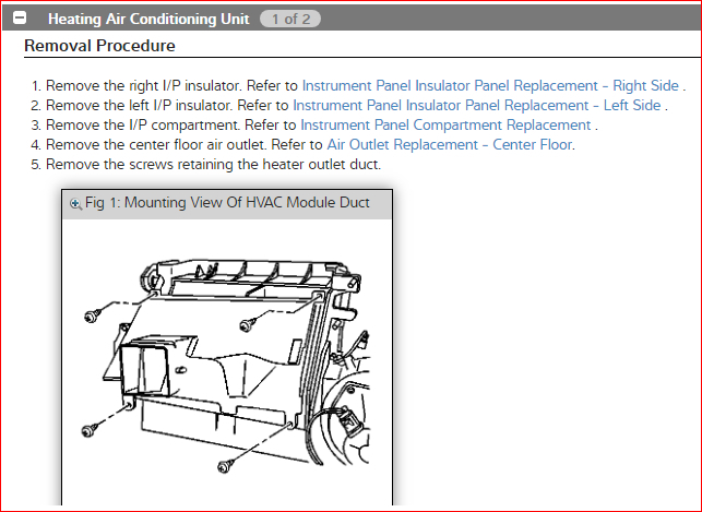

Yes, need to replace A/C unit, it is cracked.

Hello again.
I've attached a few pictures below and let's see if you get access to all the fasteners holding the HVAC unit to the firewall.Hope this helps and get back to me with updates.Thanks again for using 2CarPros.

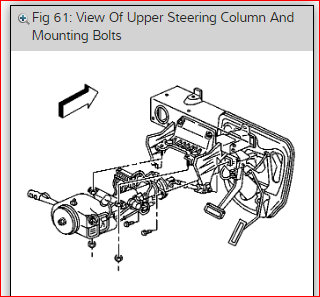

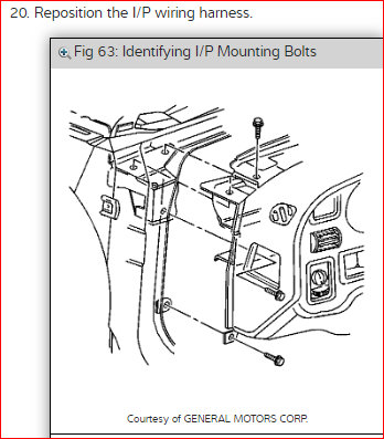

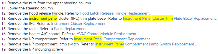

Absolutely, pictures will help me a lot.

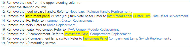

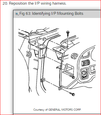

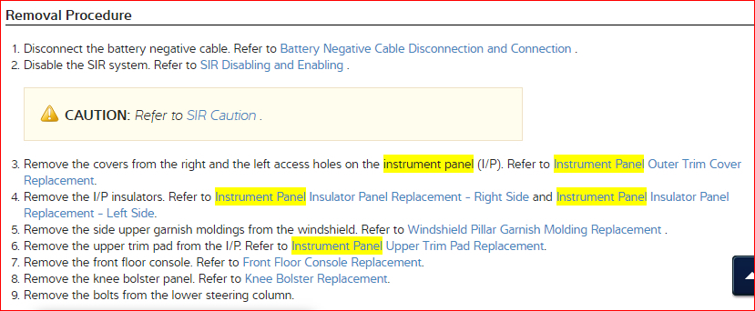

Do you have pictures, instructions on how to remove dashboard?

Hello again.
Here is what I've found. I've attached step-by-step pictures below.Hope this helps and thanks again for using 2CarPros.
