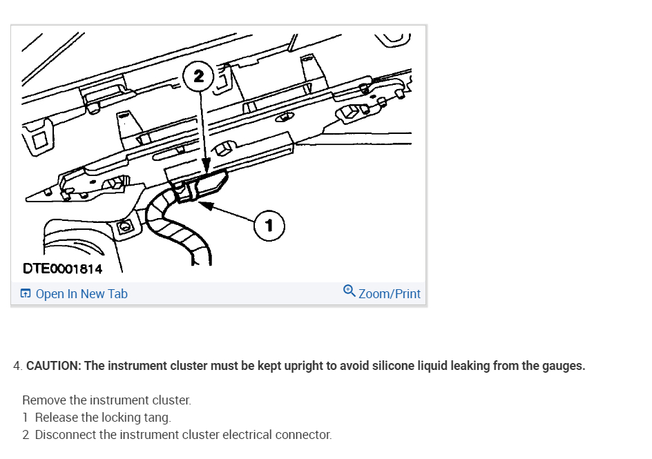

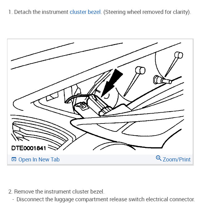

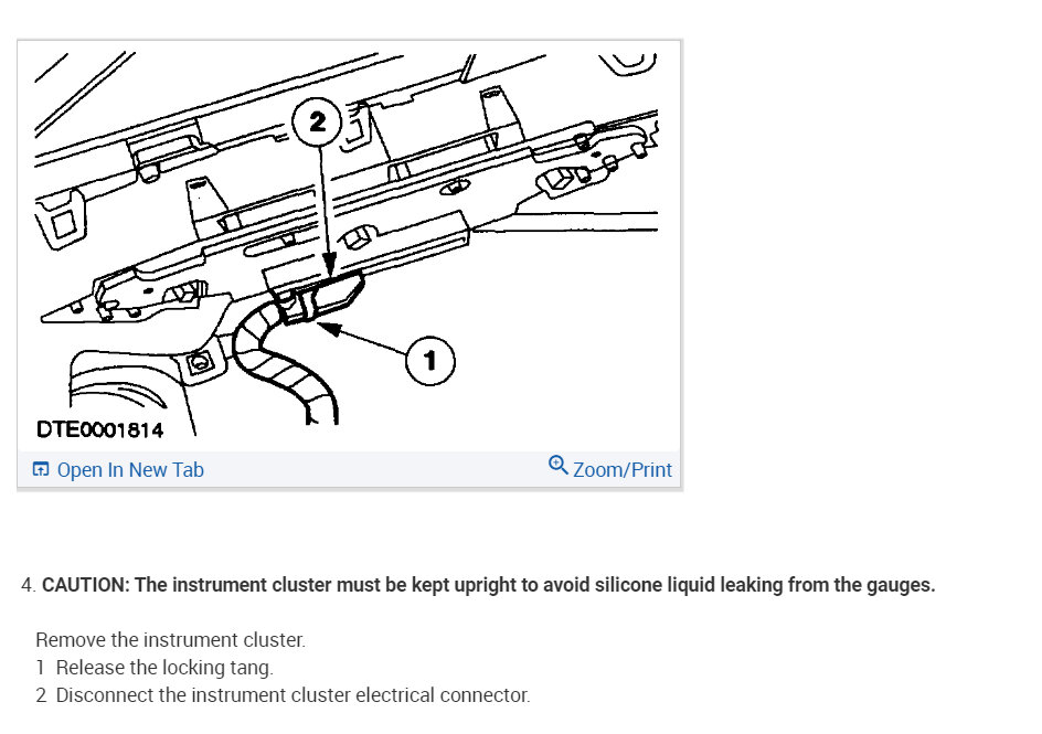

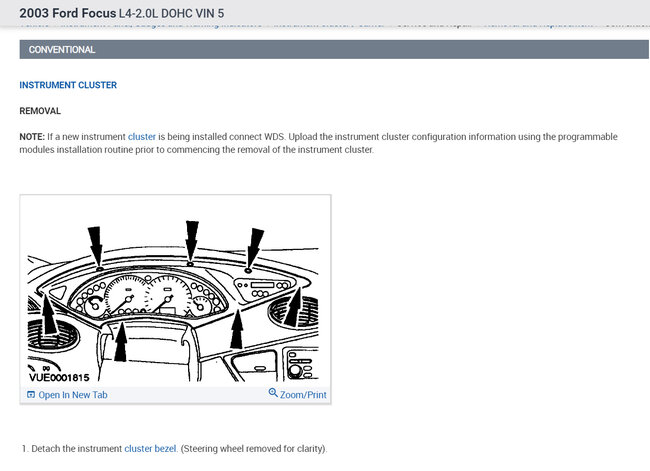

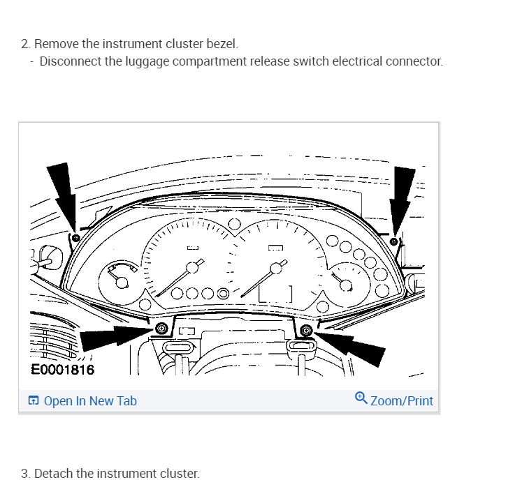

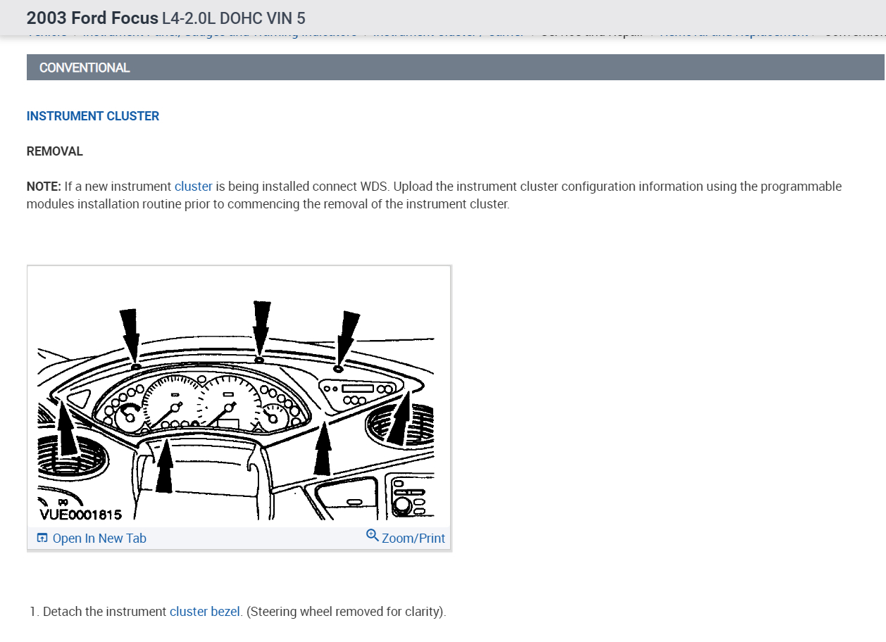

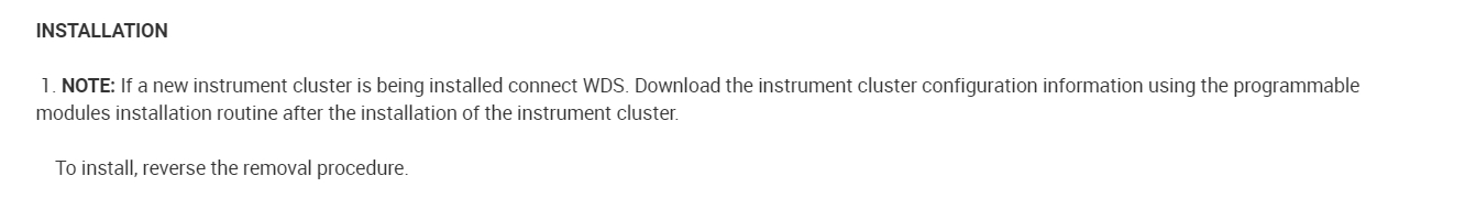

Dashboard all warning lights remain on, tachometer, speedometers, and temperature gauge work sometimes while driving and then stop?
2003 FORD FOCUS
272,000 MILES • TURBO • 2WD • MANUAL
SOHAIL4U
only the fuel gauge is working properly. I already checked all fuse are okay.
Jan 15, 2023 at 6:42 AM
  • 54,878 POSTS
Yep, this happens when the instrument cluster goes out you will need to get a rebuilt unit by searching google or eBay. Here is how to change the unit out in the images below. Check out the images (below). Please let us know if you need anything else to get the problem fixed.
