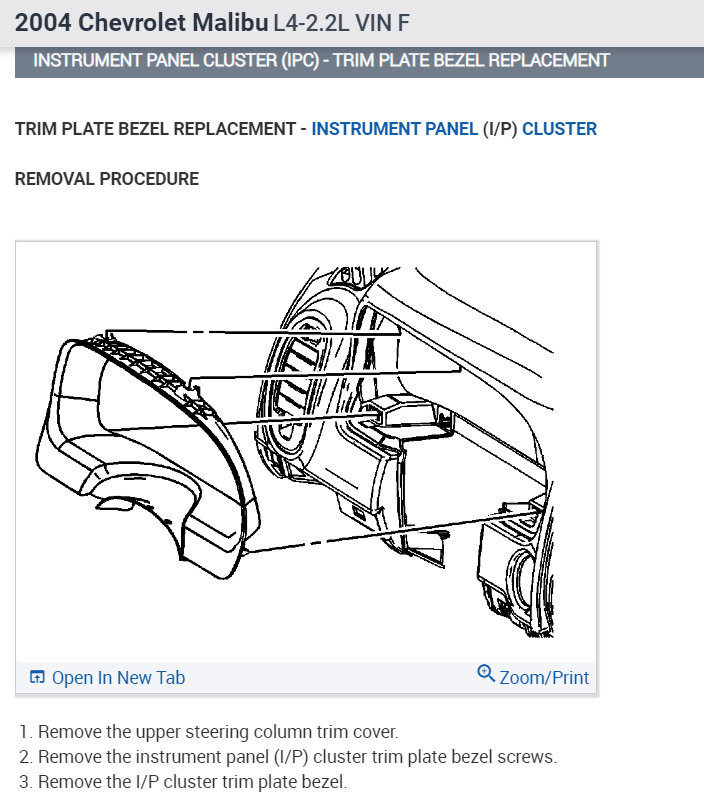

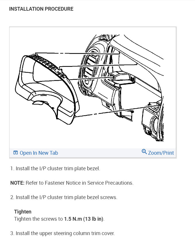

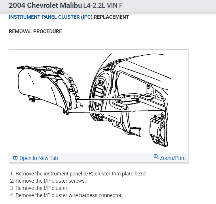

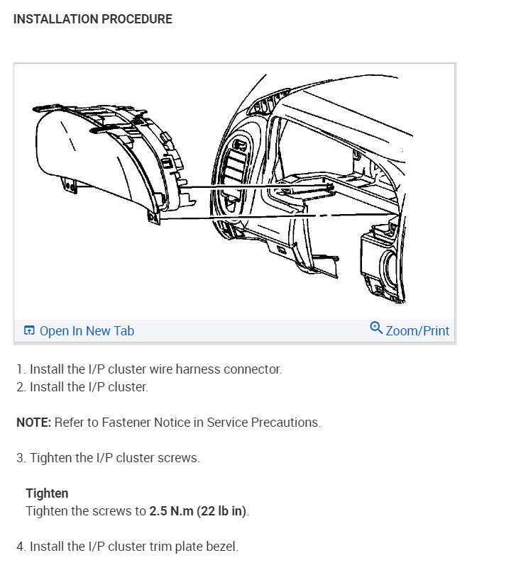

Thanks for the video, yes, the clusters have gone bad which will cause the issue in the video. Here is a generic guide on how to replace the clusters which and can find online with the instructions for your car in the diagrams below:
https://youtu.be/_HEC44xENxw
You will need to have the current milage and VIN for the rebuilder. Check out the diagrams (below). Please let us know if you need anything else to get the problem fixed.
