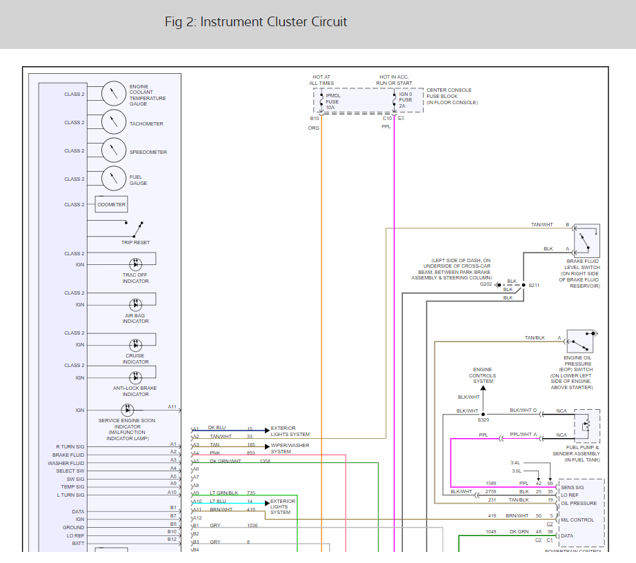

Nothing works, nothing lights up.
Jul 9, 2019 at 2:41 PM
  • 55,433 POSTS

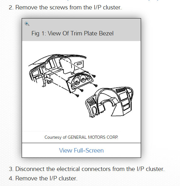

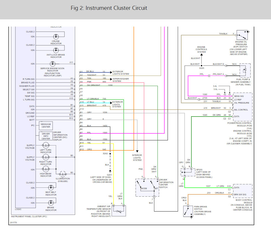

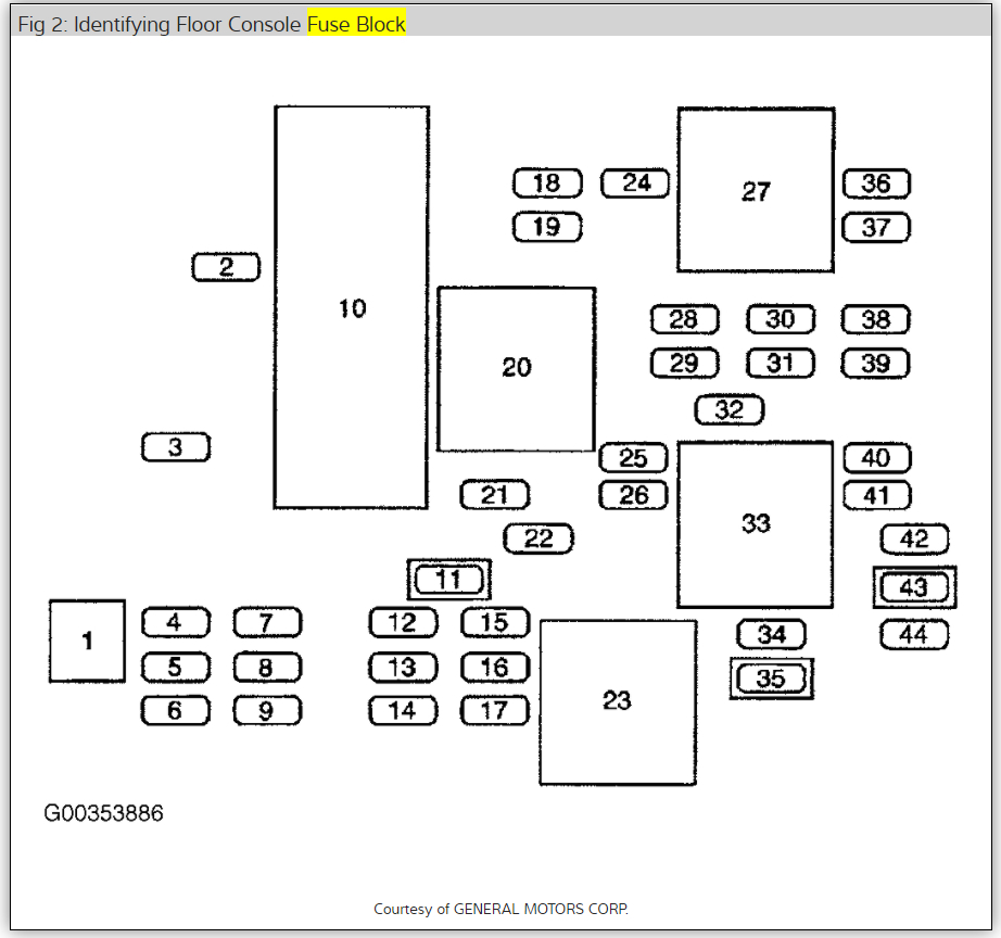

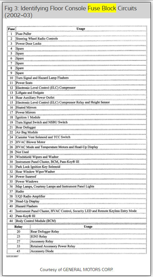

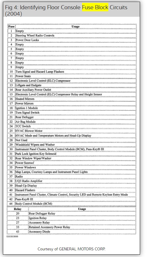

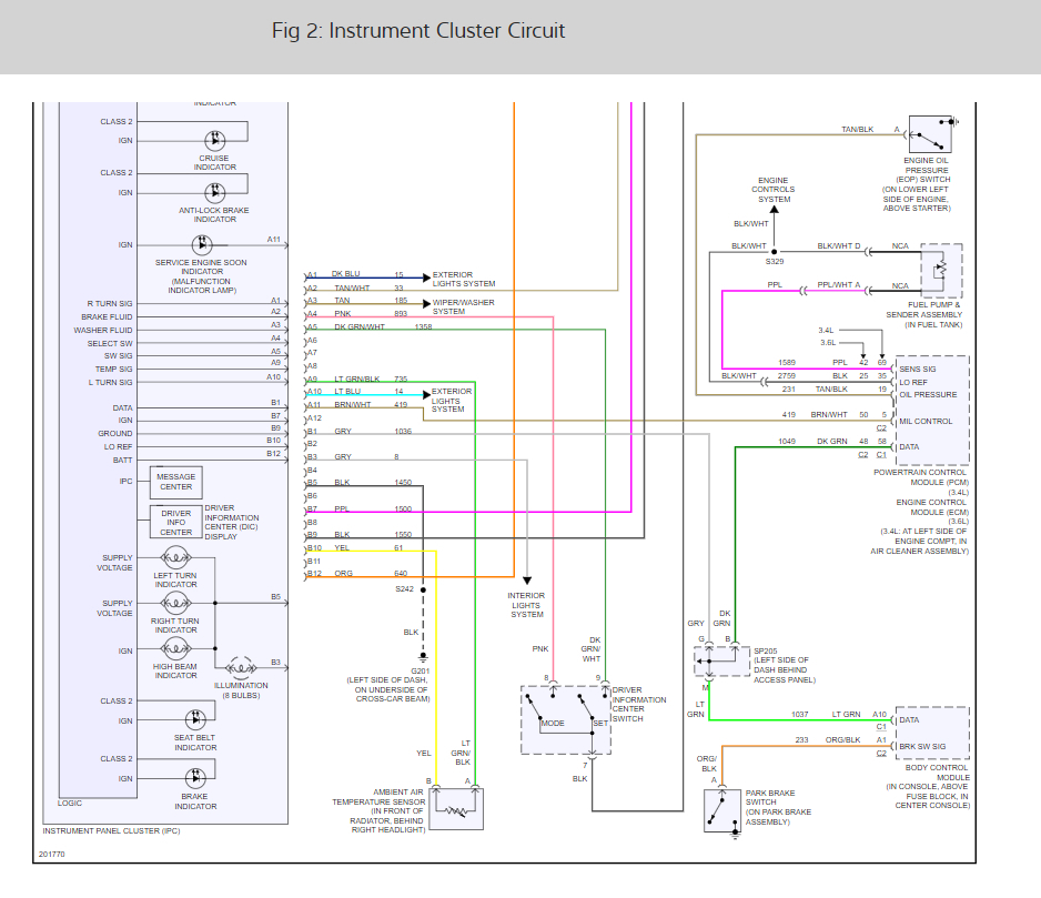

Lets check the fuse IPMDL and IGN0 fuses in the center console fuse panel. here is a guide to help and the cluster wiring diagrams so you can see how it works and the fuse location as well:
If the fuses are good chances are the cluster has gone out. here is the job being done on a similar car with diagrams below to how you how yon your car:
