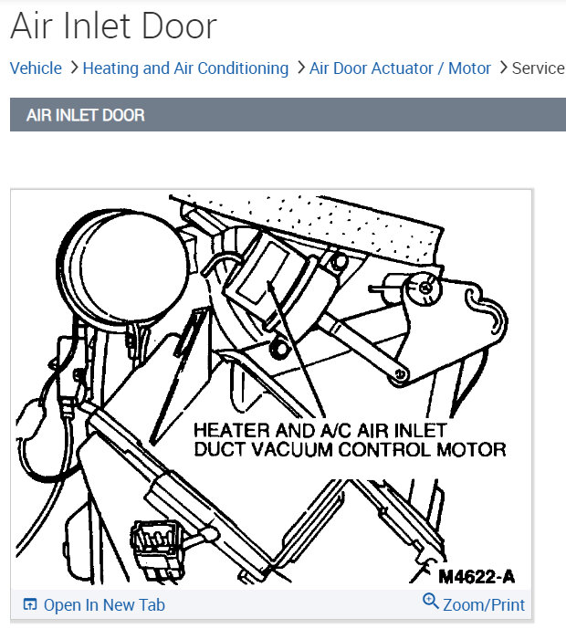

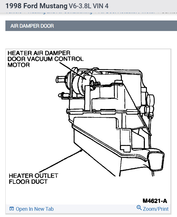

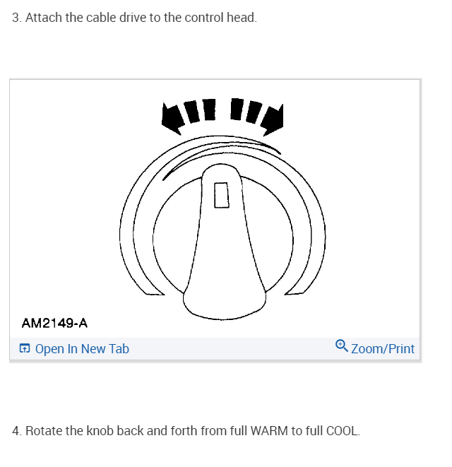

I know ya'll are getting tired of this question but, I've got the car listed above coupe, blend door control works in every positing except dash vents when switched to A/C or vent. Floor works as does defrost. Using diagrams, I found on here I've traced down all vacuum lines and repaired the ones loose or broken. Still having the issue with no air coming out of dash vents when I switch the selector to A/C or vents?

It sounds like you have a blend door pivot that has come loose internally. Let's try turning the system on and working the blend doors by hand to see if you can get the air to blow out from the vents. Here are the locations so you can check it out. Please check out this guide:

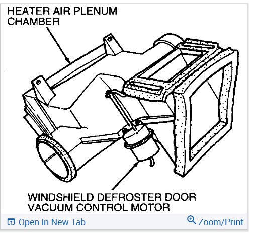

It might be a control valve issue, or you have a broken vacuum line under the hood. please go over this guide to see what I am talking about:

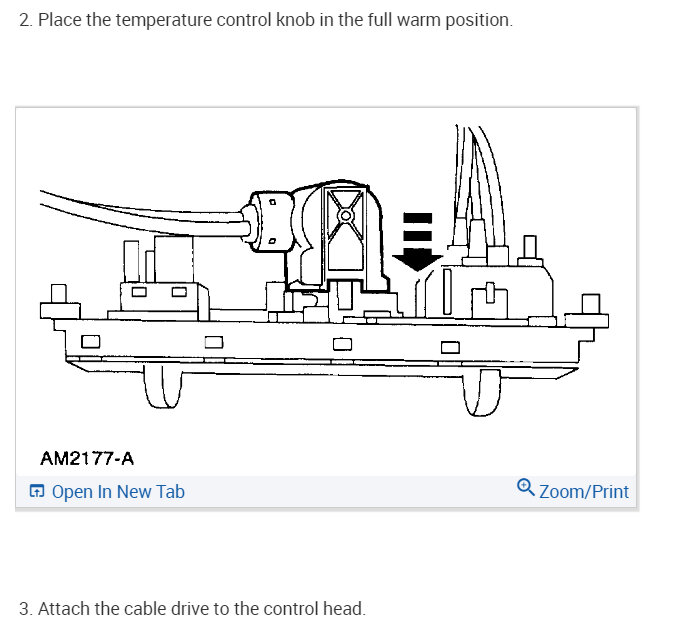

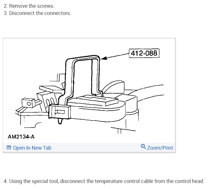

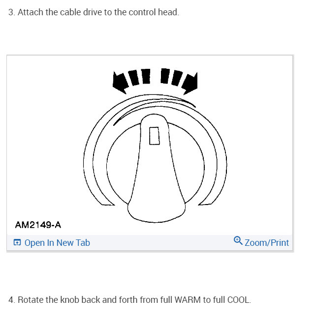

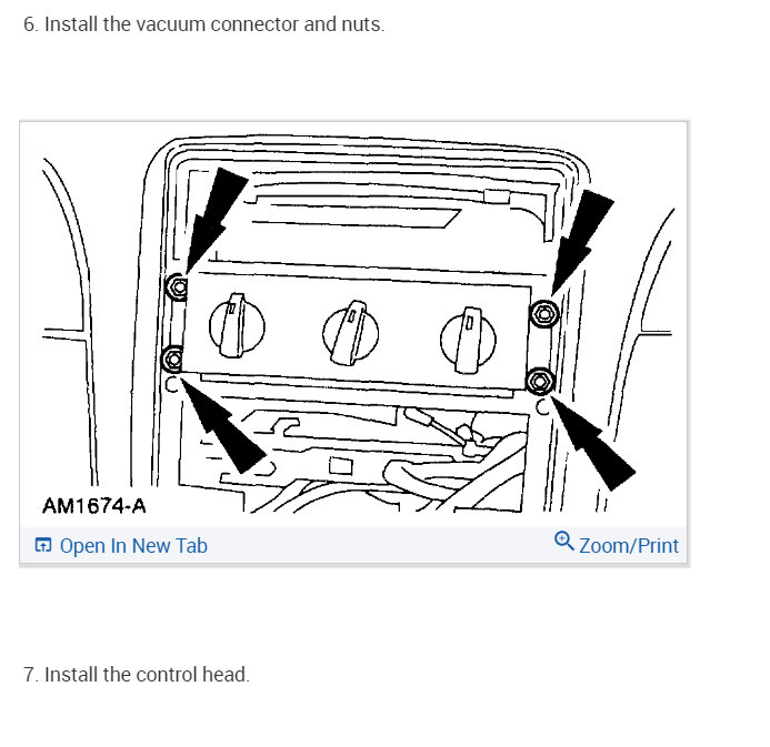

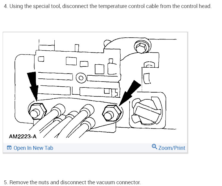

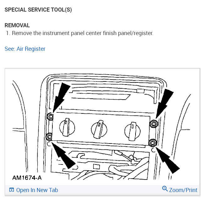

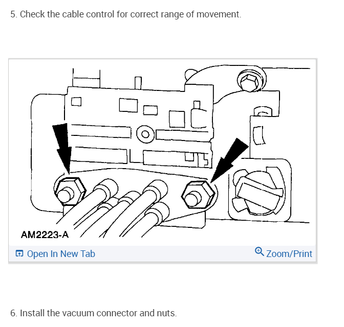

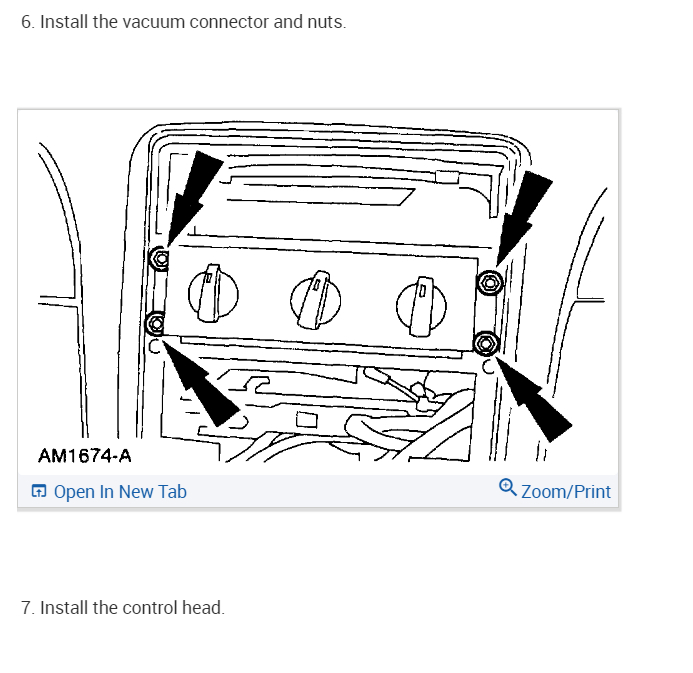

I'm 98stangcoupev6, I put a vacuum smoker on it in a few different places, no leaks found in engine area or under the dash. At this point I'm thinking it could be the selector switch itself.
Oct 24, 2023 at 9:19 PM
  • 55,224 POSTS

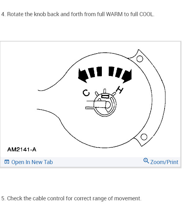

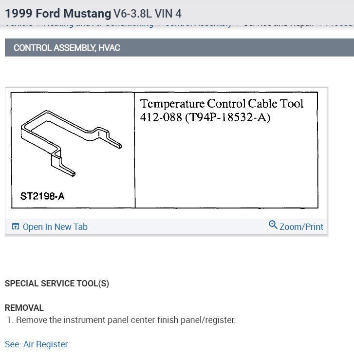

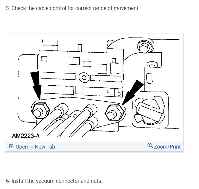

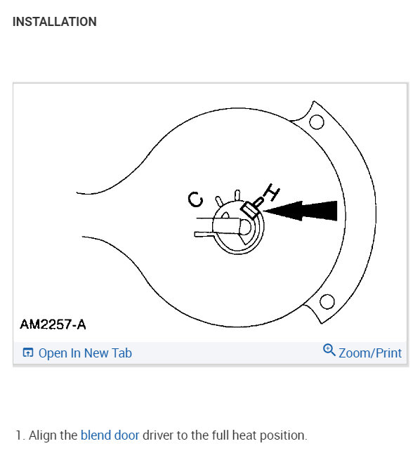

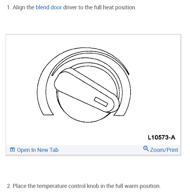

Yep, they do go bad, here is how to replace it. Check out the images (below). Please let us know how it goes.
