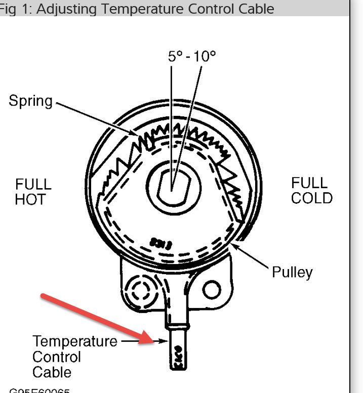

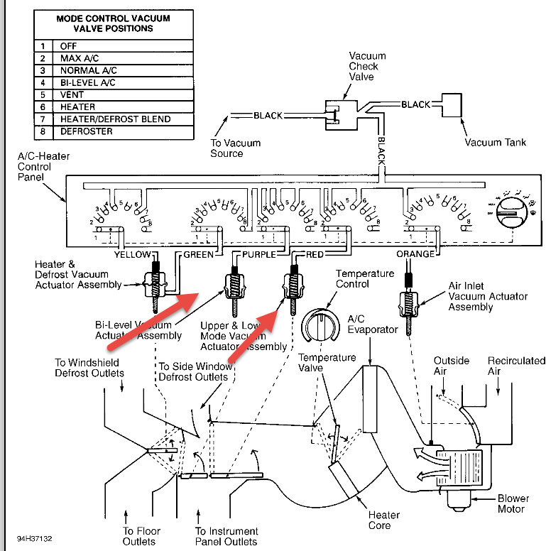

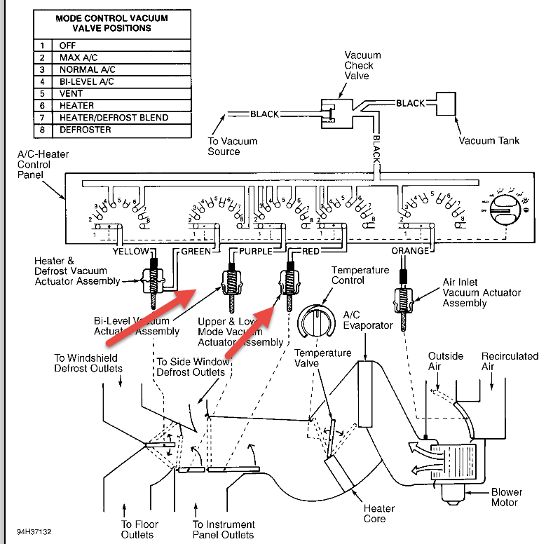

The vents on the dash do not put out any air or heat.

For no hot or cold check for a broken cable. For other check for a vacuum leak or not getting vacuum to motor on heater unit. See pictures.
