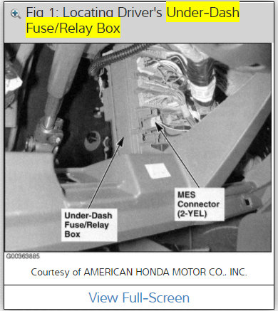

I've check fuses thinking it is the relay, but can't find which relay it is and it's location.
May 5, 2019 at 2:03 AM
Experienced Mechanic
55,740 POSTS

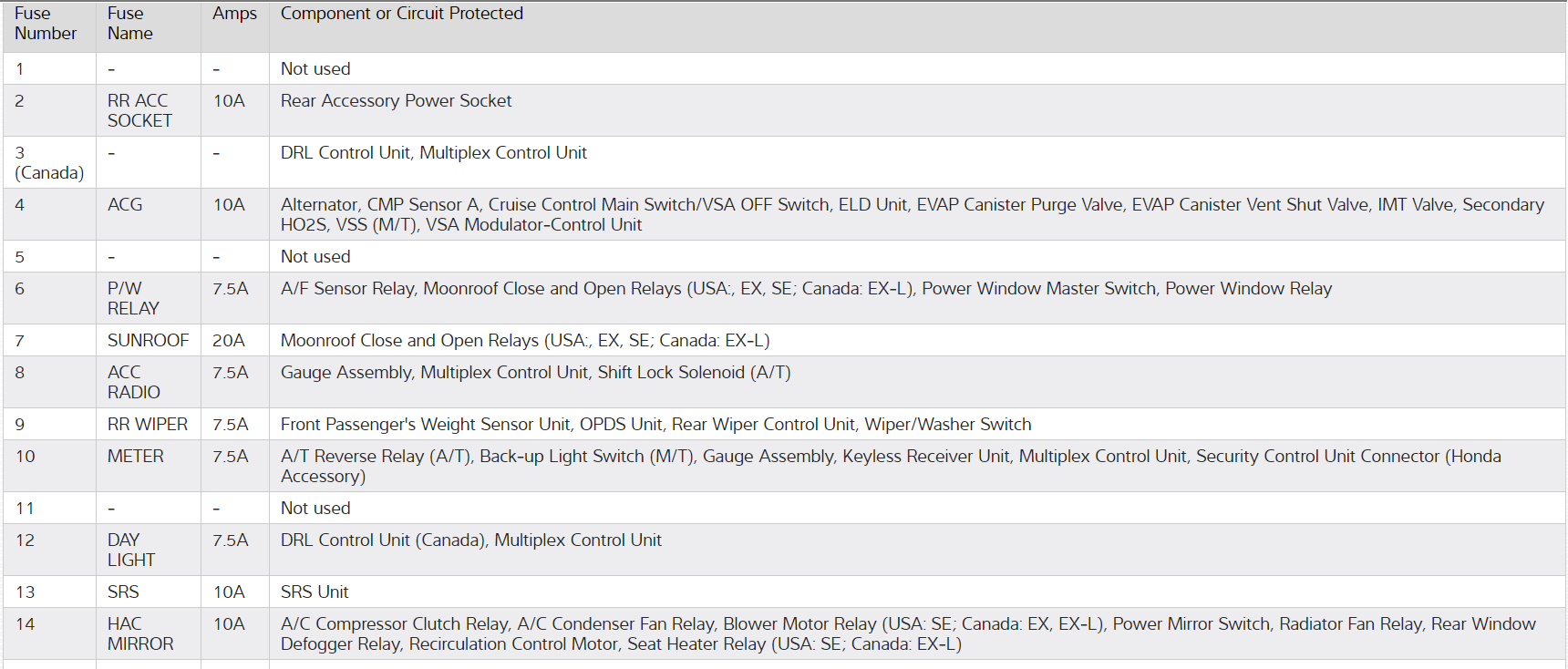

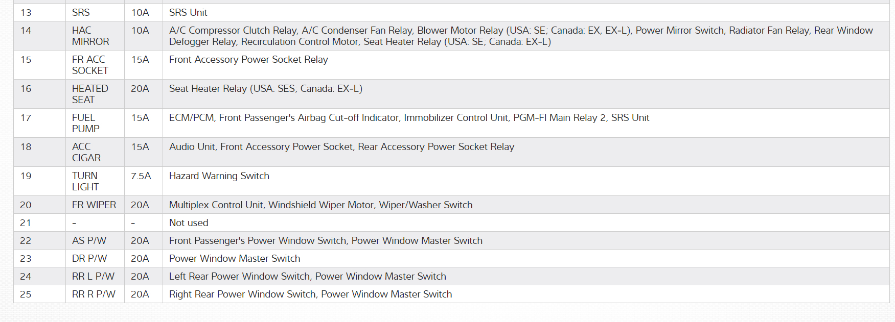

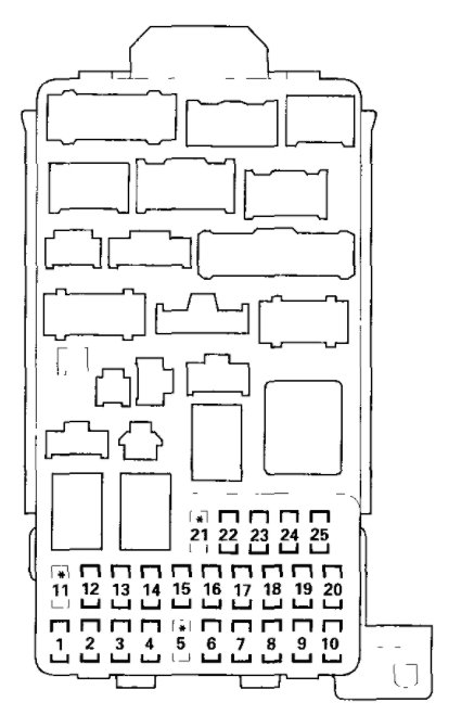

It sounds like the tail light relay went out but to be sure here is a guide to help you test it and the location of the relay in the diagrams below.
Check out the diagrams (Below). Please let us know what you find. We are interested to see what it is.
