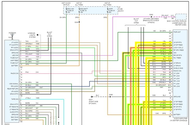

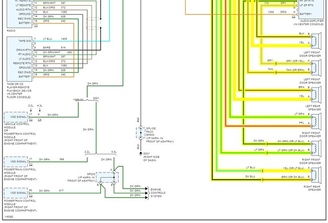

The wiring for speakers is cut loose behind an aftermarket radio and I need to connect the speakers to an amplifier to see which wires go to which speaker?
Apr 10, 2022 at 10:30 AM
WENDY W
  • 86 POSTS
I've attached several charts and a schematic (in two parts) that show the wiring colors for the speaker circuits.
