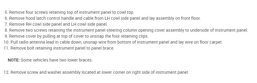

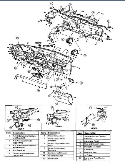

How do I remove the dash?
1997 FORD F-250
220,000 MILES • 5.4L • V8 • 4WD • AUTOMATIC
RALPH SMYTHE

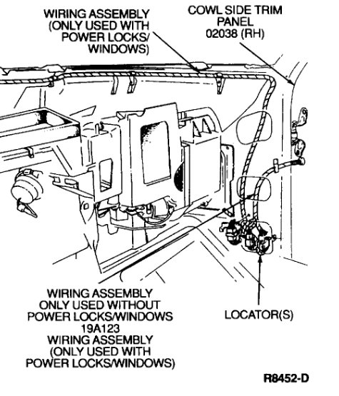

Electric windows quit and interior lights. The dash lights are okay, remote mirrors okay. Checked fuses, okay.
Suspect critters. Probably need to get behind the dash.
Aug 4, 2022 at 7:49 AM
  • 110,244 POSTS

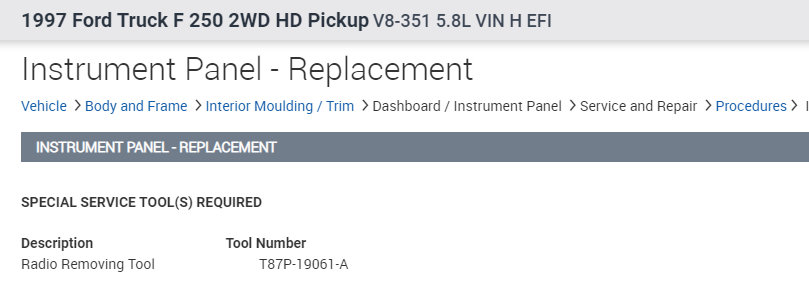

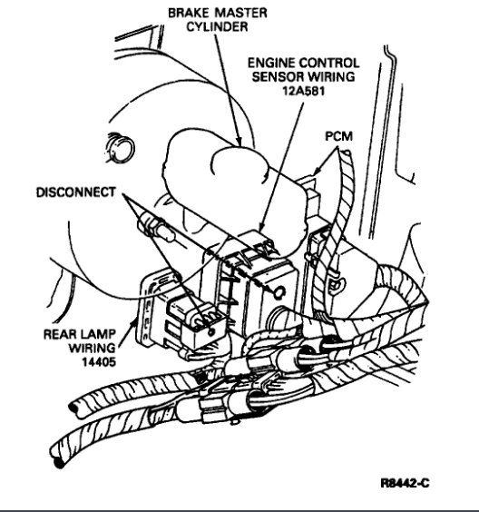

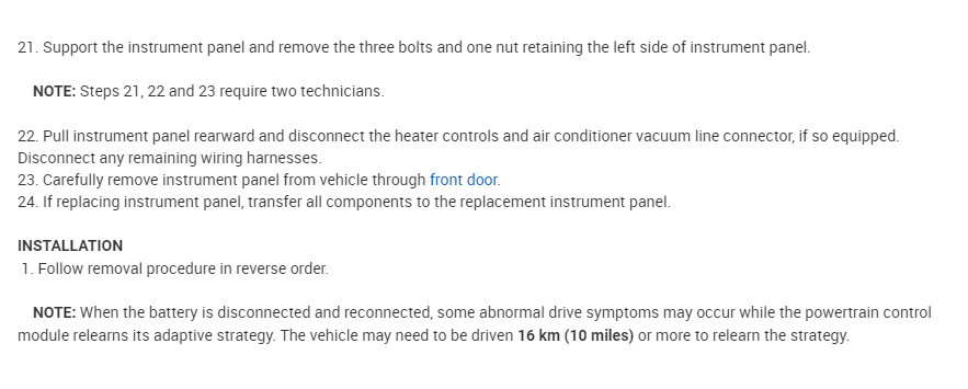

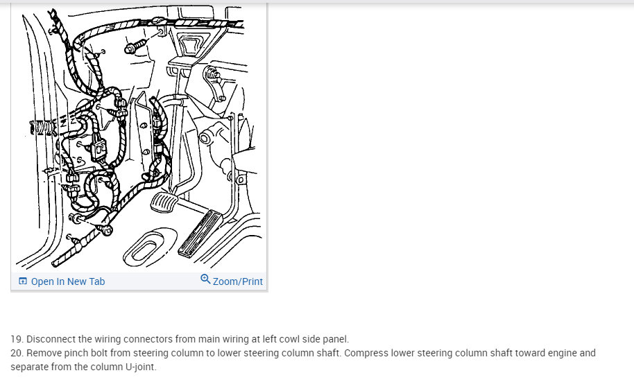

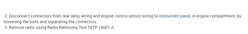

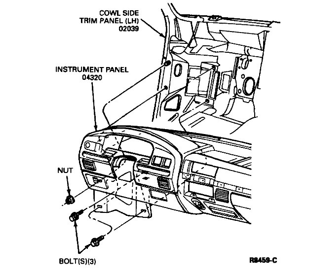

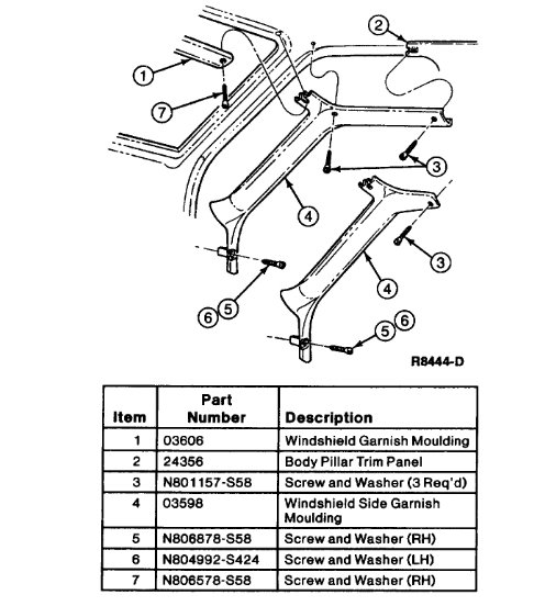

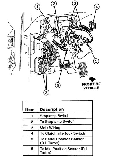

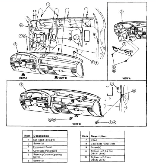

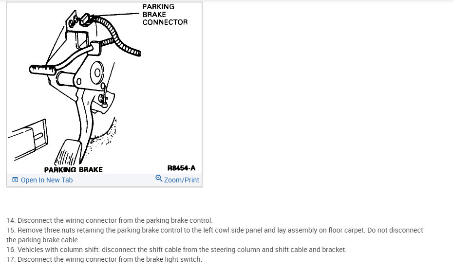

Removing the dash is a big job. So, make sure before you begin. Also, I realize you checked fuses, but in addition to the fuse, make sure there is power to and from it.
As far as dash removal. I attached the directions below. Take a look through them and let me know if you have questions.
Aug 4, 2022 at 2:34 PM
