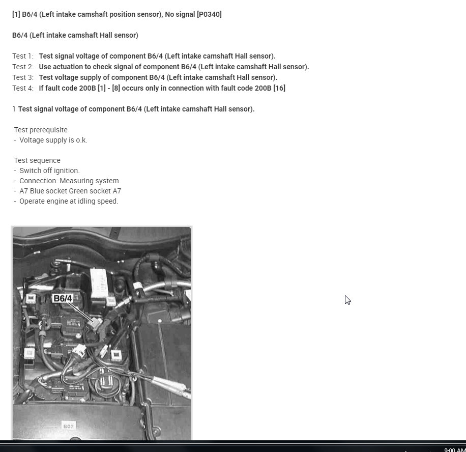

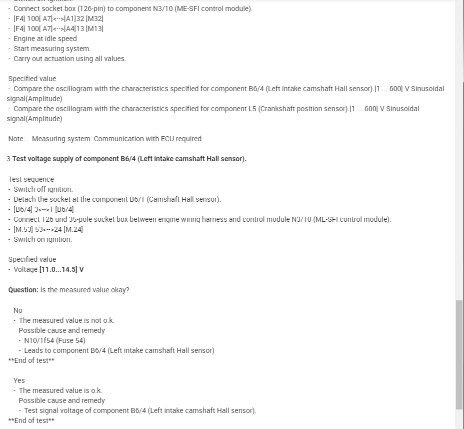

OBD 2 scanner reads code P0340-malfunction of the camshaft position sensor.

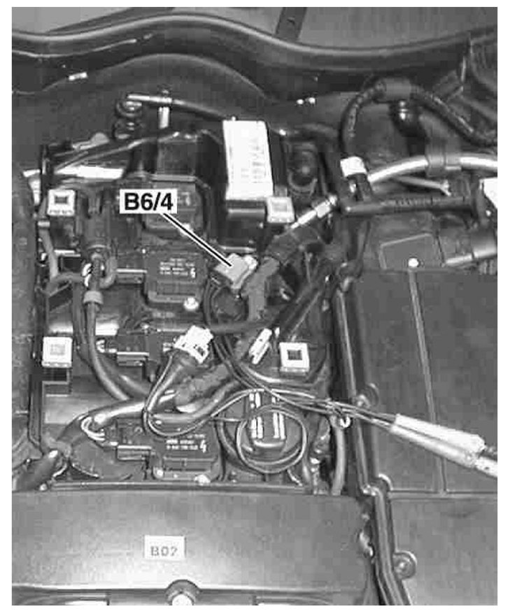

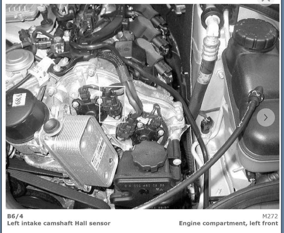

Please help me to find the exact location of the camshaft position sensor and what things to be removed to reach the sensor.
Nov 27, 2019 at 11:26 AM

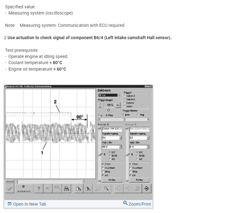

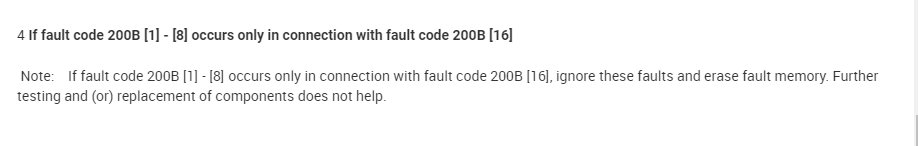

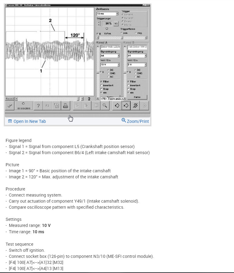

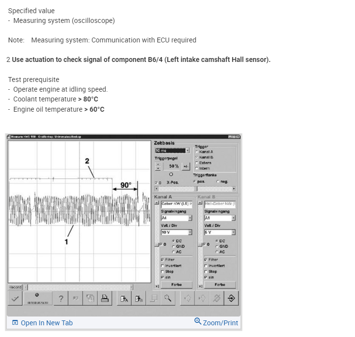

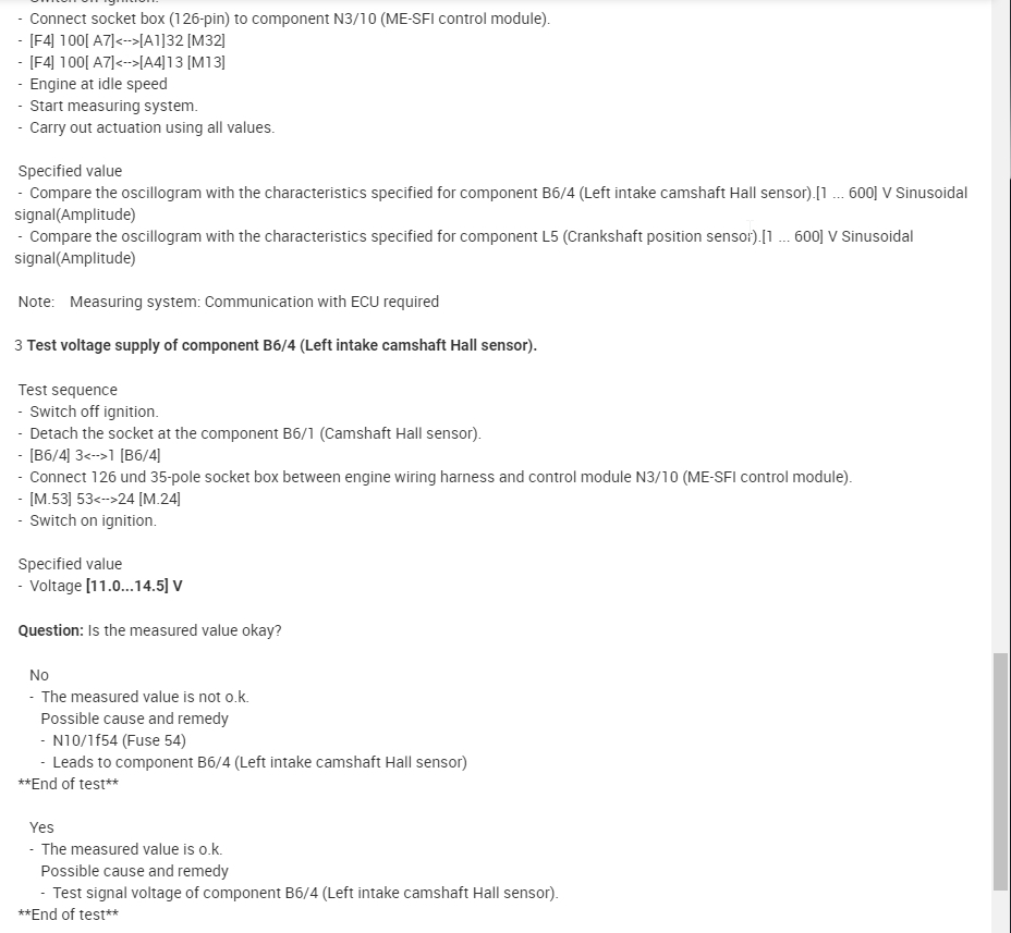

I attached the info below. I would suggest running through the test just to confirm it is the sensor. That is the most likely cause but it could be a wiring issue. Let me know if you have questions. Thanks
Nov 27, 2019 at 10:05 PM

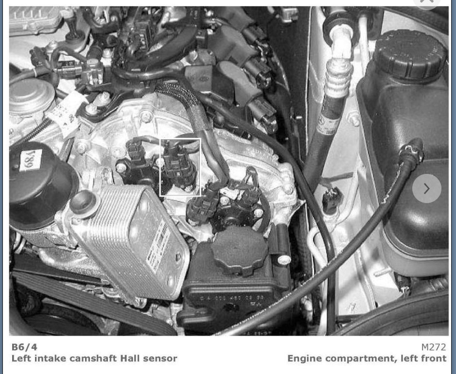

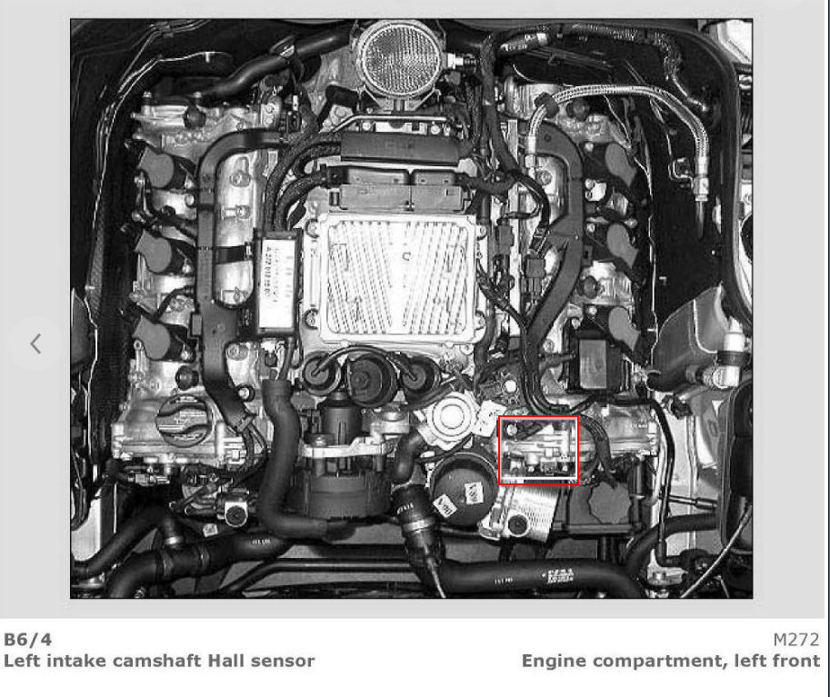

Sir, the last two pictures don't resemble to my car. My car engine is 271.948,Year -2003
VIN:WDBRN40J53A472958
Nov 27, 2019 at 10:59 PM
Okay. Unfortunately, the OEMs don't always take pictures of each specific engine and then show locations for each sensor. As you can imagine this would be a lot of pictures if they took one for each sensor on each engine.
The idea is the same though. Your sensor should be in the similar location even though the engine is different.
Nov 27, 2019 at 11:41 PM

Okay. The P0301 is just a misfire so we need too chase that down after the cam issue is resolved. There is a chance that this gets solved with the cam sensor however I doubt it.
As for the cam sensor codes, the only option is to run through the testing that I provided before. Unfortunately it could be the sensor but it could also be the wiring or control module so we don't want to guess.
