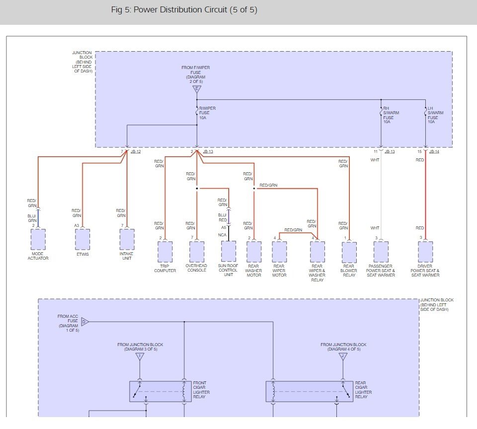

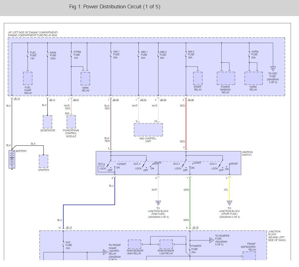

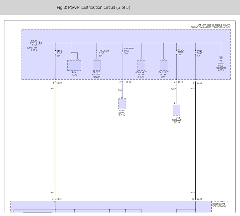

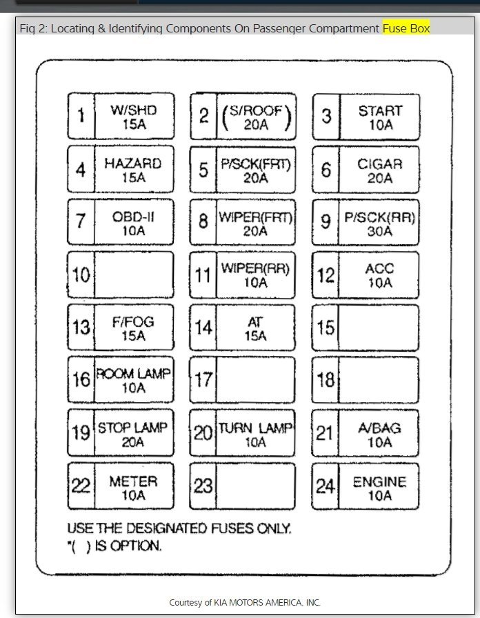

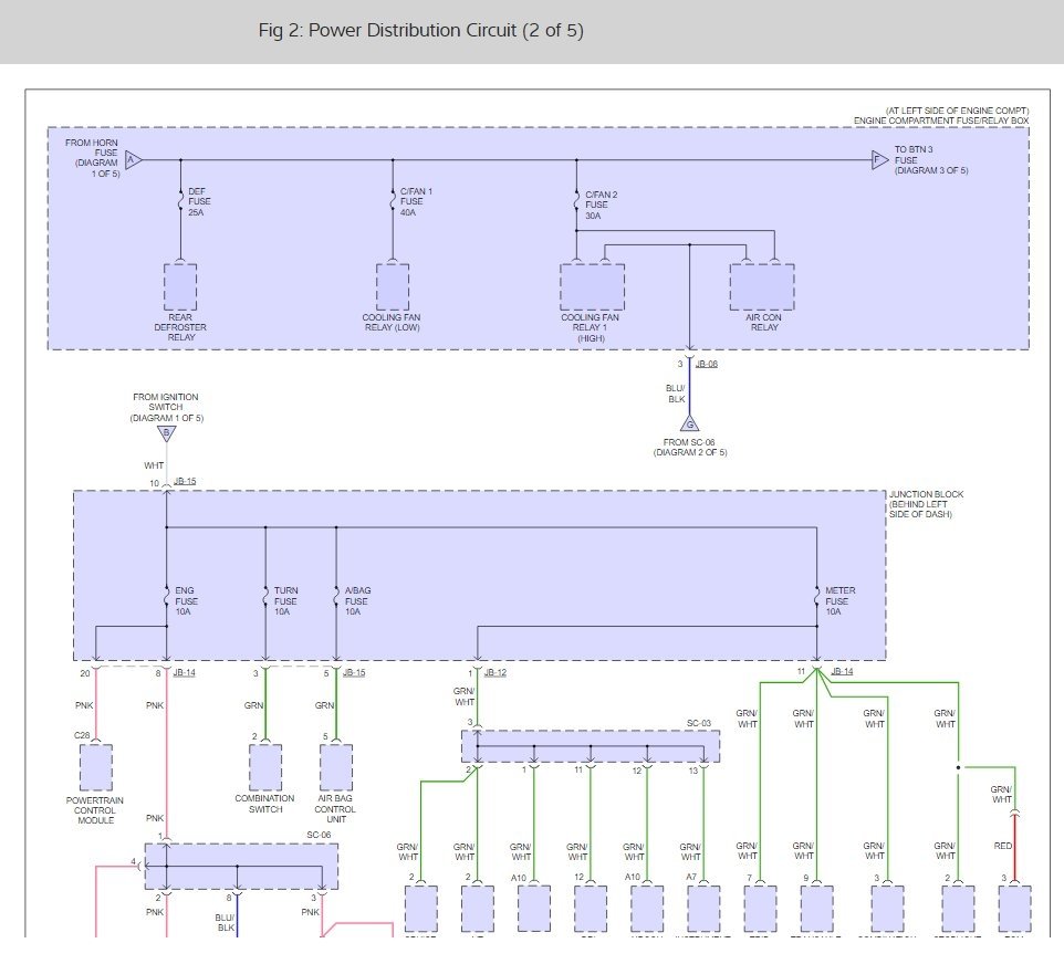

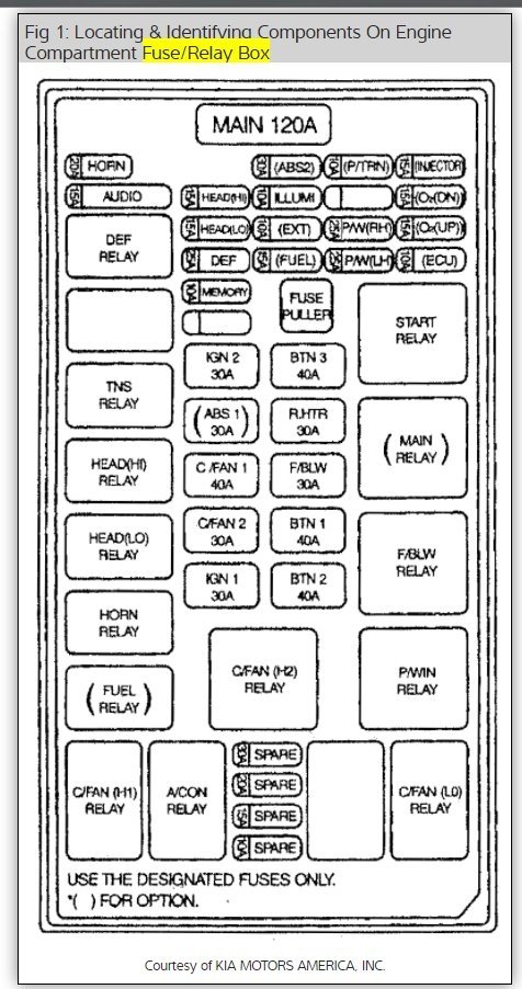

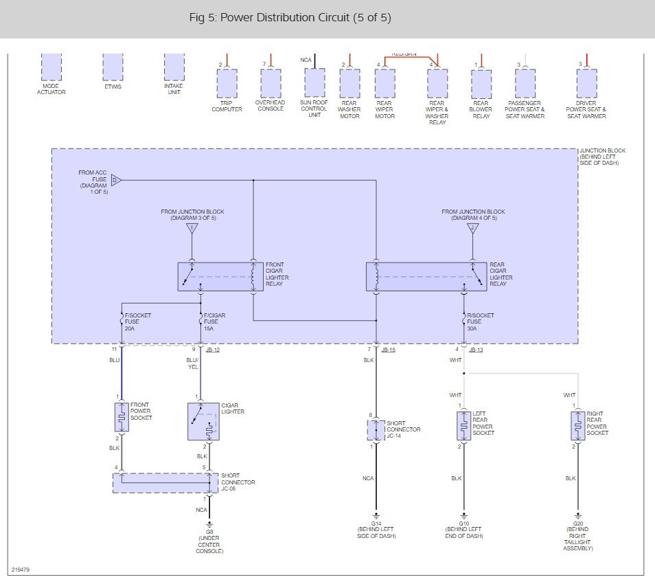

my dash board lights (speedometer,etc..) do not light up. I have no front defrost/heater, and taillights do not work (brake lights work).
Jul 12, 2017 at 2:05 AM
Experienced Mechanic
55,604 POSTS

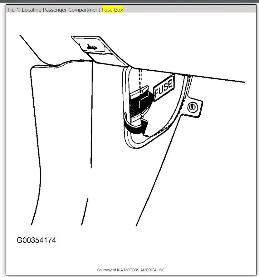

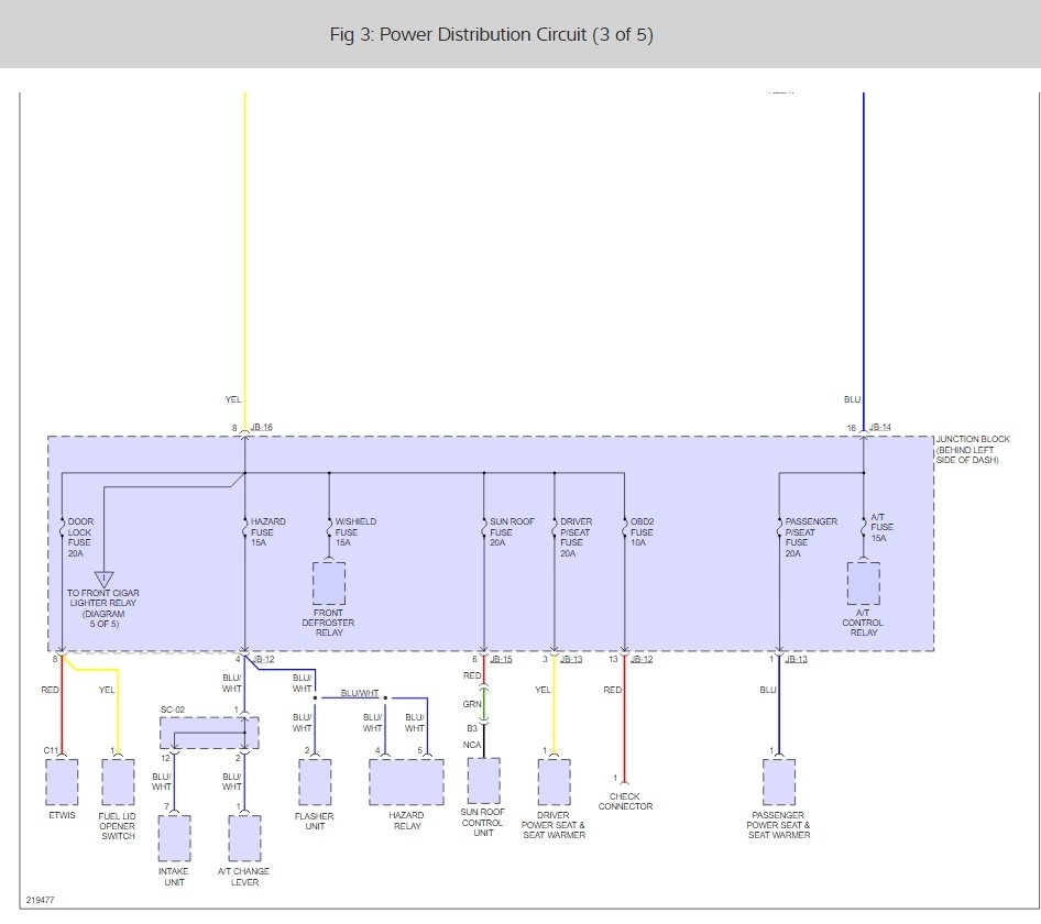

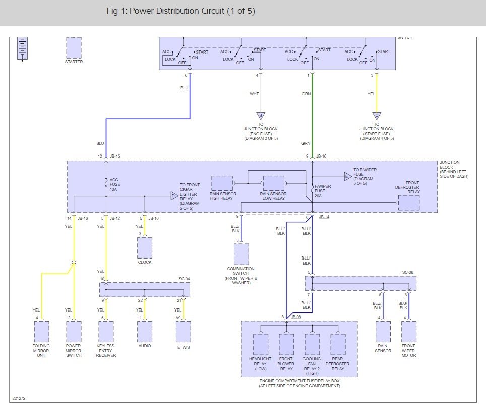

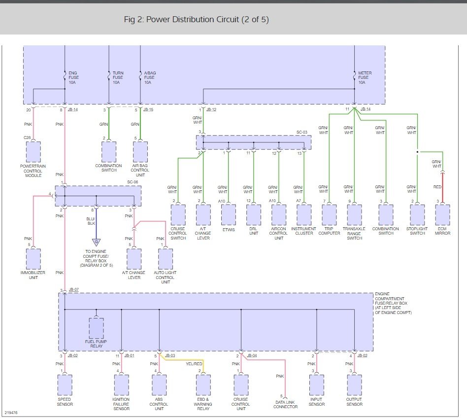

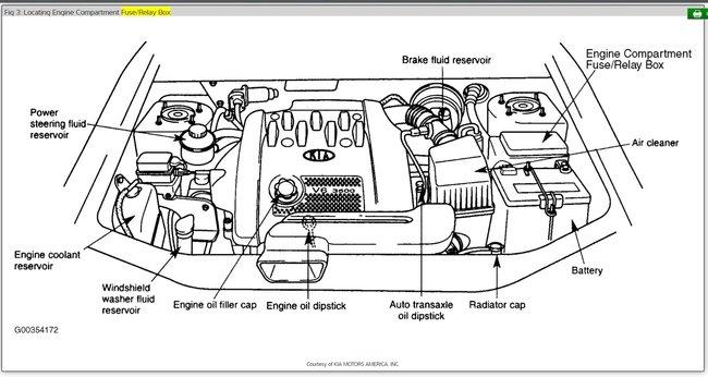

It look like you have a 10 amp Meter fuse that has blown. Here is its location, wiring diagrams (below) and how to change the fuse.
and
Please run this test and get back to us we are interested to see what it is.
