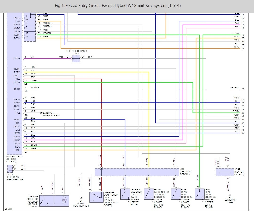

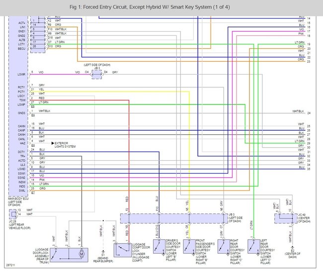

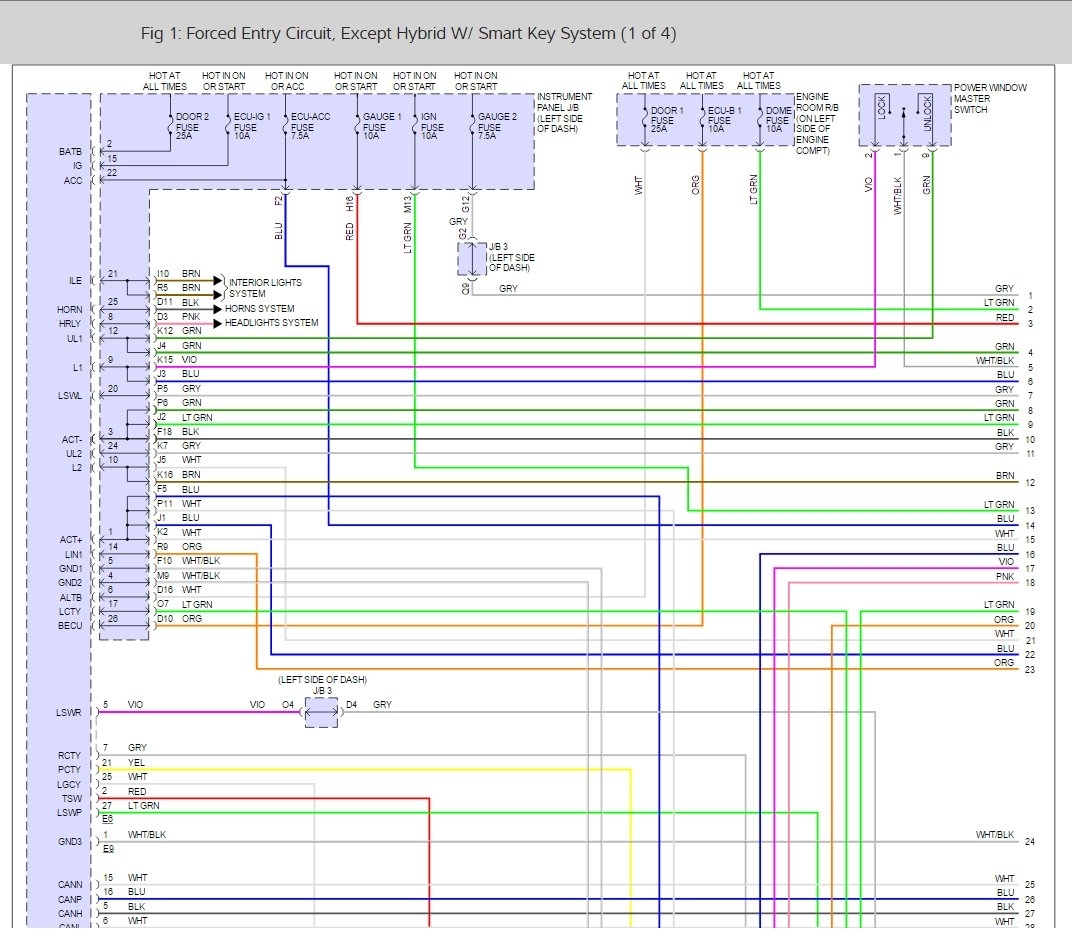

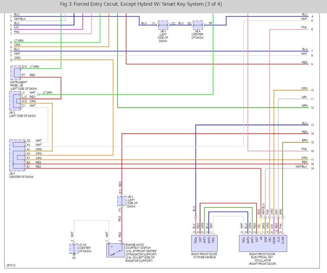

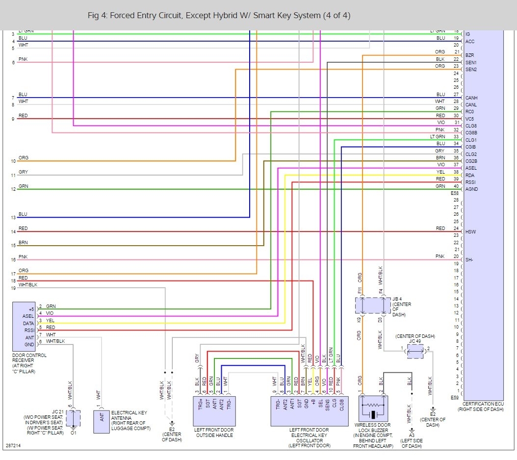

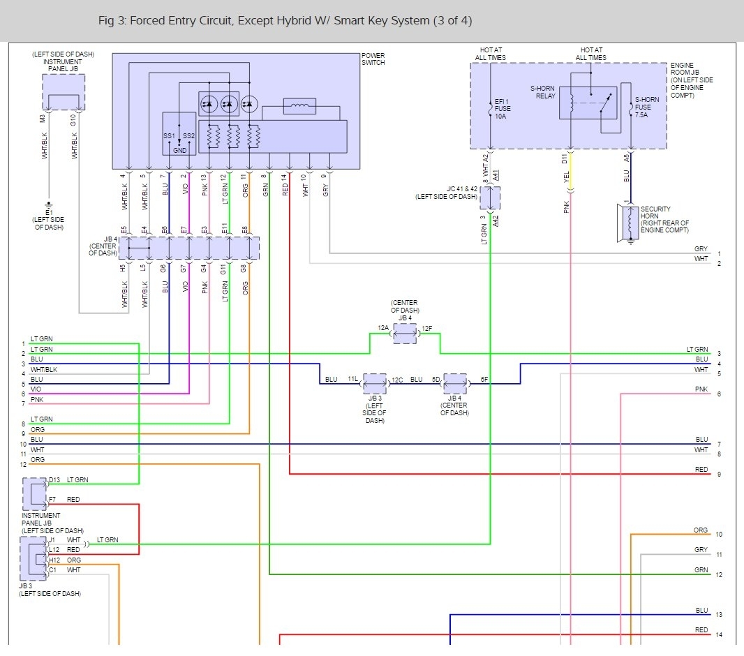

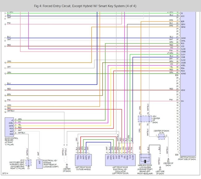

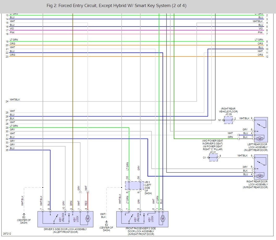

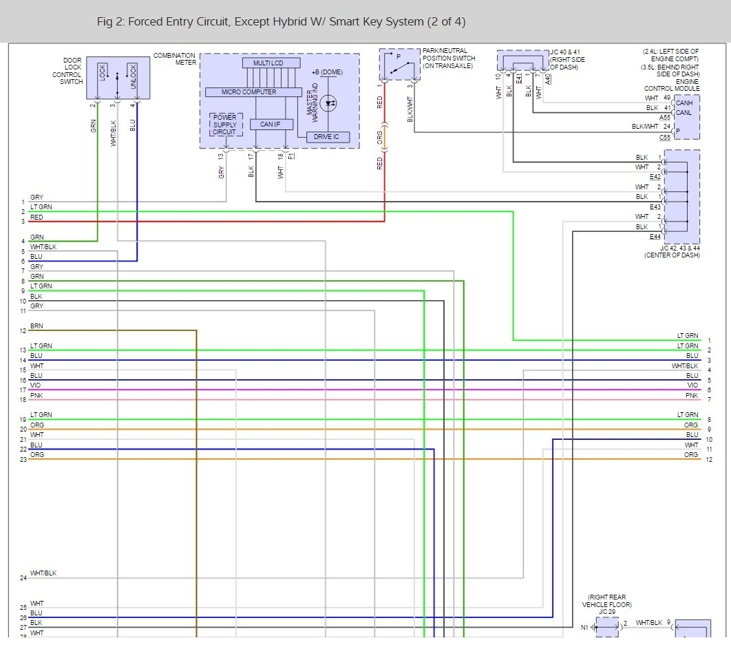

my car is Toyota Mark X push to start, it dash board is off but can only show a security key light flashing and can supply power to the diagnosis plug neither switch on the dash board.
Apr 1, 2017 at 2:53 AM
  • 55,728 POSTS

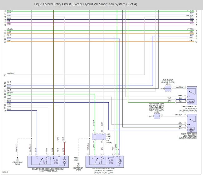

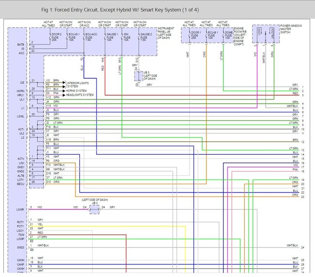

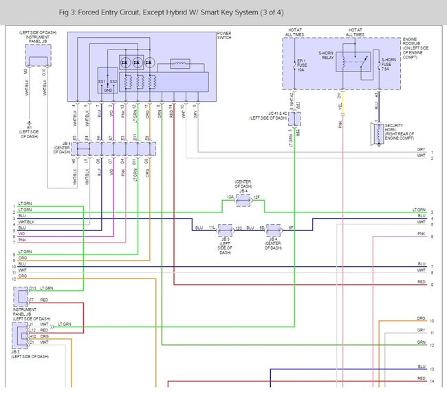

There are many fuses that run this system. Please check them all, here is the wiring diagrams and a guide to get you started, make sure all wiring connectors are plugged in as well.
and
Please run some tests and get back to us so we can continue helping you.
Best, Ken
